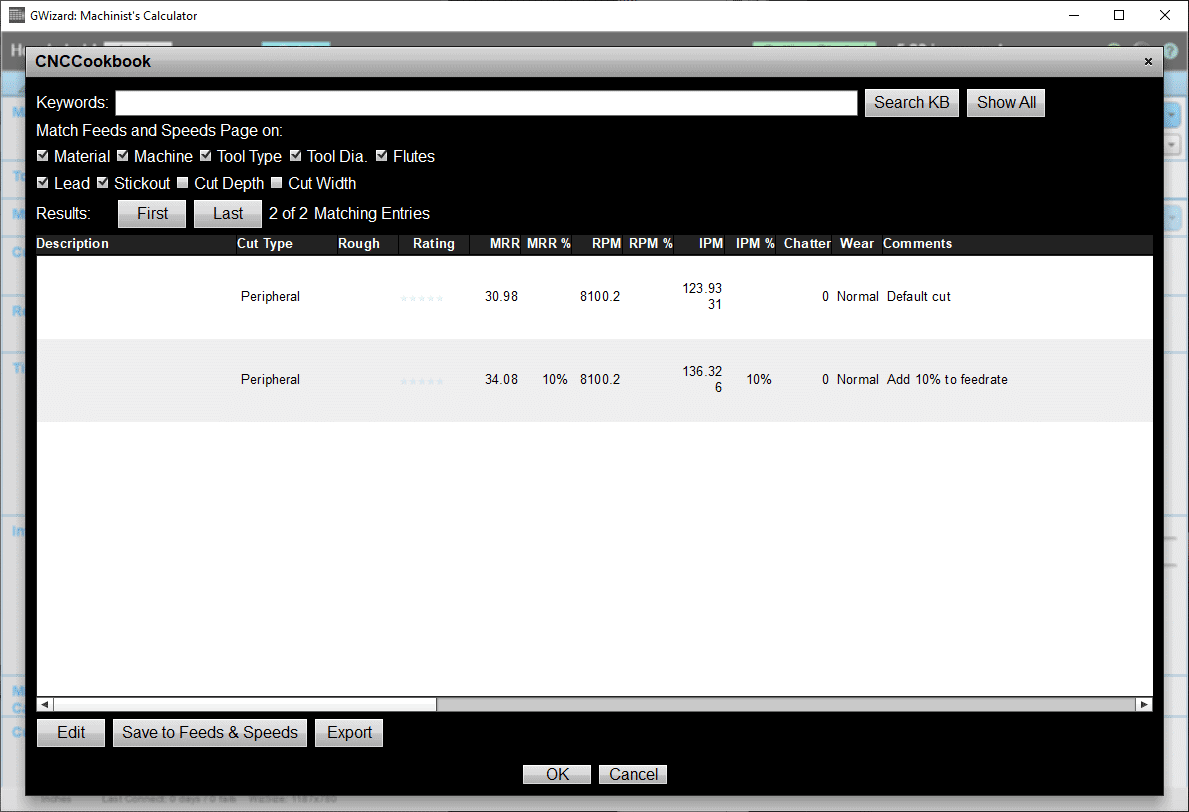

Adding a Cut KB to the G-Wizard Machinist’s Calculator makes perfect sense. Here is a screen shot of the Cut KB Search function:
Search screen for the G-Wizard Cut KB…
What you’re looking at there is the search screen for the Cut KB. You’d use it by entering one or more keywords at the top and pressing the “Search KB” button to the right. I’ve dummied up some results are similar to what you might see if you went searching for finish cuts with a 1/2 inch 4 flute endmill in 6061 Aluminum. Imagine you’d done that search and you’re now looking at the results in the screen shot.
They’re ranked by the star rating you gave (1-5 stars) when you saved each cut. You can click on any column to change the order, but in this case, the star rankings correspond pretty well to the MRR (Material Removal Rate) values. Looks like the experiments involved cranking up the chip load, and according to this you can run 10% more than G-Wizard’s default without a problem.
Are you starting to see how this might work?
So how do you go about building up your Cut KB with data? The answer is you do experiments. Say you’re about to make a cut. After entering the general parameters in G-Wizard, perform a search for similar cuts in your Cut KB.
Let’s say nothing comes back. So, go ahead and record G-Wizard’s result and give it a rating of 2 or 3 stars. G-Wizard uses either manufacturer’s tool data or its own data, which is derived from manufacturer’s data. You can nearly always do better, but you have to know how far to push the envelope. Now ask yourself whether you can afford to do an experiment with this cut. If so, try kicking it up a notch. It’s better to experiment with chip loads than surface speed at first. Even a little too much surface speed greatly increases tool wear, but it’s hard to see the effects of that in a single experiment. Unless you increase surface speed a lot, you likely won’t wear the tool out on the one job.
How much should you kick it up? Well, are you feeling lucky? Have you done any experiments? The further you get form the baseline recommendations, the more cautious you should be. If you’re just starting out, try adding 20 or even 25% above what G-Wizard recommends. If you’ve tried this a couple of times, start scaling back. Maybe a 10% increase, and then maybe 5% or so. Eventually you will find the limit. It happens when you break or chip a cutter, or when your surface finish has become unacceptable.
There are a host of other things that can happen too, such as chatter. The Cut KB is an ideal way to control chatter, but that’s the subject of another post. The experiments are pretty easy. You could pump them into your CAM program, or you could just crank the feedrate override knob on your controller. The important thing is that you record all the parameters and put them somewhere they’ll do you some good–like the G-Wizard Cut KB.
