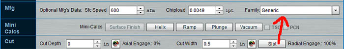

To accomplish that, we added the notion of “Tooling Families” to G-Wizard.  Here’s the new Manufacturer’s Data area in the latest versions of G-Wizard:
Manufacturer's Data Tool Families
New Tool Family selector in the Mfg’s Data area…
There’s a new Tool Family selector in the Mfg’s Data area.  By default it’s set to “Generic”, which causes everything to operate just as G-Wizard has.  But, if you click the dropdown arrow, you get the Tool Family popup:

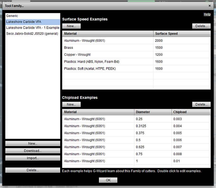

The Tool Family popup selects the family on the left, and on the right you get what we’re calling Feeds and Speeds “Examples.”  The Examples are the Machine Learning aspect of the feature.  You can enter as much data as you like, and G-Wizard learns how to compute better and better Feeds and Speeds from that data.  Best of all, the examples are saved as Preferences, so you don’t have to keep re-entering them.
There are two kinds of examples:
  • Surface Speed Examples:  You provide a material and a surface speed for each example.
  • Chipload Examples:  You provide material, tool diameter, and chip load for each example.

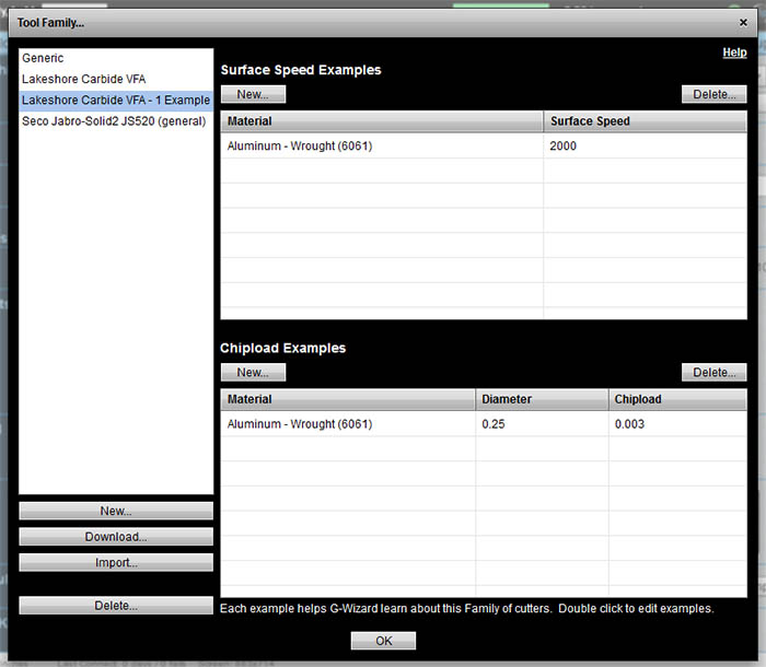

The screen shot shows a fairly complete profile for the Lakeshore Carbide VFA Variable Flute for Aluminum series.  Here’s an example of the same end mill but with only 1 example:
Feeds and Speeds Machine Learning
Machine Learning from 1 Feeds and Speeds Example…
In this case, we have one Surface Speed and one Chipload Example.
So what’s the difference between the two?  How far can G-Wizard go with fewer examples?
The Machine Learning algorithms give G-Wizard the ability to learn, but it can only learn so much.  For example, it’s not going to try to extrapolate the learning to new materials.  If you have only provided examples in Aluminum, it’s not going to try extrapolate that to Tool Steel or Stainless Steel.  There are just too many differences, and in fact, many times, manufacturers will direct you to different tooling lines for different materials.
So, you’ll need to have at least one Surface Speed Example and one Chipload Example for any material you want to work with.
What about the Chipload Examples?
Here, G-Wizard works with the available Examples and its own notion of a default cutter.  As mentioned, it needs some Examples with the same material.
Ideally, it finds Examples that bracket the diameter of the cutter you need Feeds and Speeds for.  Failing that, it needs to extrapolate using the default numbers together with whatever Examples are available.  If the Examples are too different from the desired cutter, they will have very minimal input to the Feeds and Speeds.  If they’re nearby, they may totally control the calculation.  In other words, the Examples are teaching G-Wizard how to optimize a broader and broader array of cutters for best Feeds and Speeds.
Think about Examples like this–use them as you need them.  Use them on demand.  In other words, if you start a new material, enter an Example for that material–both Surface Speed and Chipload.  If you’ve got an Example or two for the material, and you aren’t getting as much juice to the Feeds and Speeds as you’d like, add a Chipload Example for the particular cutter you’re using.  This keeps the effort to a minimum while maximizing results.
