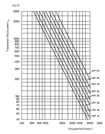

With that in mind, we’re still left wondering what the right ballscrew diameter is. Fortunately, the ballscrew vendors provide help in their catalogs to figure this out. What you want to do is search for the term “critical speed”, which is the speed at which the ballscrew begins to whip. Ballscrew sellers offer charts and formulas such as this pdf booklet from EMC to help you figure these things out. Here’s a typical critical speed graph (actually a nomograph) from that booklet:
Critical Speed for Ballscrews…
Each diagonal line represents a different ballscrew with a different diameter. The X axis is the unsupported length and the Y axis shows the rpm of the critical speed. Once you know how many rpm you need to achieve your desired travel speeds (factoring in any pulley ratios and the ballscrew lead, of course), you can use a chart like this along with the maximum unsupported length of your ballscrew to determine what diameter is needed to prevent whipping.

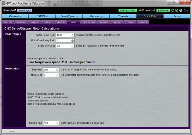

Speaking of knowing the rpm, how do we figure all that out and get to know what ballscrew lead works for our machine design? The lead is a measure of how far the ballnut moves in one revolution of the ballscrew, BTW.
It turns out that G-Wizard Calculator has a handy little calculator in it to help with this problem:
We can back into our ballscrew lead and other info with a little help from G-Wizard Calculator…
What we’d like to do is ensure our motor driving the axis is at peak torque when it is moving the axis at peak speed. That’s because the motor will be working hardest at that point and we don’t want it to poop out early before we get to peak speed. So, we enter the motor’s torque peak rpm first. If you’ve got a spec, use it, if not GWC says to try 2000 rpm for steppers and 3000 for servos. Next comes a bit of fiddling around. We need to arrive at a drive pulley ratio and a leadscrew lead that allow us to hit the axis speed we want and still have the resolution or positioning accuracy we need. It does us no good to get a pairing of pulley and lead that gives us 200 IPM of rapids speed by only has 0.010″ of resolution–that’s way too inaccurate for a CNC mill.
Note that leadscrew leads will be limited to the choices available from your supplier–they don’t come in an infinite variety. Same with the drive pulley ratios unless you plan to make your own drive pulleys.
To continue designing, after you’ve entered the motor torque peak, I would next fill out the Steps/Rev and Microsteps fields. The hints make it pretty obvious what to do there. The screen shot is showing a stepper motor example. Having done that, you’re ready to play with different combinations of pulley ratios and leadscrew leads to see what can be achieved. The example of the screen shot is actually not too bad. 200 IPM is very decent on a hobby class machine, even exceptional. A resolution of 0.0005″ means we can like count on accuracy of perhaps 2x that, so we’ll be good to 0.001″–again, very decent on a hobby class machine.
You won’t have to play with this long to decide that the faster you want to go and maintain resolution, the harder it is to do so. Pretty soon you need servos because steppers just don’t go fast enough and still support the resolution. Some things to keep in mind:
– Don’t become too reliant on microsteps for accuracy because they don’t have much torque compared to a full step.
– The figure of steps per second at max torque speed may be higher than your control electronics will support. They all have a higher end limit, so keep that in mind too.

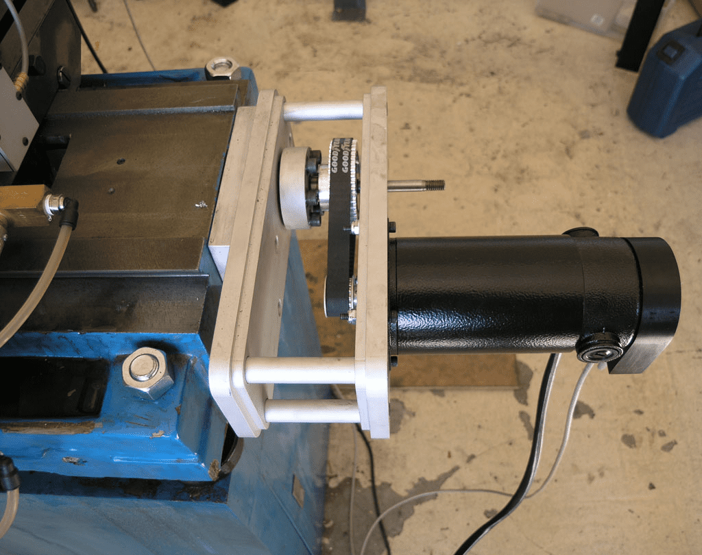

From the calculations above, you’ll know if you need drive pulleys or if direct drive will suffice. For most applications, you’ll want the drive pulleys. Be sure to use the toothed cog belts lest the drive pulley be another source of backlash!

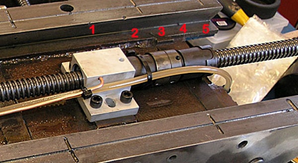

The idea behind double ballnuts is to put a strong spring between the two nuts, typically a Belleville-style disc spring, that exerts a lot of force spreading the two ballnuts apart. Doing so takes out the backlash “slack” in both directions and works extremely well. The downside is you have the cost, complexity, and extra size of double ballnuts. My IH mill uses double nuts and I was able to get my backlash down into the tenths as a result. Here is the ballnut assembly from my mill:
Ballnut assembly, numbers denote the different parts of the assembly…
The numbers denote the different parts of the assembly:
1. This is an aluminum mount that attaches the ballnut, which threads into it, to the saddle, which it is bolted to with 4 socket head cap screws. Make your mounting beefy and solid as any flex will show up as backlash. Also note the piece of copper tubing that goes into the mount. This tubing carries way oil to lubricate the ballscrew and ballnuts.
2. This is one of the two ballnuts, and this one is threaded into the aluminum mount #1.
3. This is the coupling that holds the disc springs that push the two ballnuts apart. The second ballnut threads into it and it, in turn, is clamped on the other end to the first ballnut.
4. The second ballnut.
5. This is a wiper. It’s just a set of brush bristles that knock any chips off the ballscrew before they get inside the ballnuts.

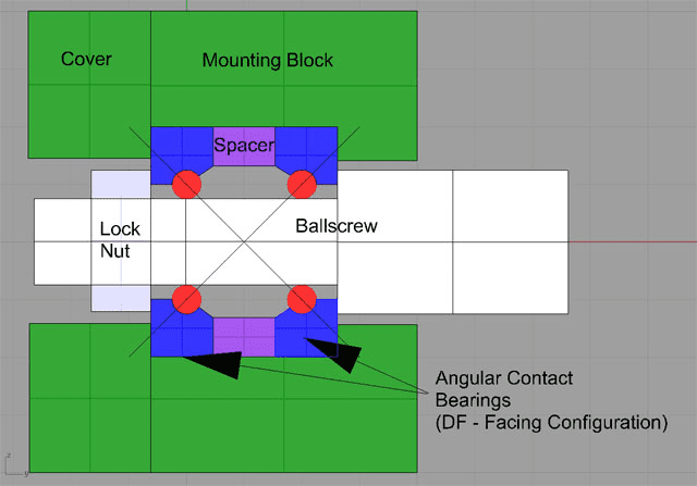

A typical ballnut mounting was described above. The ballscrew is held by a combination of the ballnut and ball bearing mounts at one or both ends of the ballscrew. It does us no good to engineer a superb anti-backlash ballnut if the mounting of the ballscrew ends is so sloppy that the screw can move around along its axis. The latter is just another source of backlash. The answer in commercial VMC’s is to use high quality angular contact bearings arranged something like this:
Putting the angular contact bearings back to back like that causes them to resist any motion of the ballscrew along its axis while allowing it to spin freely. You can see from the diagram that you’ll need to machine the end of your ballscrew for such a mounting. You need a nicely machined diameter of the correct size for your bearing OD’s and then the end must be machined to take a lock nut that will tension the shoulder of the ballscrew against the bearings. The drawing isn’t detailed enough to show it, but the ballscrew shoulder and nut ride only on the inner bearing race so that it can spin freely.
Like preloaded dual ballnuts, you can buy ballscrew mounts or make them. If you’re new to machining, I’d suggest buying them. They’re not that expensive and they’ll save you some trouble on a precision part. If you plan to make one, you can read all about the fancy bearing types that are purpose made for this kind of thing. Just keep in mind, for most hobby class CNC conversions, almost any angular contact bearings will do. Forget all the fancy extra preload, precision, and cost. Those cheaper angular contact bearings still won’t be the weak link.
The other thing the schematic doesn’t show very well is the ballscrew end needs to extend far enough for a drive pulley or coupler for a direct drive arrangement. Here’s the pulley drive for one of the axes on my IH mill:
That cylindrical cover held on with all the socket head capscrews houses the bearings that hold the ballscrew…
