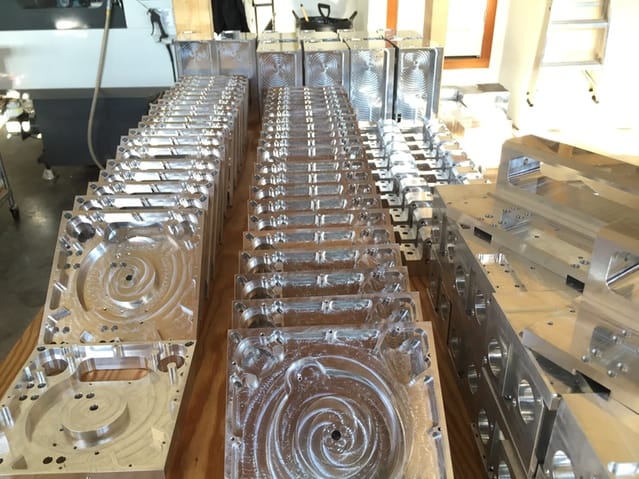

With linear rails, a sweet high speed spindle, and trunion table, the Pocket NC looks the part. It’s even set up as a horizontal mill, which no doubt gives it greater rigidity than might otherwise be the case. 280 backers pledged $355,833 on Kickstarter to help bring this project to life. The Kickstarter closed just a couple of weeks ago, so it’s way too early to tell much, but this mill looks extremely promising. Early signs are good as the Kickstarter sold out 3 weeks early and this enabled them to get a head start making parts for the machines:
Parts to assemble Pocket NC’s are stacking up…
With two machinists, a mechanical engineer, and a software guy, it’s no wonder the machine looks so good. Their attention to detail really shows. Here’s a shot of the machine in action machining what turns out to be a gorgeous little aluminum engine block:
