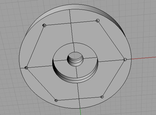

For my first CAD software, I purchased a copy of Rhino 3D version 3 and found it to be straightforward. I started with the trial version which is limited to 25 saves or some such. I ran through their two basic tutorials in the trial version, and when I got my official copy, I was able to whip out the chuck backplate 3 views in about an hour. I figured this was not too bad all things considered!
Today I could probably do the job in 10 minutes given that I’m a lot more familiar with Rhino3D.
Getting ready to “subtract out” the holes
on the backplate…
I use hexagons or other polygons to lay out bolt
circles…

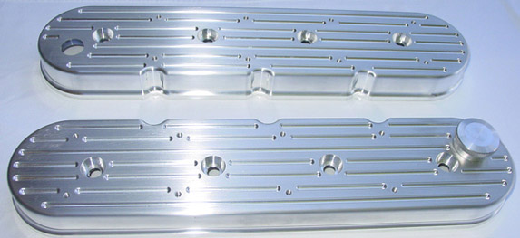

Valve Covers…

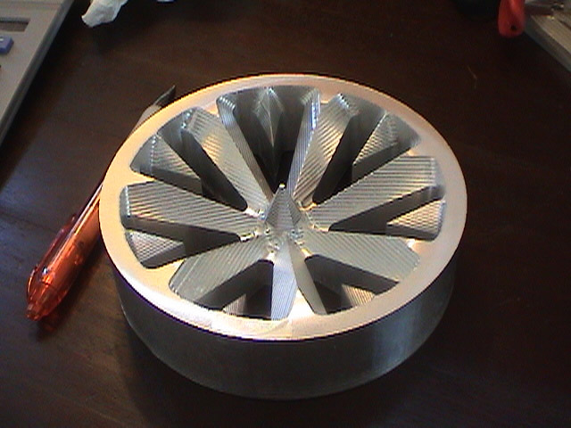

Bling bling wheel for a kid’s wagon…

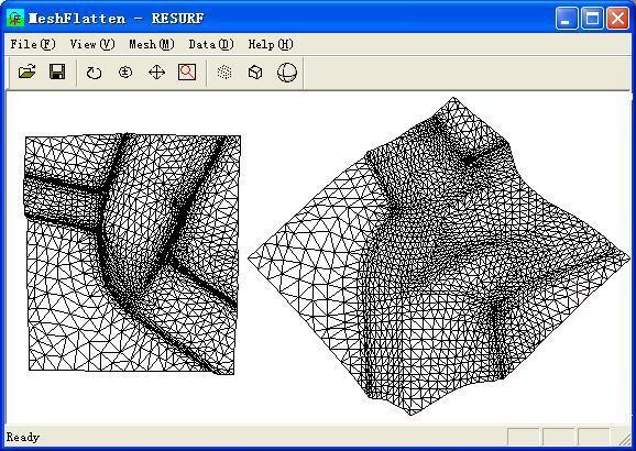

An STL mesh from MeshFlatten software…
There’s not necessarily anything wrong with this, except that you have to be aware of it. Your CAD and CAM software will allow you to specify the tolerances–how closely must the mesh match the idealized 3D part? With a small enough tolerance, the facets will disappear. The flip side is unless your CAM software is pretty clever, you’ll be forcing your machine to make hundreds or even thousands of tiny little straightline moves for those facets.
