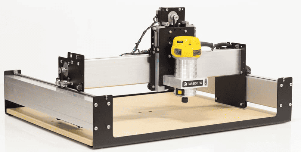

A black and silver metal frame with a wooden base, containing a yellow power tool, on a white background.
GRBL is open-source software that translates G-codes into motor movements for precise control in CNC machines, ensuring accurate operation and flawless execution of your designs. The process starts with CAD software, which reads the design, and then CAM software converts it into G-codes. These G-codes are the lifeblood of your CNC machine, controlling everything from the laser module to the cutting and engraving processes.
While GRBL is a powerful tool, it does have its limitations, such as controlling a maximum of 3 axes and requiring specific Arduino pins for proper functioning. However, its compatibility with Arduino boards makes it a popular choice for many CNC enthusiasts. From milling to metal engraving, GRBL plays a crucial role in bringing your CNC projects to life.

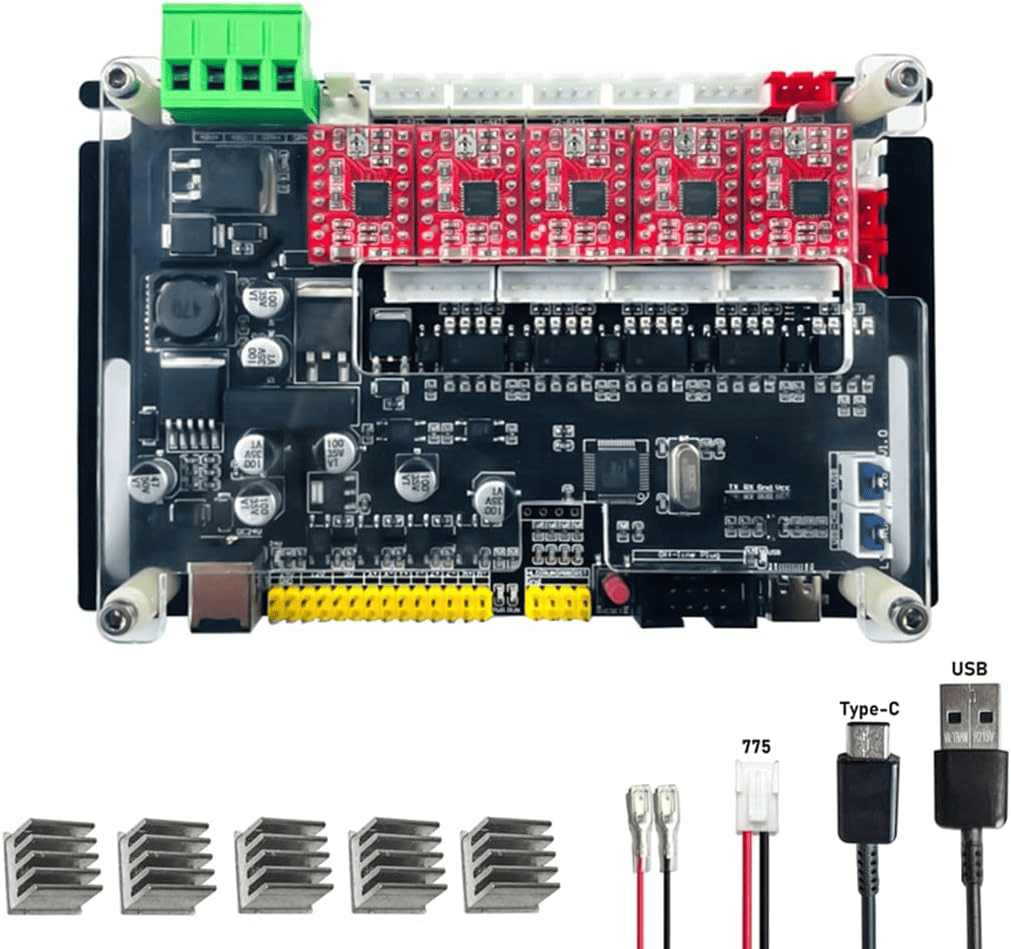

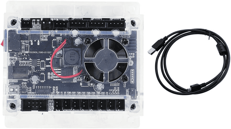

You can also purchase boards that are all set of with GRBL, eliminating the need to configure a blank Arduino board.  Here is a typical 4-axis GRBL board available on Amazon:
Electronic circuit board with green, red, silver, and white components.
GRBL Controller Board available on Amazon for about $59,,,

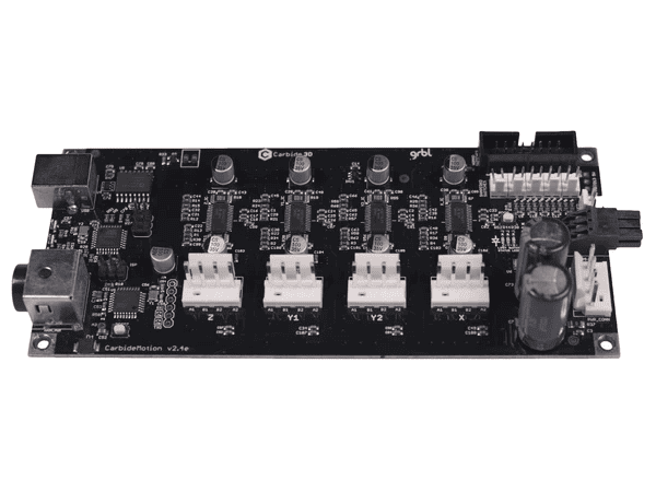

A rectangular black circuit board with various components and wires on a white background.
Shapeoko GRBL controller board...
The right hardware is essential for optimal performance and precision in your CNC machine. Stepper motors, motor drivers, and Arduino CNC shields are the key components that work together to bring your designs to life. Each component plays a crucial role in the overall operation of your CNC machine, and selecting the right hardware ensures your machine runs efficiently and accurately.
Understanding the role of each component and its compatibility with GRBL and Arduino boards is essential in building a CNC machine that meets your specific needs. From the power of the stepper motors to the features of the Arduino CNC shield, careful consideration of each component will help you create a CNC machine that is both reliable and precise.

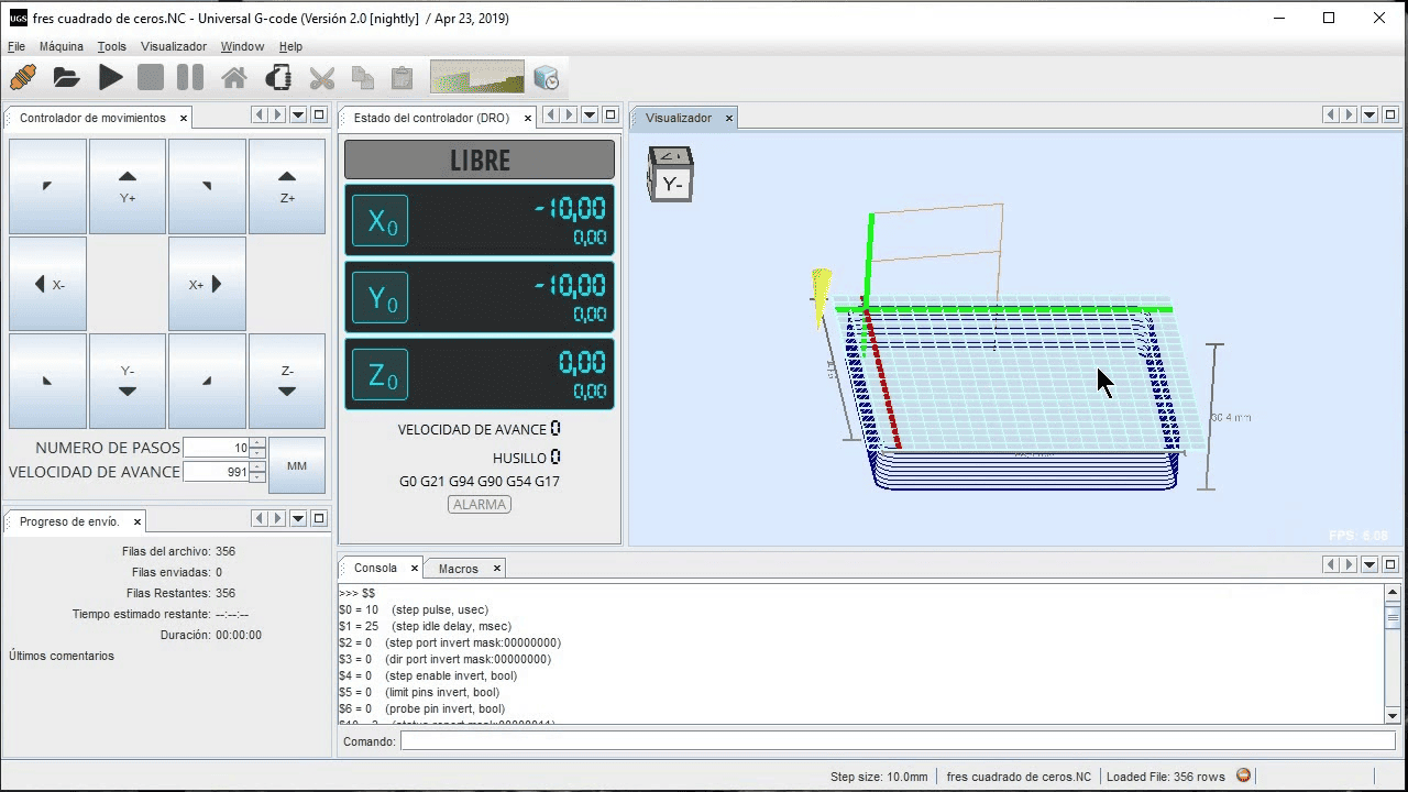

GRBL controller software, such as Universal G-code Sender (UGS), allows you to configure and control your CNC machine with ease and precision. This software provides a user-friendly interface for managing your CNC machine and adjusting the GRBL settings, ensuring optimal performance and accuracy in your projects.
From setting up your CNC machine to troubleshooting common GRBL issues, GRBL controller software is a valuable tool for any CNC enthusiast. Universal G-code Sender (UGS) is a popular choice for configuring and controlling CNC machines with GRBL. It offers advanced features like adjusting the steps/mm parameter and motor direction, making it an essential tool for fine-tuning your CNC machine’s performance.
With UGS, you can effortlessly manage your CNC machine and ensure it operates at its full potential.
Configuring and Controlling CNC Machine with UGS
A black circuit board with a fan, components, and a red wire, on a white background.
Setting up and controlling your CNC machine with Universal G-code Sender is a simple process. To adjust the steps/mm parameter, click the move “x+” button, measure the actual movement of the machine with a ruler, and enter the corresponding value in the “Actual movement” field. The UGS Setup Wizard will then calculate and suggest a new value for the steps/mm parameter.
To verify and adjust the direction of motor movement, select the direction of moving of the motors in the wizard and reverse it if required, or manually flip the connection of the motor on the Arduino CNC Shield. The default value for the steps/mm parameter in the UGS Setup Wizard is 250 steps/mm, and the recommended baud rate is 115200.

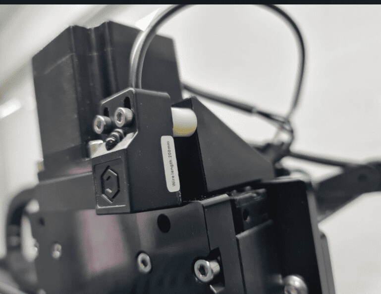

Soft Limit Alarms
Black metal object with hexagonal nut and illegible text stickers.
Shapeoko's Z-Axis soft limit alarm sensor...
Soft limit alarms are errors that arise when the CNC machine mistakenly interprets the position of the tool to be at the limiting value, despite it being within the operational area of the machine. These errors can be attributed to a range of causes, such as limit switches, mechanical issues, or configuration difficulties.
To resolve soft limit alarms, manually reset the machine to the origin by moving the router to the origin coordinates (0,0,0) and initiating a GRBL system restart. This will help you avoid potential damage to your machine and maintain the accuracy and precision of your projects.
