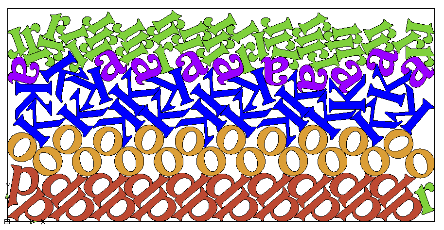

They say a picture is worth a thousand words, so here is a picture of what Nesting Software can do:
Nesting pattern created by NestProfessor…
I chose that sample just because it shows familiar shapes (letters) in an unfamiliar configuration. Imagine software that takes arbitrary outline shapes, and then rotates and positions them to maximize the number of those shapes that can be cut from the flat material. You can see pretty quickly this is an application you want to let the computer’s raw CPU horsepower chew on and not something you’d want to have to do by hand.

Once you’ve given the software enough information and hit the “Go” button, it starts trying to find the best nesting for your parts. Each time it finds a better solution, it’ll flash up a new nesting layout sheet (similar to what’s shown above with the letters). It will also give you some statistics like the total length and width needed, or the Utilization. Nesting Utilization is a measure of how much material is used by part and how much is waste. The higher the Utilization, the more the nesting software is saving you in wasted material. Good nesting software will put parts inside the cavities of other parts, rotate parts to arbitrary angles, and do all sorts of things to maximize the Utilization.
