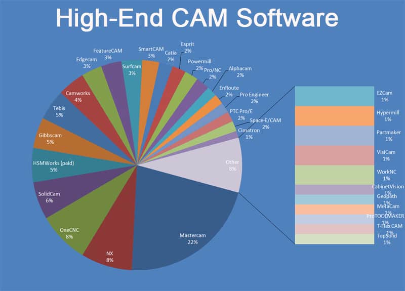

High-End CAM Software Market Shares
High-End CAM Software…
The High-End CAM Software markets remains crowded, fragmented, and somewhat confusing. There are a lot of packages in this market, and despite the emergence of some predictions about shakouts and consolidations in the form of Autodesk buying HSMWorks and Delcam, it’s hard to see much consolidation from these survey results. CAM software is an expensive investment, difficult to learn to get the most out of, and absolutely critical for most manufacturers. They will think long and hard about switching.
Here are some highlights versus the 2012 survey results:
– This was our most popular category, and we received 190 responses on the high-end packages.
– Mastercam remains the biggest, but like the shift from 2010-2012, they lost more share. They were at 29% in 2010, 27% in 2012, and have fallen to 22% in 2014.
– Big surprises in the tier right below Mastercam. In 2012, it was occupied by Solidcam, HSMWorks, and OneCNC. This year, we see Siemens NX and OneCNC tied to be the #2 players while SolidCam has really fallen back from an 11% share to 6%. HSMWorks is down from 7% to 5% but this likely reflects the fact that this year I broke out Paid versus free HSMWorks, and this is giving us a truer picture of their real High-End share.
– The next tier also shows quite a bit of shuffling. In 2012 we had EdgeCam (7%), GibbsCam (6%), and FeatureCAM (5%). This year HSMWorks has dropped into the top of this tier (replaced by NX), Gibbs stayed about where it was, and Tebis is suddenly here. I’ll be interested to watch how this story unfolds on our next survey. These two tiers are where most of the action that matters for big market shifts happens.
Below that last tier the market becomes extremely fragmented. Most of the players are hanging in there, although it looks like shares are becoming even more diluted and spread thinly. Companies that had decent shares of 5% to 7% like Edgecam and FeatureCAM are now down to 3%. Surfcam has fallen off too. Lower down in the pack, many shares are relatively unchanged.

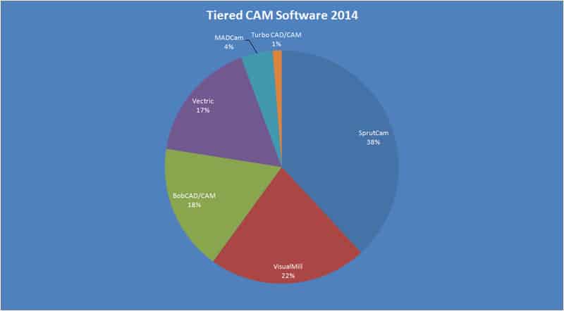

Tier-Priced CAM Software Market Shares
This category consists of companies that have modules that let you build a CAM package at virtually any price point, depending on how much functionality you need. As such, they straddle multiple markets from low-end to high-end.
Tiered CAM Software…
– This was the second most popular category with 160 responses.
– Sprutcam has made big strides since 2012 and has moved from 2nd to 1st place with 38% market share. I suspect Tormach becoming their North American distributor has had a lot to do with that.
– The Mecsoft Visual Mill family comprises a number of excellent CAM products. They have a lot of share, but it seems Sprut heavily stole share from Mecsoft and BobCad.
– Despite announcing a lot of new product innovations, BobCad share has fallen from 25% to 18%.
– Vectric has had a good year, and has moved from 7% up to 17%.
