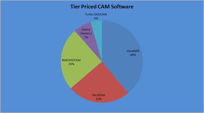

Tier-Priced CAM Software Market Shares
Most CAM packages have multiple modules of one sort or another, but the middle tier is particularly interesting because they span a range from fairly cheap to (in some cases) all the way up with the Higher-end tier.  To be in the Tier-Priced category, the most inexpensive Mill module had to be available for less than $2500.  We have a good group of players here, all familiar names:
Mid-Tier CAM Software Market Shares for 2012Tier Priced CAM Software Market Shares…
Visual Mill is actually all of the Mecsoft products, so it includes Visual Mill, RhinoCAM, and the rest.  It’s a versatile platform that shows the value of being able to embed the offerings into various CAD packages.  Over the course of the last 2 years, we’ve seeing the following market share moves:
– In this category, the Visual Mill products have pulled away from this pack versus where they were in 2010.
– Aspire is way up in this audience, which I suspect is due in part to there being a lot more CNC Router users participating than there were in 2010.
These are all very feature-rich packages and well worth checking out.

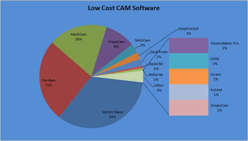

Low Cost CAM Software Market Shares
Here is the breakdown for this group, which had to be under $1000 to participate:
Low Cost CAM Software Market Share for 2012Low Cost CAM Software Market Shares…
There are lots of different low cost CAM packages available at great prices.  Here are changes since the 2010 survey:
– “Vectric Value” refers to Vectric’s VCarve, PhotoVCarve, and Cut2D products.  They’ve grown in share enormously since 2012, and their popularity with CNC router users I think also accounts for a lot of this difference from the 2010 survey.  Our CNC Router audience has grown tremendously in the last 2 years.
–  CamBam still ranking well among the inexpensive products as it did in the 2010 survey after the Tiered products are taken out.  What’s changed is the Vectric value products are all over this category.  If we add them up from 2010, their share has gone from about 1/3 of what CamBam had to now being quite a bit larger.
–  MeshCam is showing huge growth as it had less share than SheetCAM and was at about 1/3 the share of CamBam in 2010.  Robert builds great software and has been a guest poster here a couple of times, so I am not surprised.
–  SheetCam looks to me like it is holding its own.  I haven’t had the pleasure of playing with it, but I know it has a devoted following.
The other programs are jockeying for position with one another, but haven’t really moved significantly in share.
