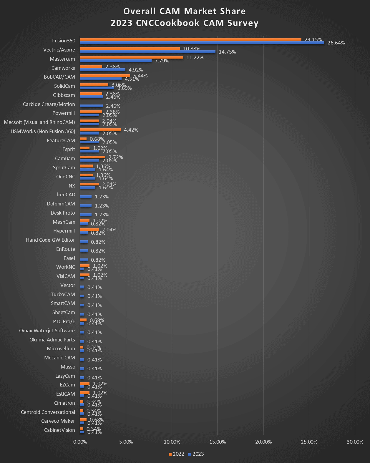

Let’s start by taking a look by category at market share.
Overall CAM Software Market Share
Here is the overall CAM Market Share
The trends are interesting:
- Fusion 360 continues to gain share and is the overall market leader.
- Vectric/Aspire, Camworks, and Solidcam are also continuing to gain share.
- Mastercam, BobCAD, and HSMWorks are all down on share.
So, the market continues to consolidate, but at this point, is still pretty highly fragmented.

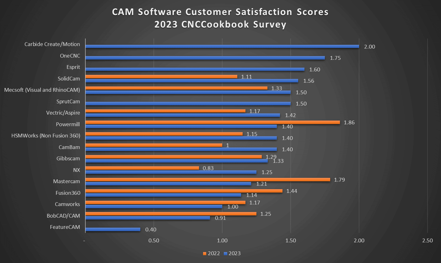

Customer Satisfaction Awards
Which packages did customers love the most? There’s a lot more detail in the eBook (see below), but here are the winners.
First place goes to Carbide Create:
Congratulations to the Carbide Create team! Carbide Create is an excellent solution for beginners. It’s a title little integrated CAD/CAM package that is quite powerful. My friend Jaime (CNC With Jaime) does all of her sign carving with it.
The Silver Customer Satisfaction Award Winner this year is OneCNC:
Congratulations to the OneCNC team!
Customer Satisfaction Award Winners over the Years
We think the customer satisfaction awards are a big deal as they represent actual user’s evaluation of the software. After all, who would know more than actual users who live with a package day after day and use it to do their work?
Here is the roster of Customer Satisfaction Award winners over the years:
CarbideCreate 2023
OneCNC 2023
PowerMill 2021 & 2016
SprutCAM 2020 & 2016
SolidCAM 2018 & 2017
HyperMill 2021
Mastercam 2021
Siemens NX 2020
Gibbscam 2018
CamBam 2018
Surfcam 2017
If you’d like to learn more about the Customer Satisfaction Awards, for example, the scores of all the top packages, refer to our eBook (see below).
Here’s the big chart of all customer satisfaction scores. Note that we only include packages below that had at least 5 responses:

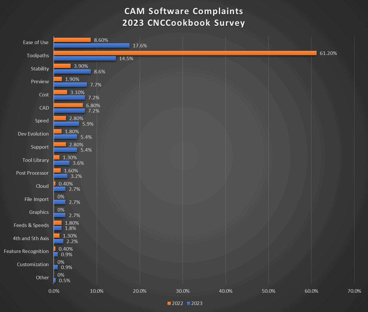

CAM Software Complaints
What causes readers to knock down their Customer Satisfaction Score on these CAM Packages?
Here is a ranking of the most popular CAM Package Complaints:
This year, complaints were way up in most of these areas with the exception that Toolpaths are way down in terms of complaints, though they’re still very high on the list.

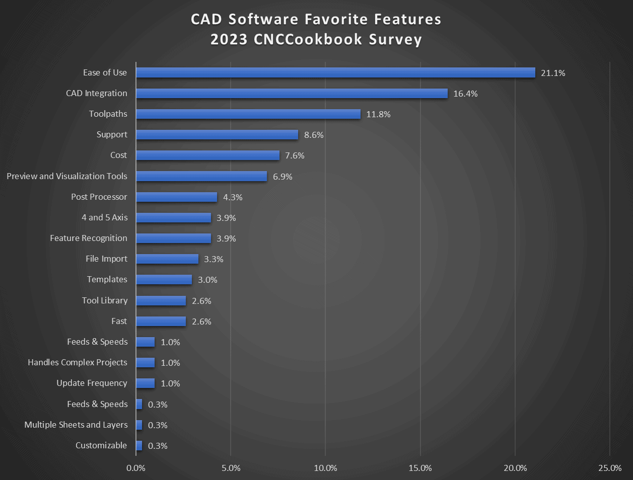

CAM Software Favorite Features
These are the areas that respondents noted in their Top 3 favorite features of their chosen CAM software.

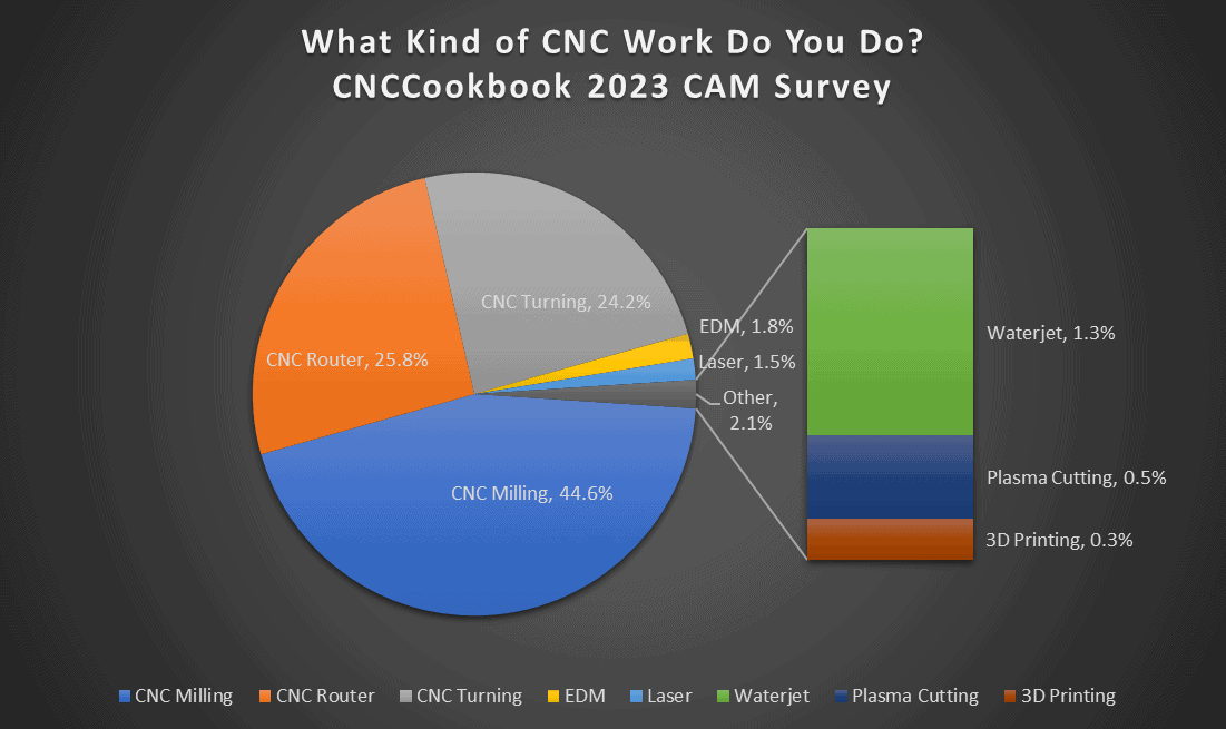

These results are pretty similar to last year with Milling down slightly and Router and Turning work both up slightly.

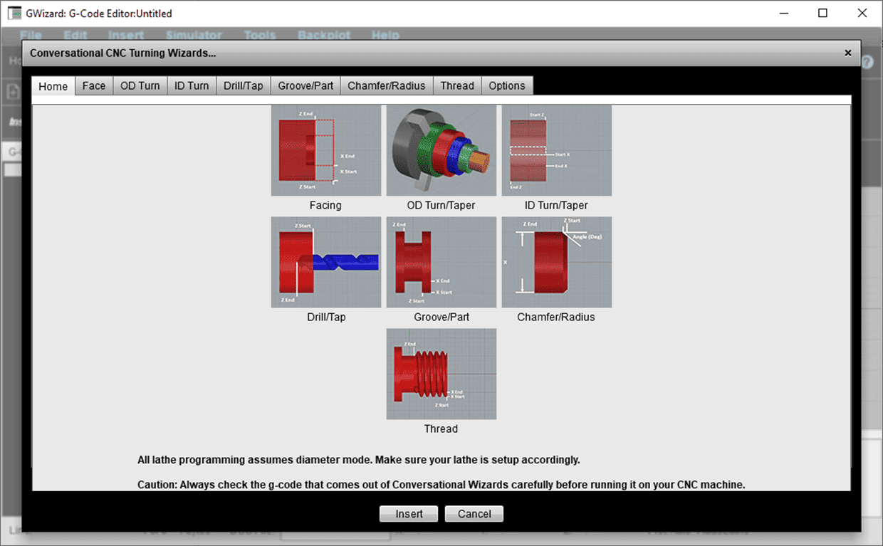

Conversational Programming can be delivered as a stand-alone software package like our G-Wizard Editor or it can be built right into your CNC Control. It can make it a breeze to make simple parts or to add simple features to other parts.
Here’s G-Wizard Editor’s list of Conversational Turning Wizards to give an idea:

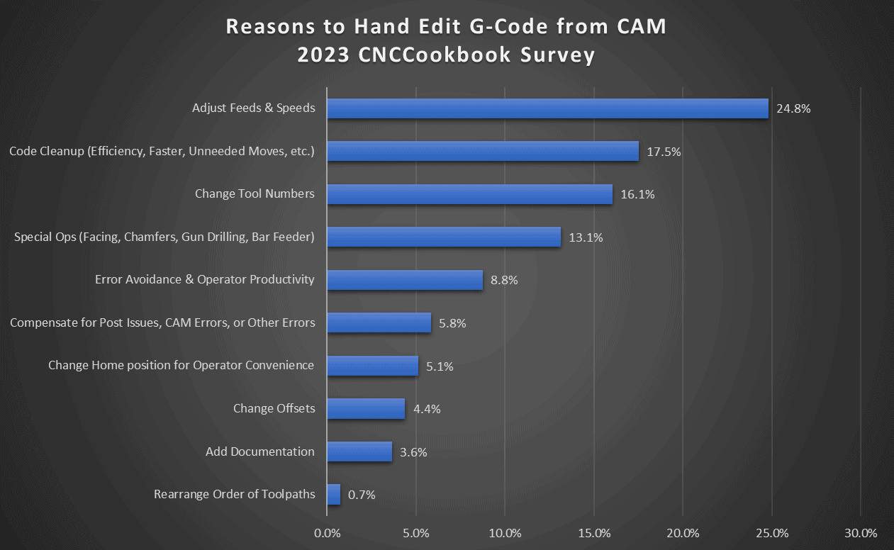

Do you modify your CAM-generated g-code by hand?
Results:
-Frequently: 16.3%, up from 12.2% last year
-Sometimes: 49.78%, down from 54.7% last year
-Never: 33.92% nearly unchanged from last year
Being able to modify your CAM’s g-code can be a powerful tool. If your shop lacks this capability, you’re missing out on a lot of opportunities to improve automation and profitability.
To get an idea what’s possible, check out 37 things your CAM won’t do for you that g-code programming can. It will show you what’s possible with a little g-code programming added to CAM.
Our respondents use this capability to do the following kinds of things:
