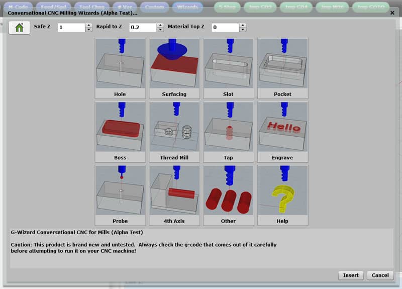

Working Without Drawings for a Quick and Dirty Project, ala Manual Machining
A good manual machinist can accomplish a whole lot without stopping to create a CAD drawing of the part they’re trying to make. They won’t try this on a really complex part, and they may work from a quick back of the envelope sketch, but they can often avoid the overhead and time spent to create a CAD drawing to be productive. This is especially true for lathe work. Many times when the age old argument over whether manual machining can ever be faster than CNC breaks out, one of the major complaints about CNC is this idea that you must always start from a CAD drawing. The reality is that you can use a capability known as “Conversational CNC” to accomplish most anything in CNC that a manual machinist can do without recourse to CAD or CAM.
Conversational CNC is all about selecting a “Wizard” from a group of standard operations:
Conversational CNC starts with selecting from a menu of common operations…
We offer a Conversational CNC capability as an integrated part of our G-Wizard GCode Editor. It’s easy to use and will get you into CNC fast if you’re a manual machinist as well as saving you time for quick and dirty work of various kinds. You may even find that some of the capabilities like the fancy Facing or Deep Hole Drilling Wizards are better than what you CAM offers, and you want to substitute them in place of the equivalent CAM functions.
