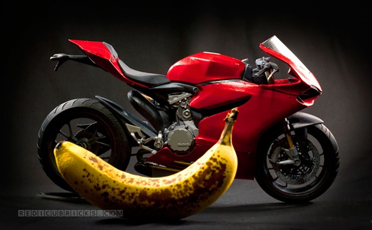

If you’re satisfied with the fairly crude results that come straight off a consumer grade 3D printer, they’re not bad. Miraculous really, when you consider how else you could go about getting such results. But if you have a problem with strings, oozing, visible layering, and the whole host of other things that intrude when you want your 3D printed part to look professional, it’s a problem. What comes off a relatively crude CNC mill usually looks quite a bit better. The work required to get to a final polished (pardon my pun) result is much harder for 3D printing, but still very doable. You only have to look at a couple of super-high quality projects done with consumer grade 3D printers and a lot of post-print clean up to see what’s possible:
Ducatti scale model 3D Printed on Consumer-Grade Ultimaker 3D Printer by Redicubricks: So cool!

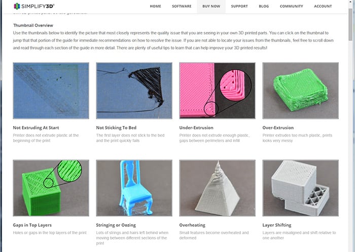

You can try everything from sanding to acetone vapor to various other techniqueshttps://www.cnccookbook.com/2013/10/14/building-40-scale-1927-miller-91-race-car-3d-printing/ for finishing 3D prints to more acceptable quality, and the results can be spectacular. But before you go down that path, it behooves you to get your 3D Printer tuned up and producing the best results it can. Towards that end, Simplify3D has this awesome pictorial guide to Troubleshooting 3D Print Quality:
To use the guide, just track down the picture and description that matches your problem and click through to see the solution. Give it a try, it could save you a lot of post-print work if you can get your 3D Printer to produce better prints to start with.
Getting a sense from the guide of what sorts of adjustments 3D printers need will also help you to understand better that argument over whether 3D printing is easier than conventional CNC milling. Here’s a little more color on that:

The layer shifting was interesting.

Alot of problems stem from cheap linear bearings, bent linear rails and threaded rods, alignment, and loose drive belts. I just recently bought a reprap printer kit, and I am going through all of this my self at the moment.
