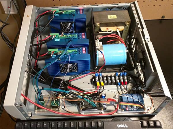

Here's a shot of his Controller built in an ATX PC Case...
Open control panel with complex wiring, highlighting the inner workings of a machine used in metal fabrication and CNC machining.
And here it is with wiring.  The author talks about 3D printing some wiring conduit to help clean it up-another brilliant use for a 3D printer!

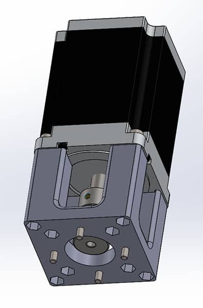

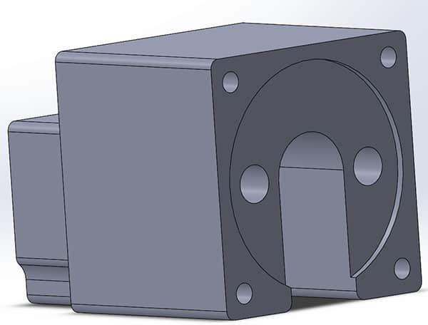

Motor mount from Hossmachine's G0704 plans.  This was scaled up to support NEMA 34 motors.

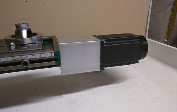

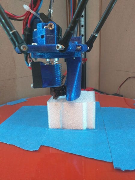

Here's the 3D Printed Y-Axis motor mount.  PETG was used for superior layer adhesion, strength, and hardness.
A 3D printer bearing block being printed on a blue platform with red and black wires in the background.
3D Printing the Y-axis Bearing Block...

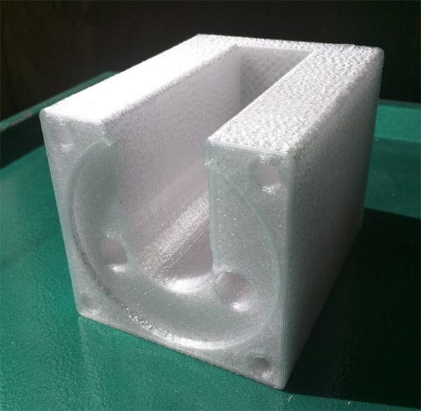

A rectangular block of white foam with a hollowed-out interior and a circular design.
3D Printed X-Axis Motor Mount...

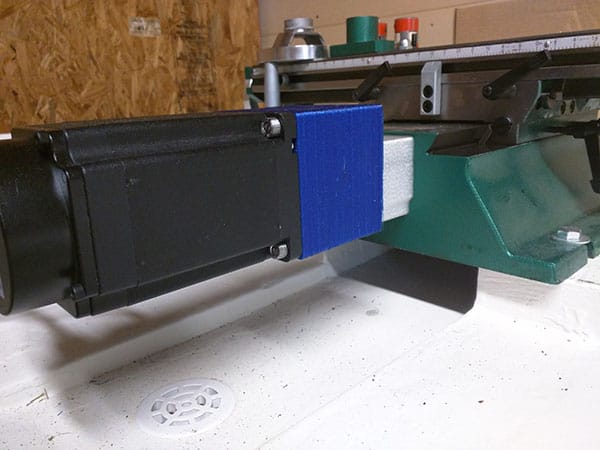

Black cylinder with blue square on white surface.

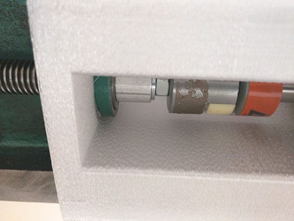

Y-Block and Motor Mounted, Installed on Mill...
Motor mount on workbench.
X-Axis Mount bolted up...

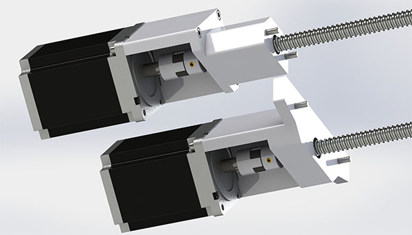

Metal object with cylindrical component in red and white.
Lovejoy coupling up underneath mounts...
A rectangular metal component with a circular opening and multiple mounting holes and slots.

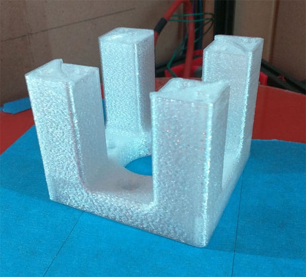

Z-Axis will look like this...
Polystyrene foam U-bracket with circular hole on background with cardboard box and tools.
3D Printed Z-Axis Mount...

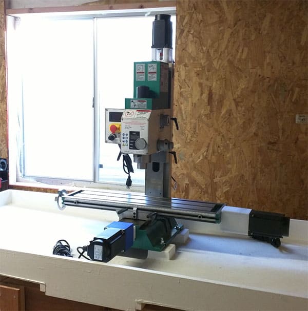

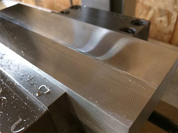

All axes are bolted up...
Metal surface with visible tool marks and parallel grooves from machining.
Initial cuts with a facemill.  That's roughing pass in the foreground showing via equal crosshatch patterns that the mill is trammed properly.  The rear is a finish pass.  Not too shabby for plastic parts, ACME screws, and plenty of backlash!

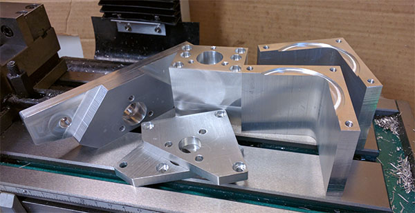

The point of all this is to machine these nifty new mounts out of metal for ballscrews...
Shiny aluminum parts with varied shapes, sizes, holes, and features.
Here's what the new metal parts look like.  They're CNC machined and came out gorgeous.
