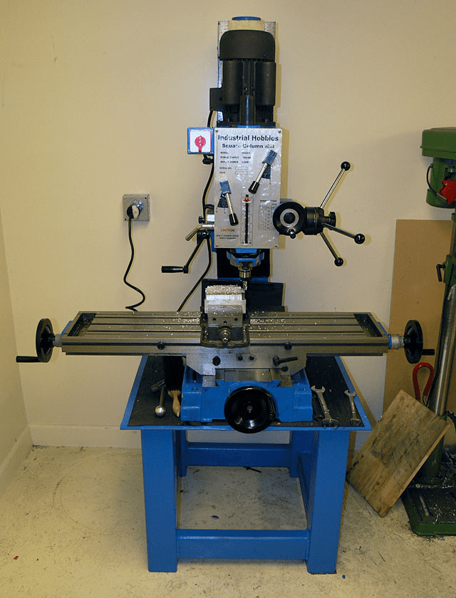

Two great choices from a mass and rigidity standpoint would be an RF-45 milling machine like my Industrial Hobbies mill, or for a G0704 like Hoss is doing so well with. The G0704 is more compact than an RF45, but it retains most of the capability of the larger machine. If you don’t have room for an RF45, by all means go for the G0704 and don’t look back. But, if you do have room, I like the bigger machine. If nothing else, it has more travels and more mass. Still, the G0704 is very capable, and with Hoss working so diligently at modding his, they are probably even better supported for do-it-yourselfers than RF-45’s. I’m going to proceed on the RF-45 path for these articles, but you can find most of what I mention for the G0704 milling machine over on Hoss’s site about that machine.

Let’s put aside the idea that this article is about “Benchtop” milling machines, and the classic Bridgeport clones are way too big for a bench. An RF-45 on a dedicated bench such as pictured above might as well be a knee mill in terms of floor space needed in your shop. Most knee mills have a much more ideal spindle too than RF-45s. Plus, knee mills have more flexibility. For example, you can attach a very tall workpiece to the side of the table, let it droop almost to the floor, and swing the head over to work on it. Can’t do that on a bed mill! Why not choose a knee mill?
