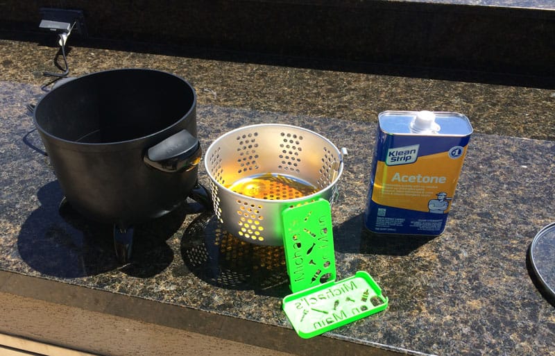

First thing you need is a heated chamber to contain your part and vaporize the Acetone. There’s a piece of cookware called a “Presto Kitchen Kettle Multi-Cooker Steamer”. It’s just a cheap and cheerful little self-heated pot that includes an electrical thermometer control, a tempered glass lid, and a drop in basket. Perfect for our task and cheap. I ordered mine from Amazon for $40, but they can be had cheaper if you head out to your local discount store. In addition, you’ll need a small container of Acetone. Acetone is commonly used as fingernail polish remover and is also used as a solvent. I got mine from the paint department of the local hardware store. Here are the basics:
The fabulous Presto Kitchen Kettle Multi-Cooker Steamer and accessories…
You’ll note some gold colored tape in the bottom of the basket. That’s Kapton tape that I applied so my parts wouldn’t pick up round indents from the holes in the basket. I suppose you could also drop a circle of glass into the bottom for the same purpose.
Note that I have arrayed the components for my Acetone Polishing experiments outside on our BBQ counter. Acetone fumes are noxious and the stuff is flammable, so do yourself a favor, be safe, and do your polishing outdoors.
The other modification I want to mention is adding some crude feet to the basket to raise it above the level of the liquid acetone:
The basket needs “feet”…
I just used some socket head cap screws I had laying around and double nutted them in place.
Now you’re ready to go. The process is pretty simple. Put a small amount of Acetone in the bottom of the chamber. Just enough to cover the bottom will be plenty. Put your basket in with the part and cover with the glass lid. Now turn up the temperature controller until the light just turns on. You don’t have to get Acetone very hot before it vaporizes. Pretty soon you’ll see the vapors condensing on the glass lid and dripping back down via the sides. Having a domed glass lid is perfect for this. As soon as you see this happening, shut off the temperature controller. Now you need to decide how long to polish for. It doesn’t actually take very long at all. I did a couple of runs and found that leaving the part in for 1 minute after the initial minute of warm up was about perfect. You can leave it in longer, but there comes a point of diminishing returns. I was determined to see where that was and managed to destroy a part at the 25 minute mark:
