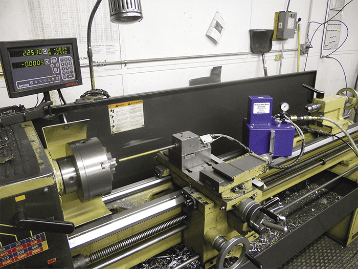

Gun Drilling on a Lathe
While gun drilling can be done on a lathe, it is better done on a special-purpose deep hole drilling machine.  The advantages of the deep hole drilling machine include the ability to rotate both workpiece and gun drill (in opposite directions), whip guides to support the long drill and workpice, plus high pressure coolant for better chip evacuation.
Contra-rotating tool and workpiece contributes to straighter drilled holes.  Dedicated deep hole drilling machines also have more sophisticating monitoring of loads and coolant pressures that correctly identify when the tool is dulling and needs to be changed.
Anthony Fettig, CEO of UNISIG, says the dividing line is at about a 40:1 depth to diameter ratio.  That’s the point where purpose-built deep hole drilling machines start to have a significant performance advantage over using gun drills on conventional lathes and milling centers.
Even so, gun drilling on an ordinary lathe can still be effective.  Here’s a gun drill in operation on a manual engine lathe with just a mist coolant unit:
gun drilling on a lathe
Image via CTE Magazine.
Such a simple rig will take holes to much greater depths than ordinary twist drills can reach.
Given that whipping can create a real safety hazard as well as completely destroying the gun drill, some important procedures must be followed when gun drilling on lathes without whipping guards:
  1. Create a pilot hole at least 1 to 2 diameters deep and 0.0005 – 0.001″ larger than the gun drill.
  2. Position the gun drill in the hole before starting rotation.
  3. Always stop rotation before removing the gun drill from the hole.
  4. Consider a steady rest on the lathe to help stabilize gun drills.  If you don’t have a steady rest, you may have to use a series of progressively longer gun drills.  Try to keep less than 40 diameters length of gun drill unsupported.
  5. When using mist instead of high pressure coolant, reduce feedrates by 60%.  The smaller the hole, the more important higher pressure coolant becomes.
Gun Drills are happier with cutting oil than typical water soluble coolant used with CNC.  Keep the coolant temps below 80 degrees F so you don’t lose viscosity on the oil.  All that is telling you is that where coolant is concerned, lubrication and keeping chips evacuated  is more important than cooling.
Check with application support for specific coolant recommendations based on the  depths of your hole and the tool in use.
