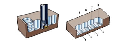

Plunge Milling is a type of CAM Toolpath, though it can be programmed manually as we will see. The idea, is to rough out a pocket, profile, or 3D surface by plunging either a twist drill, an endmill, or a special-purpose milling cutter straight down into the material.

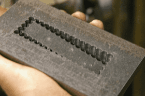

Here's a typical example:
Plunge Milling a Pocket - Image courtesy of BobCAD...
The graphic shows a typical plunge milling operation for a square pocket. As you can see, a chain of holes are plunged vertically with the milling cutter to rough out most of the pocket area. A subsequent finish pass will complete the pocket.

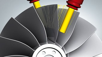

Talk about a lack of rigidity-long reach and thin walls make Plunge Milling a natural for this 5-axis turbine application. Image courtesy of Hypermill.

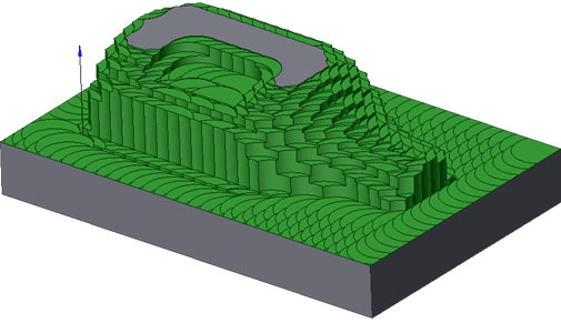

- 2D vs 3D Plunge Milling: Some Plunge Milling toolpaths only support 2D features where the floor is at the same Z, while others can do full 3D Profiling via Plunge Milling.
3D Plunge Milling. Image courtesy of SprutCAM.

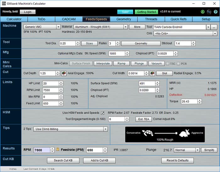

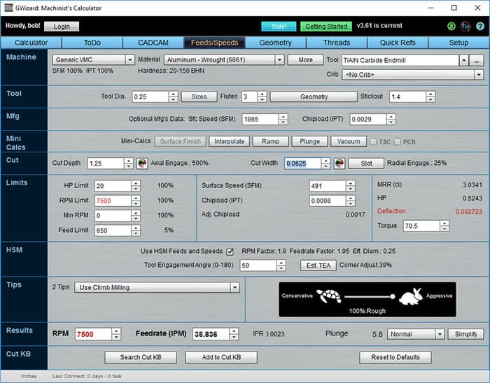

Let's work through an example that shows the strengths of Plunge Milling. Suppose we are handed the task of roughing out a pocket that has 1/8" corner radii, which dictates and endmill no larger than 1/4" in diameter. Next, suppose that pocket is 1 1/2" deep.
I can already hear the groans out there in the audience-a pocket that deep with such a small endmill is likely to be a bear!

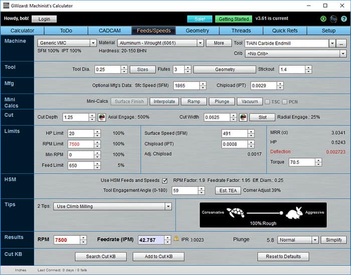

Just to keep things simple, I'm going to choose X and Y stepovers of 0.0625" for this job. Let's check Feeds and Speeds with G-Wizard and assume we want to use an HSM roughing strategy like Adaptive Clearing or Volumill:
MRR isn't bad at 3 cubic inches/min, but deflection is way too high...
The MRR isn't bad at 3 cubic inches/min, but deflection is way too high. This approach is going to chew up tools very quickly with almost 3 thousandths of deflection.
We can use G-Wizard's Cut Optimizer to see how much stepover is allowable to keep things within deflection allowances:
Cut is almost impossible without too much deflection...
A quick click on the "Cut Width" label has Cut Optimizer taking us all the way down to a Cut Width of only 1.4 thousandths and there's still a bit too much deflection. We could probably live with that, but MRR is down to a lousy 1.1 cubic inches a minute.

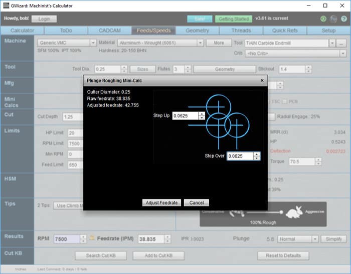

We're going to lose our shirts on this job if we don't find another way. What about Plunge Roughing?
Click the "Plunge" button to bring up the Plunge Milling Mini-Calc:
G-Wizard's Plunge Milling Calculator...
G-Wizard's Plunge Milling Calculator let's us enter a Step Up (amount to move into material at start of each pass) and a Step Over (amount to move laterally from prior hole on the same pass) and adjusts the feedrate based on those parameters.
Here is the result:
Here's a case where Plunge Milling shines...
Here's a case where Plunge Milling shines: our MRR is back in the 3 cubes a minute territory of the original HSM scenario, and while the Deflection error is still red, we can ignore it because we're plunging and there will be no significant deflection while doing that.

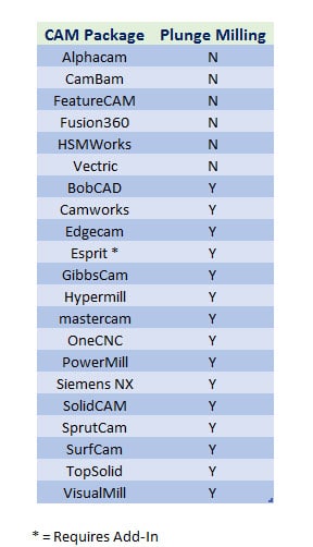

Which CAM Packages have a Plunge Milling Tool Path?
Here is a list of the most popular software from our last CAM Package Survey that shows whether each package has Plunge Milling or not:
As far as differences in Plunge Milling toolpath quality, it's worth checking on whether your CAM package supports two capabilities.
First, does it do true 3D or just 2D Plunge Milling? 3D is obviously much more general while 2D will only work for flat-bottomed features.

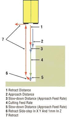

Second does the plunge cycle retract away from the wall during the overall retract? This reduces chatter and increases tool life when machining tough materials. Here's the Plunge Rough retract style jointly developed by WorkNC and Ingersoll:
Retracting from the Wall slightly during Plunge Rough...
Retracting from the Wall slightly during each Plunge Rough stroke can improve tool life by 10 to 15 percent, according to the developers of the technique.

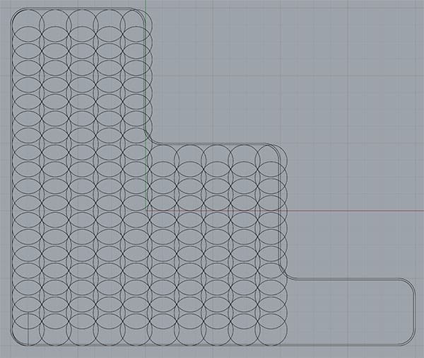

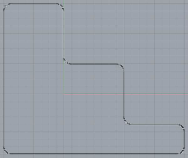

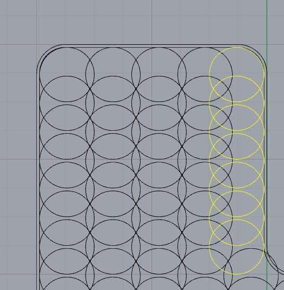

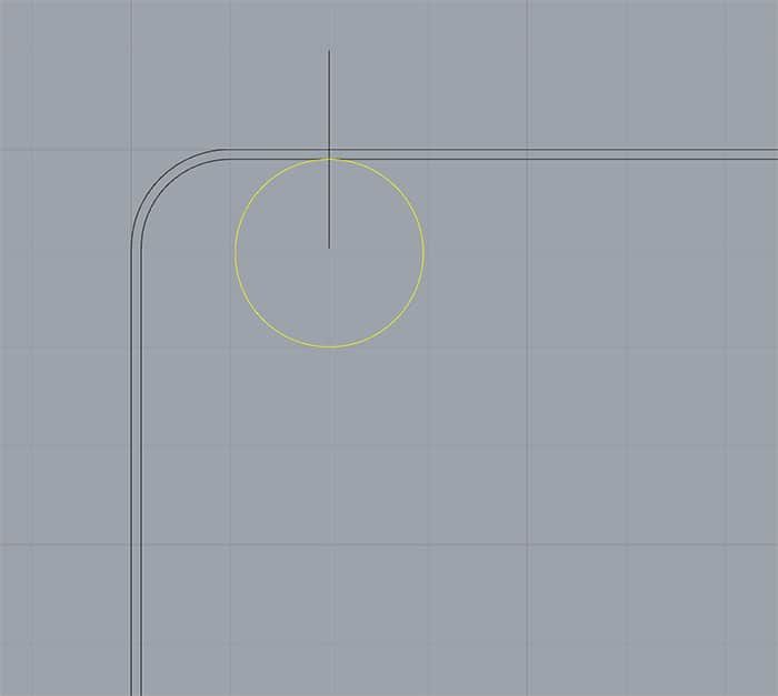

Here's an example I partially worked through in Rhino3D:
- Start with the outline of your pocket. Inset that outline by a finish allowance. Here is the contour with an inset:
The contour of a pocket wall with an inset for a Finish Allowance...
2. Drop a circle of the endmill's diameter down and make it tangent to somewhere convenient on the inset contour:
3. Create an array of the circles with the X and Y stepover you want to use:
I didn't get the grid quite large enough!

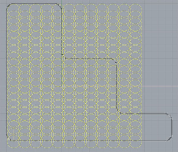

4. Trim any excess circles that extend too far out-of-bounds:
5. Adjust remaining circles at the edges so they're tangent to any inset contour edges they intersect:
That's about all there is to it. You now have a CAD drawing that shows where the holes for the plunge strokes need to go.
Import it into your CAM package and treat just like trying to drill all those holes. It'll generate the G-code which you can then further tweak as needed.
I didn't finish with the CAM part, but the CAD work only took 10 minutes and I didn't use any shortcuts. It's not hard to do if you want to play with Plunge Milling a bit. Programming something like this to clear a corner or two would be even easier.
