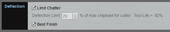

You can override G-Wizard’s Deflection Limit on the Setup Other tab…
Here's what the options do:
If you're in a tough situation and need a higher deflection limit, turn of Limit Chatter and dial up the Deflection Limit until you hit a Tool Life value that is as low as you can stand.
If your shop is fortunate enough to be taking a scientific approach to chatter, you can probably quit worrying about chatter when choosing your deflection limits.  Chatter is highly repeatable and largely depends on just four variables:
That’s a manageable number of variables, and if you know the chatter danger zone in terms of spindle rpm for those variables most of the time, you’ll know whether chatter is even an issue for the Feeds and Speeds you’re contemplating.

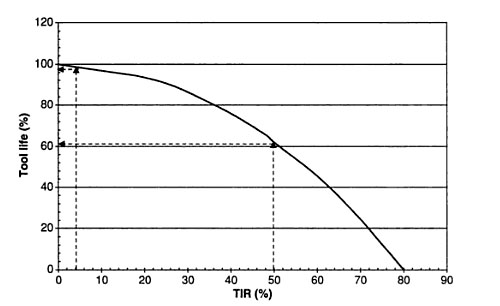

Deflection and Tool Life
Moving along from Chatter, the next issue for Deflection is Tool Life.  Here, Tool Deflection acts like Tool Runout.  In fact, they are additive.  Think of your Tool Life as being subject to Runout + Deflection.  Now given that combined number, and for a good spindle, you might assume runout is nil and view it totally as a function of Deflection, let’s look at the impact on Tool Life (taken from our article on Tool Life vs Runout):
Graph showing relationship between tool life and Total Indicated Runout (TIR).
Tool Life as a function of Runout, where Runout is measured as a % of chip load…
The chart measures Runout (or Deflection as we’re talking about here) as a % of chip load, which makes sense.  Bigger cutters allow more chip load and more runout.
Let’s say we’re running a 3/4″ endmill for a roughing operation.  G-Wizard’s default on a TiAlN Carbide Endmill suggests a max of 0.0036″ chip load.  You can buy endmills that allow more, but let’s run with this.  If we take G-Wizard’s 0.001″ deflection limit, that’s about 28%.  We can see from the chart we’re still going to get 90% of our Tool Life or so.  Deflection is probably not the big factor.
But, what if we run 0.003″ of Deflection–3 times G-Wizard’s recommended limit.  Now we’re at 83% of chip load and the chart suggests we’re probably going to break that tool in short order.  I look at that chart and about 80% Tool Life, which corresponds to 35% of chip load for the Deflection, seems like what I’d be willing to put up with to get a little more aggressive cuts.
That tells me I might set G-Wizard’s Deflection Limit (on Setup Other) up to maybe 120-125% if I wanted to live life on the aggressive side.  As it turns out, G-Wizard’s default is pretty reasonable for most users.
Another thing to consider-the lower your cutter's chipload, the lower its tolerance for deflection.  To be more concrete, very small cutters are super sensitive to deflection because they can't tolerate much chipload.  In fact, excessive runout is the #1 killer of micromilling cutters, so it stands to reason deflection is probably right up there too.

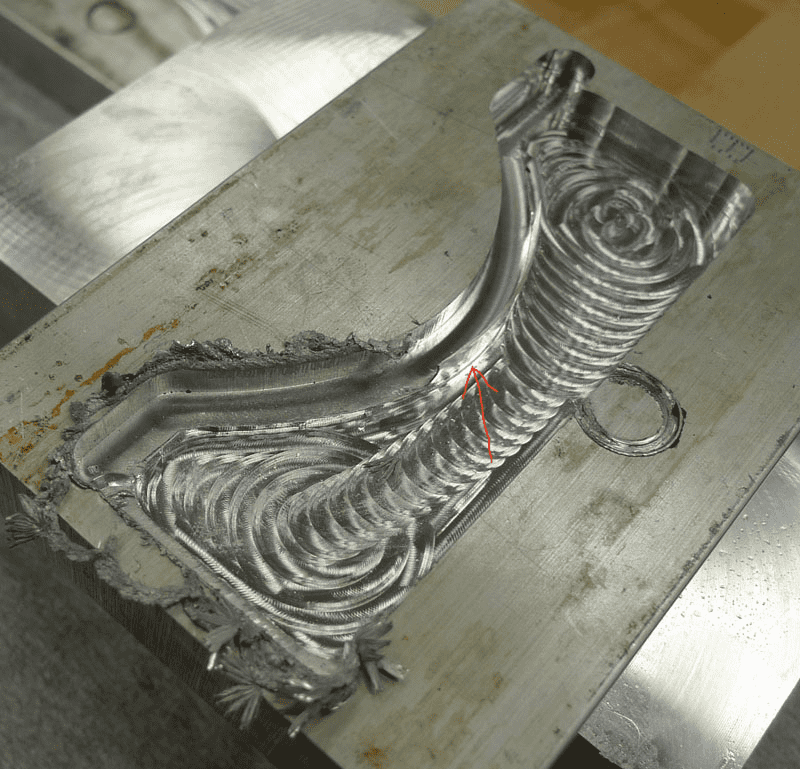

Sometimes, there will be other considerations for Tool Deflection.  I was visiting a shop one day that had just gotten Volumill in for HSM toolpaths.  They wanted to try it out and fired off a job.  Things were going nicely when suddenly we heard that telltale “PING” as the cutter bounced off the enclosure window.  Dang, broke a cutter.  What happened?
He hadn’t used G-Wizard for Feeds and Speeds, so I immediately checked it out.  The only thing amiss was an excess of Tool Deflection.  Upon examining the part closely, here is what we saw:
Metal part with intricate curved and spiral designs, demonstrating CNC machining capabilities.
See the tiny wall the red arrow points too?
See the tiny wall the red arrow points to?  Because of tool deflection, the cutter wasn’t where it was expected and we got that little wall.  It shrouded the cutter from coolant reaching it for a very short time before the cutter broke.
Problems like this are almost unpredictable, but they can crop up if we’re too aggressive all the time with Tool Deflection.

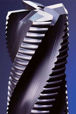

Use a Serrated Roughing End Mill for high deflection jobs.
All else being equal, they generate less cutting pressure than a standard end mill, and hence, less deflection.

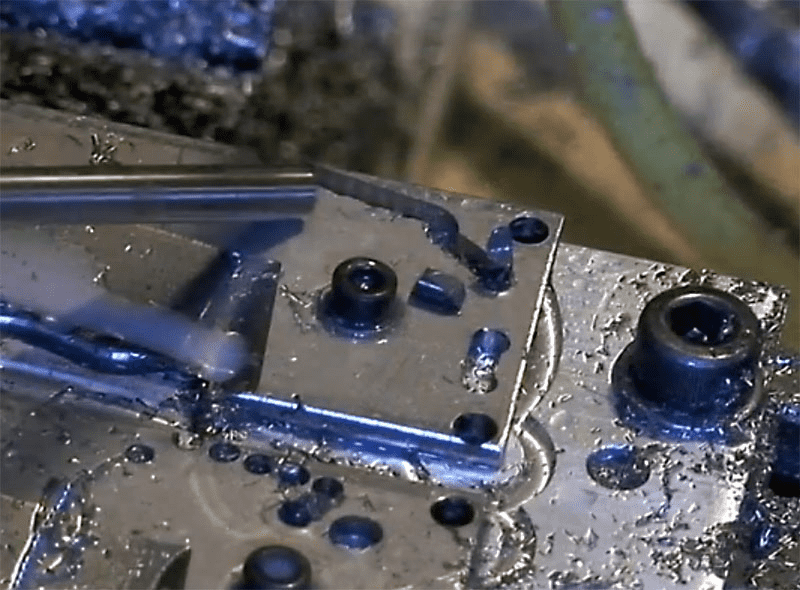

Tool Deflection is bad for Surface Finish
Now that you understand the impact of Tool Deflection on Tool Life, let's look at its impact on Surface Finish.  It should be pretty obvious that tool deflection is bad for finish, but I got a great look at it one day while watching one of John Grimsmo’s knifemaking videos.
Tool deflection eventually broke the endmill, and John’s video captured it perfectly at about 9:22.
But you can also see that instead of getting a smooth wall, you get a wavy one as the tool deflects rhythmically in time with revolutions and flutes.  Here is what such a wall looks like in this shot from John's video:
Metal workpiece with holes and features machined into it.
The wavy wall on this cut is due to tool deflection...

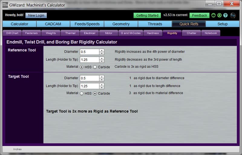

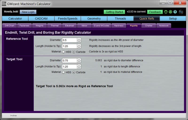

Stickout, Diameter, and Tool Material (Rigidity) Resist Deflection
Let's start to get a handle on the root causes of deflection so we can get control over deflection.  A big part of it is tool rigidity, which is mostly determined by stickout (distance from toolholder to tip of tool), tool diameter, and tool material.  G-Wizard Calculator has a Rigidity Calculator that can help us to wrap our heads around rigidity.  We're going to use it to explore what happens as we change these three variables:
High-speed steel versus carbide tools comparison chart.
Carbide is 3x more Rigid than HSS...

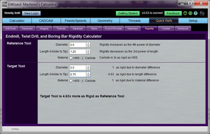

First, you can see the Rigidity Calculator is located under "Quick Refs" and "Rigidity".  We've chosen a 1/2" endmill with 1 1/2" of stickout.  The only difference between the two choices is the lower one is made of carbide and the upper is HSS.  The Calculator tells us that this change alone is worth a 3X increase in rigidity.  That's a big win and is one more advantage of carbide.  Should you then always use carbide?  Many do, but here is something that's not as well known-if you must live with a certain amount of deflection, HSS will withstand more than carbide.  HSS is more flexible while carbide is more brittle.  This is sometimes helpful to know when all else fails.
Calculator page for machining tool diameters on CNCCookbook.com.
Increasing diameter from 1/2" to 3/4" is worth over 5x the rigidity!
This example shows what happens when we increase tool diameter.  Going from a 1/2" to 3/4" endmill, a 50% increase in diameter, netted over 5X more rigidity.  That's a big win.  The goes to the topic of "Design For Manufacturing," which is all about changing the design to make it cheaper to manufacture.
Designers are only human, so they will often specify a corner radius as a nice round number.  Say, 1/2".  Of course endmill manufacturers are human too and offer the endmills in standard sizes.  What you want is use an endmill just slightly smaller than the corner radius because that's going to make the nicest cut and be easiest on the endmill, but you want that endmill to be as large as possible while still being smaller than the radius, because the minimizes the deflection, lets us take a beefier cut, and so on.
The best way to handle this is for the designer to make the corner radius a little larger than standard endmill sizes.  But, there is also a sneaky back door approach.  Get out your endmill catalogs.  You could try a 7/16" and see if you like that better than a 1/2" endmill for a 1/2" corner, or you could take a look at the metric sizes.  You can get either a 12mm or a 12.5mm, both of fall between the 7/16" and 1/2" Imperial sizes.  Go ahead, sneaky is good in this case!
Purple background online machining calculator with tabs and data entry fields.
Reducing stickout from 1.25" to 0.75" buys us 4.63x more rigidity...
The last variable we'll play with is stickout.  Reducing the stickout from 1.25" to 0.75" (back on a 1/2" endmill again) buys us 4.63x more rigidity.  Never use more stickout than you need to.
The Rigidity Calculator further tells us how much each variable impacts things and lists them from most impactful (Diameter) to least (Material):

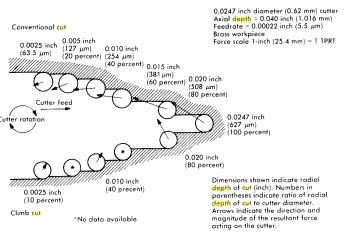

Effects of Climb vs Conventional Milling on Tool Deflection
Most CNC machinists use Climb Milling for everything and never try Conventional Milling.  There are very sound reasons to consider Conventional Milling that are covered in an article in the Feeds and Speeds Cookbook.  Take a look at that if you haven't already, but we're going to take a little mini-excerpt from it to consider the effect on Tool Deflection.  Basically, what changes is the direction the tool tends to deflect:
Metalworking cuts: conventional, climb, and more. Detailed diagrams showing dimensions.
The arrows show direction of deflection, climb is at bottom, conventional is at top...
Note that its really hard to predict these directions by calculation, these were actually measured from real cass.  The cutter is feeding to the right, so lets see how that compares to the arrows.  Note that the examples to the right show progressively deeper cut widths.
What we can see is that in conventional milling, with lighter cut widths, deflection makes the cutter "pull back" from the cut a bit.  That's a nice safety feature because it reduces chip load.  But, if we bury it, the arrow shifts to force the cutter to not only pull back, but also a bit into the wall.  This starts out as a wash, but eventually it results in increased chip loads.  By contrast, lighter climb milling forces the cutter to deflect forward into the cut and a bit inward away from the wall.
In general, imagine that Conventional Milling deflects out of the cut and Climb Milling deflects into the cut.  You'd prefer deflection along the direction of travel because that reduces waviness in the wall and if possible for the direction to be not only along the travel but pulling back from the cut.  That's a really long-winded way to explain what some of the more experienced machinists have discovered by trial and error.  Quoting from the Cookbook article (link above):
You should switch to conventional milling for the finish pass if you're at all deflection challenged (use G-Wizard to see if your tool diameter and stickout result in small enough deflection for your finish pass). At the very least, one should avoid too much depth of cut when climb milling lest it invite deflection. The same article suggests that when deflection is to be minimized, use no more than 30% of the diameter of the cutter for conventional milling and 5% for climb milling. Of course here again, if you have G-Wizard, you'll know what kind of deflection to expect and whether it's a worry.
Climbing to rough and conventional to finish is inline with the consensus over at Practical Machinist as well.
Properly managing deflection can help you avoid the need for an extra spring cut, which saves time and money.

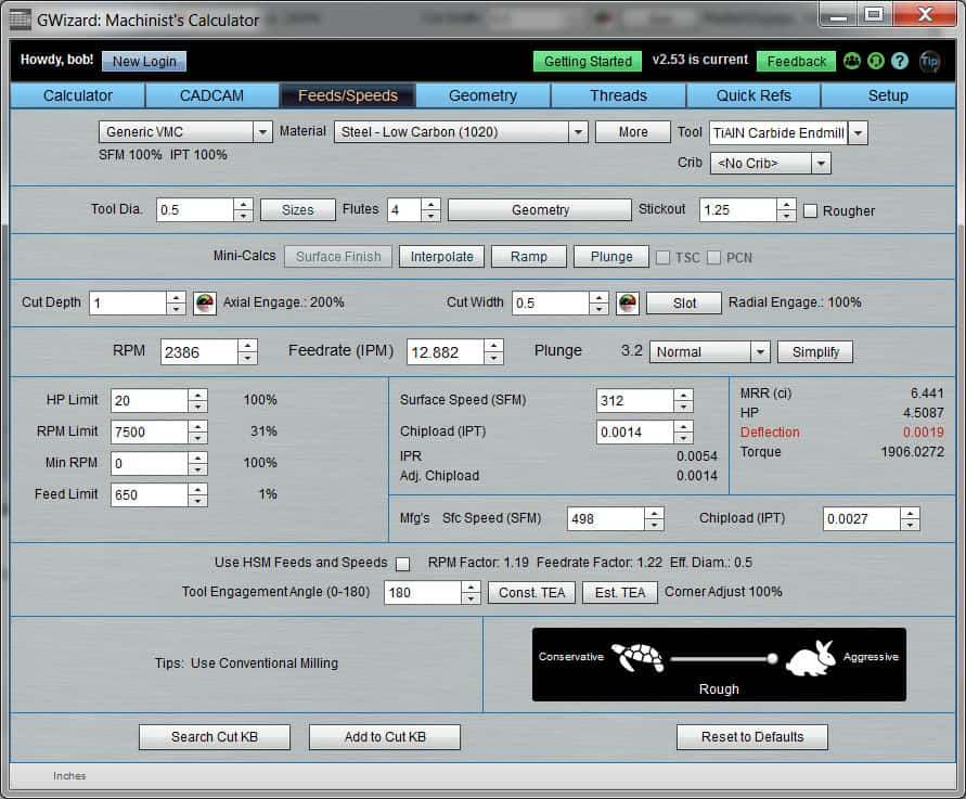

G-Wizard Calculator can help you control Tool Deflection
If it isn't obvious by now, Tool Deflection is important and you could use some help managing it.  We've built a number of facilities into G-Wizard Calculator to help with Tool Deflection.  You've seen the Rigidity Calculator above.  GW Calculator's Feeds and Speeds Calculator will show you the deflection for any cut:

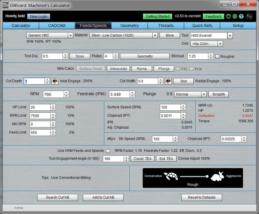

GWizard Machinist's Calculator tool screenshot from CNCCookbook.com website.
Check the red:  almost 5 thousandths of deflection on this cut...
We're trying to cut a slot 1" deep with a 1/2" HSS endmill.  Because the slot is so deep, we can't reduce stickout which is stuck at 1.25".  What do we do?
Well, as we learned, we could switch to carbide:
GWizard: Machinist's Calculator interface on CNCCookbook.com
Switching to carbide helps a lot but isn't enough...
Switching to carbide helped a lot, but it's not enough.  Let's say a larger diameter cutter is just not an option.  Rather, what we need to do is figure out the Cut Depth that keeps deflection under control.  That's what G-Wizard's Cut Optimizer is designed to do.  Just click the little speedometer next to Cut Depth (since that's what we want to calculate-there's another little speedo next to cut width if you prefer to change that) and it'll pop up with the answer:
CNCCookbook.com Cut Optimizer page with gray box, tables, and save button on light gray background.
With one click, Cut Optimizer determines the best depth of cut would be 0.2485"
With one mouse click, Cut Optimizer determines the best depth of cut would be 0.2485", and you can save that back to Feeds and Speeds.  Done!
