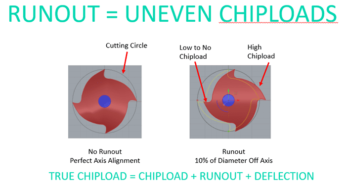

In this chart, runout is given as a percentage of chip load, which is the thickness of a single chip being sliced off by your cutter. This is how I like to think of runout–it increases chip load beyond what you intended. As you can see, tool life goes down dramatically when we get to TIR’s (Total Indicated Runout) beyond about 20% of your cutter’s targeted chip load. This also explains why runout is so hard on tiny cutters–they have small chip loads and can tolerate very little runout as a result.
To understand visually how tool life is impacted by spindle runout, I put together this diagram:
As you can see, runout creates uneven chip loads, so some flutes get way too much and wear fast while others get too little. That’s not a happy situation for your endmills!

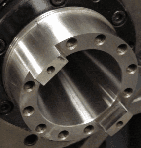

Every CNC machinist has seen the ubiquitous “drive dogs” found on many tapers:
Spindle Drive Dogs…
They’re the two little “ears” that engage notches in the toolholder. Not every taper has them, but many do. Getting the drive dogs positioned to line up with the toolholder in the changer carousel before a toolchange can happen is called “spindle orientation” or sometimes “spindle positioning”.
You might think spindle orientation is only about lining up the drive dogs with toolholder notches, but I recently learned differently. There are tapers that don’t have drive dogs and they still do spindle positioning during toolchanges for a very important reason.
Dave Decaussin, one of the original founders of Fadal, recently remarked on a video I was watching that spindle orientation is also essential to maintaining tolerances while machining.
The reason is (drumroll please) runout. Exactly what we’re here to talk about!
When you maintain the same spindle position relationship to the toolholder, you ensure that whatever runout there is will at least be consistent–either consistently good or consistently bad. Consistency is the main thing, because if it is consistent, we can compensate for it.
If you think about it, the runout just makes the endmill act like it is a slightly larger diameter as it wobbles in the cut. If that effective diameter changes every toolchange, the CNC machinist will have a tough time maintaining tolerance. But if it is consistent, there is hope. You can use your wear offsets to just enter the effective diameter of the tool and cut accurately despite that runout.
