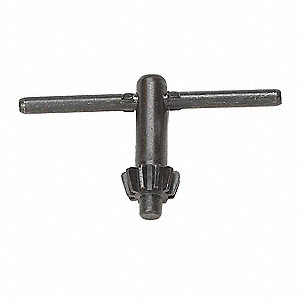

Jacobs chucks require a key to operate:
Drill Chuck Key

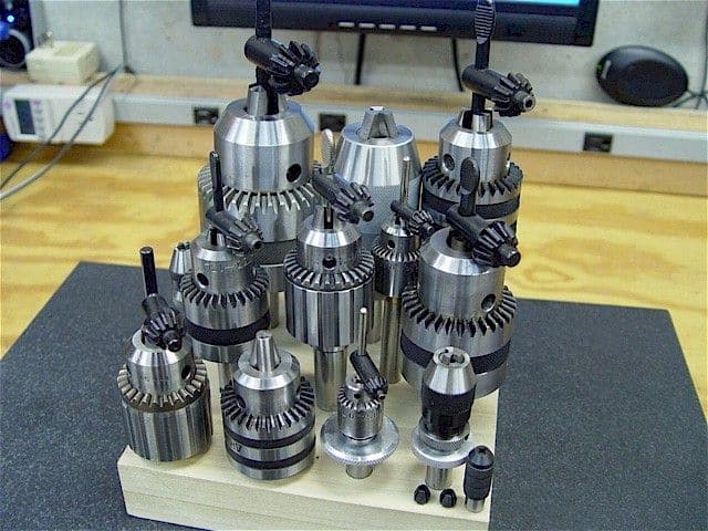

Drill Chuck Sizes
drill chuck sizes
Image courtesy of micro-machine-shop
Drill chucks come in a great variety of sizes from small to large.

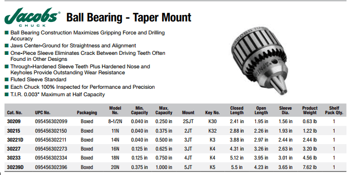

Jacobs Chuck Sizes
Courtesy of Jacobs

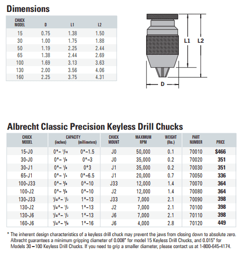

Keyless Chuck Sizes
Keyless Drill Chuck Sizes, courtesy of Royal Products

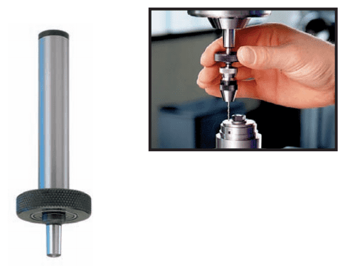

The sensitive drill feed is an arbor with spring-loaded extension that can be used to hand feed delicate small twist drills with a smaller chuck:
sensitive drill feed mini chuck adapter
Sensitive Feeds are useful on manual mills and drill presses, but are seldom used with CNC where exact feeds are easily programmed.

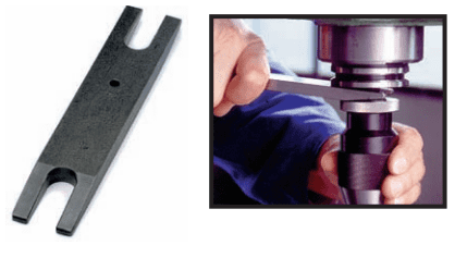

If your drill chuck is mounted on a machine taper, then you’ll use a drill chuck removal wedge to remove it:
The wedge goes between top of chuck and the flange on the taper to force the two apart.  Instructables has a good article on how to approach iit.
Make sure your chuck isn’t threaded on, as a wedge will damage a threaded drill chuck installation.
