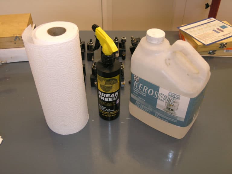

Never use a collet chuck or collet straight as it is shipped to you.  It will have cosmolene or some other protective grease that needs to be removed before use.  I give all my tooling a "Check-In" procedure that involves degreasing with kerosine (use WD40 in a pinch) to remove the cosmolene and then I apply a rust preventative.
I like Break-Free as my preferred rust preventative, which is used by the US military and others as a firearm protectant.  Break-free is available as an aerosol, but I prefer the pump bottle as is shown.  I’ve taken to using the pump style with WD-40 too–I still use WD-40 for lots of things, just not as a rust preventative.  You can order a bottle of Break-Free from Amazon for a little over $20.
I live on Monterey Bay, and there’s often a sea breeze.  The breeze is nice, but it’s full of moisture and salt.  Having a good rust preventative like Break-Free helps me sleep better.  I’ve never noticed any rust on my tools.  On tools I use a lot, I may give them an extra wipe down before they go back in the tool box once a year or so.
After you remove the heavy shipping lubricant, and your tools are in use, you'll want something lighter than kerosene for degreasing.  A quick shot of brake cleaner works or there are many other products that will do.

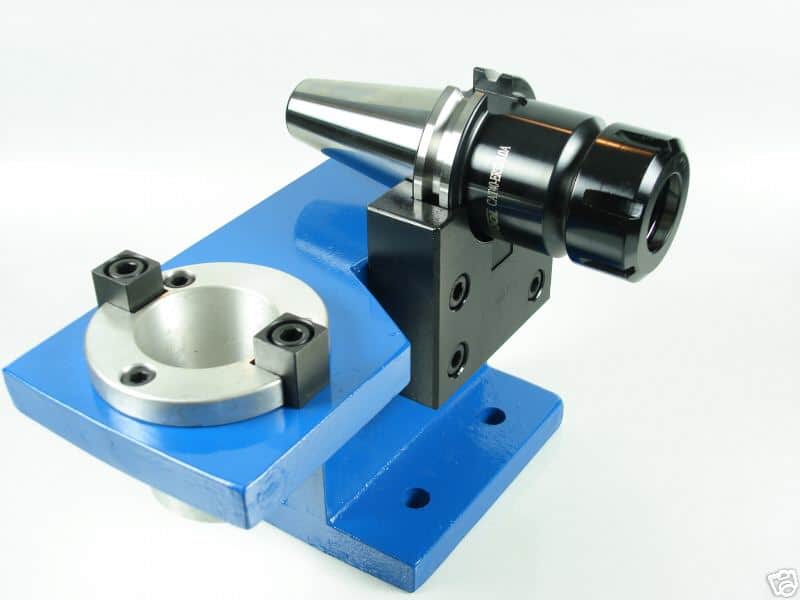

Are you torquing your ER32 collets to 100 ft/lbs? That's a bunch more than a lot of folks expect going on feel alone.
To hit the higher specs comfortably and reliably, you'll need a fixture to hold the toolholder while you tighten the nut.  Don't rely on tightening it in the spindle of the machine.
Blue vise with silver cylindrical component, black metal piece with holes, and silver circular base.
Here's a nice tightening fixture from Maritool.  Tosa Tool also makes a nifty fixture for TTS Collet Chucks...

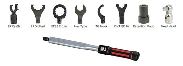

A torque wrench is ideal for tightening the nut if you want to make sure you're hitting the torque spec.  This adjustable wrench from Techniks along with the adapters for various collet nuts would be just the ticket for a well-equipped toolroom:
Torque wrench attachments and tools, featuring various ER and hex types.
Adjustable torque wrench and adapters for ER Collet Nuts from Techknics
Whether you use a torque wrench or not, make sure you've at least got a nice wrench for your chuck. The single pin spanners are the worst for me when I have to apply a lot of torque.

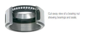

Tip #4: Consider ball bearing nuts for your ER Collet Chucks
Cut-away view of a bearing nut with internal components.
Here is another interesting factoid [gleaned from my research](https://books.google.com/books?id=PvK72Ymaj10C&pg=PA334&lpg=PA334&dq=er+collet+torque&source=bl&ots=AjM8lw64-v&sig=nq5eh9jbozG5fDdOrhZNbFNgDpk&hl=en&ei=TKyfTI7XIIKosAOswKnWAQ&sa=X&oi=book_result&ct=result&resnum=2&ved=0CBoQ6AEwATgU#v=onepage&q=er collet torque&f=false): ball bearing nuts for ER Collets can improve their performance even further. A ball bearing nut has about 14% more static stiffness for surface finish, but a whopping 50% more damping, which helps keep the chatter out when you have to get aggressive with a cut. I can tell you from experience that the ball bearing nuts are much nicer to use too-applying enough torque with one is much smoother.
The disadvantage of ball bearing nuts is they have moving parts, and so are difficult to keep well balanced for high rpm applications.

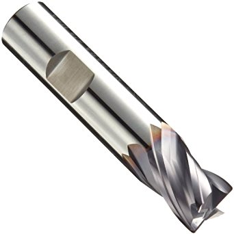

Tip #6:  Avoid Weldon shanks on endmills-they're more likely to slip in a Collet Chuck.
Silver cylindrical object with flat top and bottom, rectangular protrusion, and tapered point.
Weldon shanks reduce the holding power of ER Collet Chucks by 30%...
If you use a Weldon-shank cutter in your ER collet chuck, expect holding power to be reduced by up to 30%, which is the amount of surface area that can't be gripped because of the Weldon cutout.
