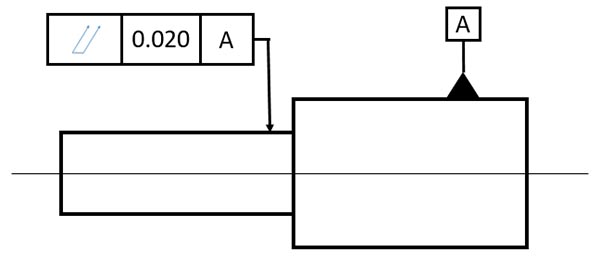

Total Runout Callout on Drawings
Technical drawing with total runout measurement, TIR symbol and value 0.020.
Total Runout Callout...
Total Runout requires a datum, so be sure to include the datum on your callout.
Gaging and Measurement of Total Runout
Measurement of Total Runout is a typical process for cylinder work. Put the part in a set of V-Blocks so it can be rotated around the axis them measure the total movement of a dial indicator held at constant height against the entire surface being controlled.
