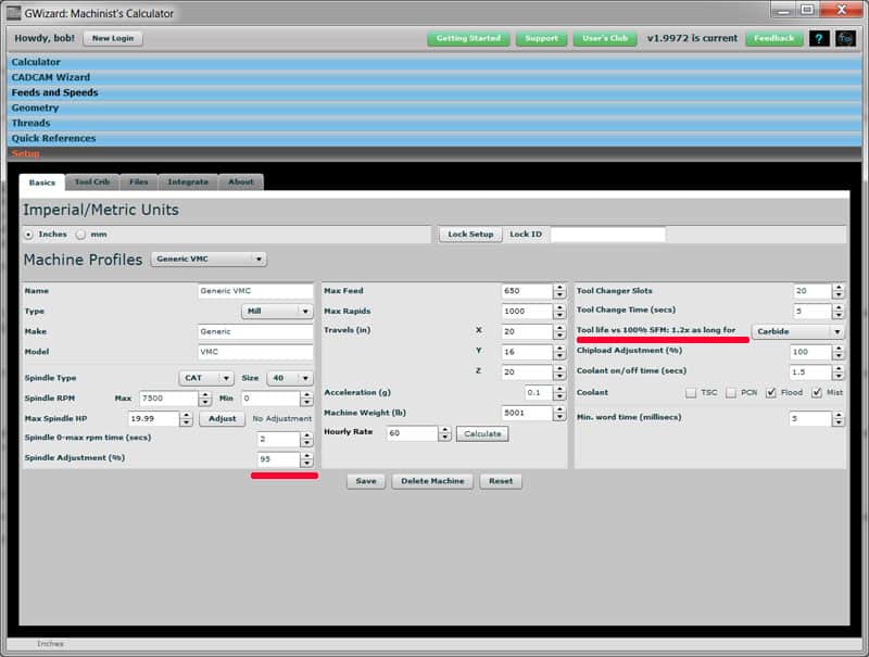

5.  Add a Surface Speed Safety Factor
Given a choice between reducing surface speed (SFM or spindle rpms) and reducing chip load, surface speed is the one to go after for tool life unless you're breaking relatively new cutters, in which case you need to reduce chip load.
A slight reduction in surface speed can yield big dividends for tool life.  Surface speed is all about how hot the tool can run and reducing it lowers the heat.  Heat softens the cutting edge which means it dulls faster.  You can see why reducing heat even a little can really increase tool life substantially.
G-Wizard Calculator has the ability on every machine profile to specify a multiplier for the calculated surface speed.  It'll even tell you how much more tool life you can expect:
GWizard website's Machinist's Calculator tool screenshot with tabs and input fields.
Reducing Surface Speed 5% can increase tool life 20%...
