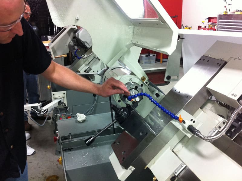

So, I set the tool on centerline using the ruler trick:
Put a ruler between the tool tip and the workpiece and crank it down so the ruler is held between the two. If the ruler is not perpendicular to the line from tool tip to center, you need to raise or lower to make it perpendicular. I say “perpendicular” instead of “vertical” because the Tormach is a slant bed lathe.
Here we are working with this process:
My machinist friend is using a little 6″ steel rule to check the centerline…’
After doing this, the surface finish changed radically for the better. It’s an easy process that a lot of folks use, but how accurate is it?

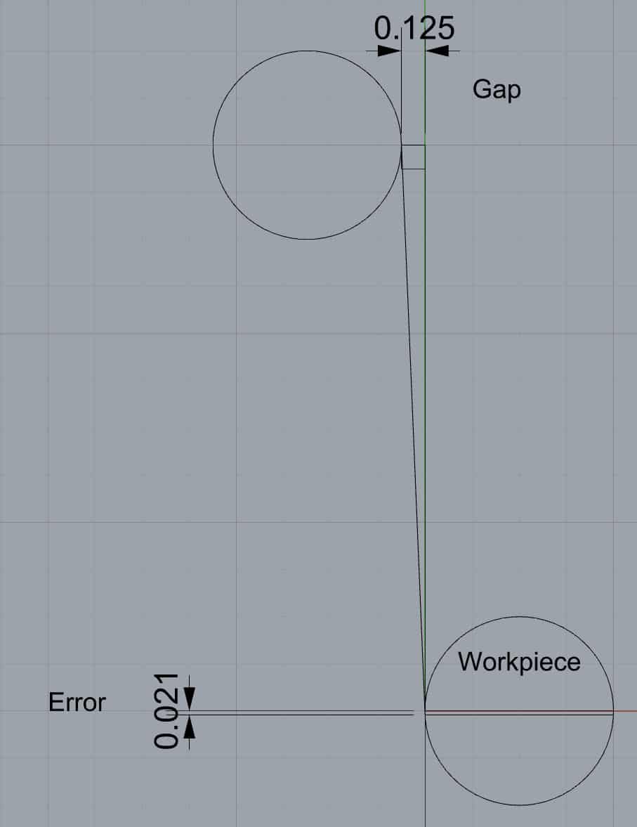

This is a good opportunity to use your CAD program to figure it out. Most CAD programs have a function to draw a line that is tangent to two curves, so I laid out the problem like this:
I drew a 1″ diameter workpiece and put a vertical line tangent to it. Then, I went up that line for 3″, where the top of my 6″ rule would be, and drew a 1/8″ square to represent my Mark I Eyeball’s ability to spot the rule being off. You can probably see an error of less than 1/8″, but probably not 10x less, so this suffices.
Next, I drew another 1″ diameter circle right on that 1/8″ gap. Lastly, I let the CAD program draw a line tangent to the two curves. That line represents the rule cocked at the right angle. Now zoom in to see the endpoint of that ruler line. I put a dimension from that endpoint up to the centerline and got an error of 0.021″.
Easy to calculate the crazy things by sketching them out in CAD (I use Rhino3D and Solidworks for my CAD).
But what about that error? I’m guessing we got down to more like 0.010 or maybe even 0.005″ when we set up the tool. Of course this begs the question, “How close does the tool tip need to be to the centerline when turning?”

Sandvik says you want to be within 0.1mm (0.0039″). This is a decent starting guideline. To achieve it, the end of your 6″ rule must be off no more than 0.023″ instead of 0.125″ from its ideal position. A useful trick is to find a surface you can site the edge on, much as I suggest when using a straight edge to tram vise jaws on the mill. With a slant bed lathe, it may be hard to find a surface at the right angle.
