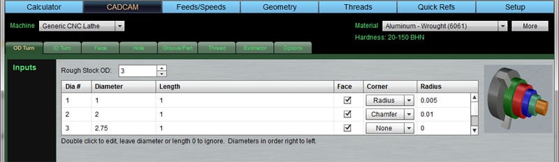

First, here are the inputs you need to give it to get some answers:
OD Turn Wizard Inputs…
To use the OD Turn Wizard, you’ll need to tell it your Rough Stock OD (Outside Diameter). Directly below the Rough Stock OD is a table of up to 6 diameters you can turn. This saves you the trouble of entering them one at a time. Seems like most turning jobs will require more than one diameter.
For each diameter, you indicate the diameter, length along the axis for that diameter, whether to face the right edge, and how to prepare the corner of the right edge. Corner preparations include Radius and Chamfer. We’ll use a similar UI to generate g-code in our Conversational Wizards for GW Editor, but for now, this is only available for Feeds and speeds.

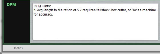

DFM: Design for Manufacturing Hints
The OD Turning Wizard also gives Design for Manufacturing Hints down in the little DFM box. For example, if we specify an especially long overhang on a part, we might get this message:
Design for Manufacturing Hints…
G-Wizard knows when your parts avg diameter to length ratio is such that a tailstock will be needed. It puts this into the DFM area because a part that requires a tailstock will be a little more expensive to make than one that doesn’t, all other things considered. Note that there are alternatives, for example using a Swiss machine or a box cutter. These are other approaches to cutting long skinny parts without getting too much deflection. All of the CADCAM Wizards have a collection of DFM rules that can be triggered to help you keep your parts as simple as possible and no simpler.

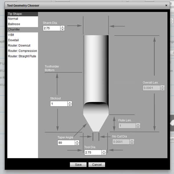

Chamfer Geometry for Endmills
This is a feature that is requested fairly often. It was the #2 most requested feature (after mobile device support) on our User Portal.
I had to do some fairly major Tool Crib overhaul work to handle some other niggling issues, so I wanted to make adding geometries easy going forward as well. The new Chamfer Geometry feature is super easy to use. Just select an endmill, click the “Geometry” button, and select the “Chamfer” geometry from the popup:
Chamfer Geometry…
The Taper Angle for the Chamfer is the included angle, which means it includes both sides. So, 90 degrees gives a true 45 degree chamfered edge.
