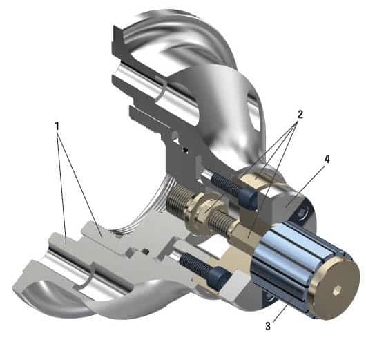

Expanding Mandrels grip the part by expanding against the walls of an inside bore. Here’s a typical example:
They typically work by tightening a screw in their center that causes the leaves of the mandrel to expand and grip the ID bore of the part. It’s possible to machine a profile on a mandrel to fit a part with complex internal geometry. It’s also common to see them with shoulders to locate the end of the part and other similar features.
Mandrels don’t have a huge range of motion, so it is common to machine them for a particular part’s needs.
The one pictured is a simple mechanical type, but you can get power-operated expanding mandrels too. Here’s one that Royal makes:
A power operated mandrel like this can be a good choice for a sub-spindle on a CNC lathe because they grip without any possibility of damage to the outside surface and provide complete access to finish that surface in one operation.
