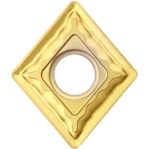

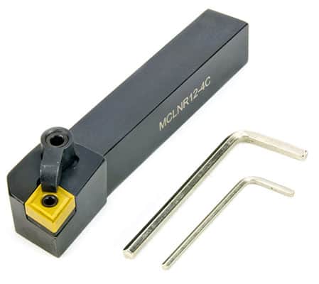

#1 OD Rough Turning Tool
Few jobs can get by without an OD Roughing tool.  You want something sturdy, something that can peel a bunch of stock quickly, and something whose inserts are economical to replace and last a long time.  Some of the most popular insert choices for OD Roughing are the venerable CNMG and WNMG inserts:
CNMG
CNMG Insert…
WNMG
WNMG Insert…
Each of these styles has strong adherents, and perhaps the best arguments for one over the other is that the WNMG can also be used in boring bars and can sometimes approach a tighter situation than the CNMG while many view the CNMG as being a tougher duty insert.

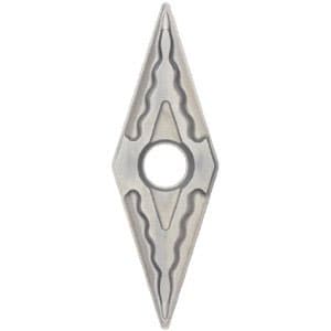

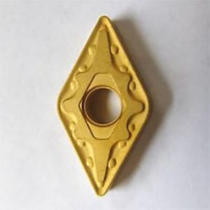

#3 OD Finishing Tool
Some get by using the same tool for roughing and finishing, but this is not ideal for the best finish.  Others like to use the same insert on two tools–one for roughing and the other for finishing.  That’s better.  New inserts can go on the finisher and then be graduated to the rougher once they’re not as sharp. But choosing different inserts for roughing and finishing provides the highest performance and flexibility.  The most popular insert choices I found for the finishing tool was the DNMG and VNMG:
DNMG
DNMG insert…
VNMG
VNMG…
These two are very similar, though I guess you could argue the VNMG can reach into tighter spots.  Being able to get into the tight spots is important for a finishing tool.  Just as on a mill you may rough a pocket with a larger cutter but have to eventually use a cutter that can get into the tight corners, the same is true in turning work.  Another thing to consider is that these skinny inserts have better chip clearance than the roughing inserts. It’s often a small chip stuck between the flank of an 80º insert (CNMG.WNMG) and the workpiece that ruins a nice finish cut.  The chips simply have a better chance of getting out of the way before they can scratch up the work with this style insert.

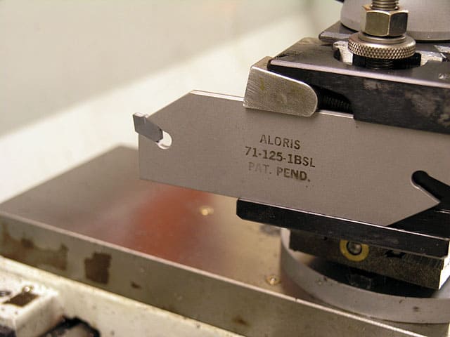

#4 Parting / Cut-Off Tool
A Parting Tool is going to be needed for the vast majority of jobs that involve cutting multiple parts from a piece of bar stock.  That’s common enough that you may want to dedicate a turret station to a Parting Tool.  Most folks seem to prefer the blade type with replaceable inserts such as this one I use that has GTN-style inserts:
OLYMPUS DIGITAL CAMERA
GTN insert style Parting Tool…
Sometimes these are overkill and a smaller blade style is preferred, perhaps even one that’s been hand ground to improve its performance.
There are also other useful things that can be done with parting off blades.  There are inserts available that are angled to reduce the nib on one side or the other.  There are inserts that have a radius on the side so you can even do some tight turning work with them.  They won’t set any records for hogging material, but the tiny radius on an insert like this can sometimes make a much smaller radius than the bigger OD Finishing inserts can manage.

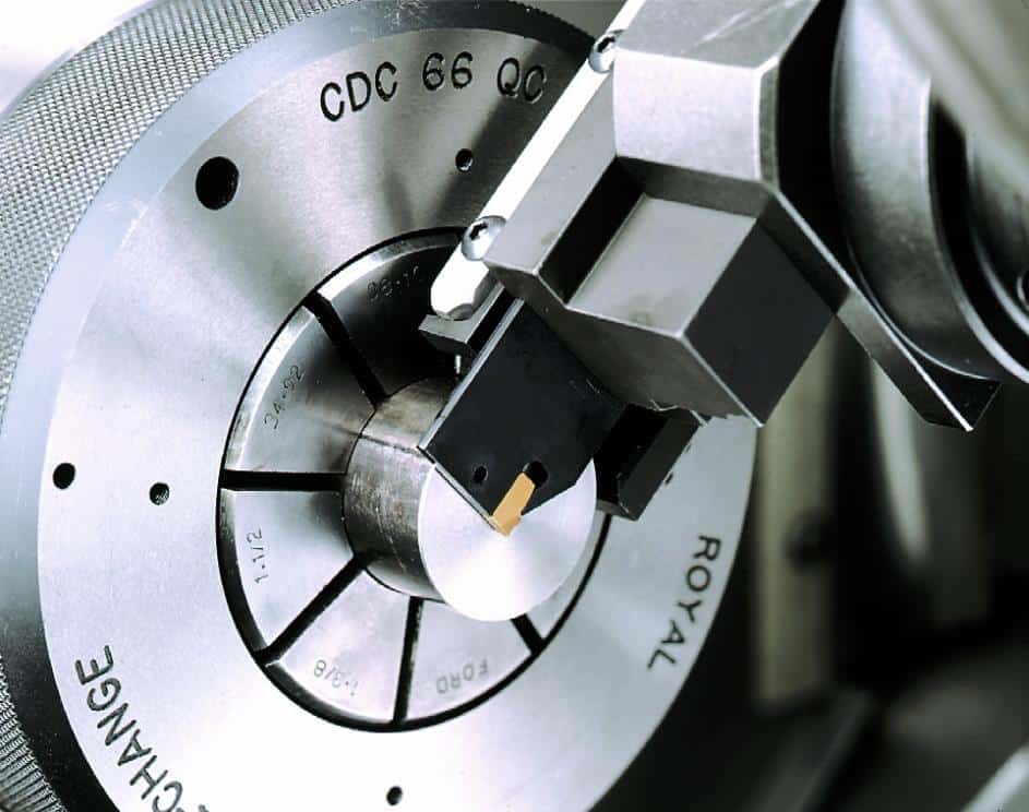

Lastly, it is sometimes advantageous to mount the parting blade in an unusual place.  Hardinge made lathes that had the blade permanently mounted at a particular offset and actuated separately from the slide.  More practical for a CNC Lathe Turret is a combination Bar Puller and Cutoff Blade such as this one Royal makes:
royalbarpuller1a
Royal’s combination cut-off and bar puller via MMSOnline…
If you need a bar puller, that’s a really neat way to save a station on your turret.

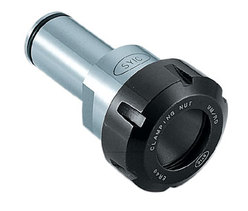

#5 Drill and Tap Holders
First up on our ID tools would be holders for twist drills, spot drills, center drills, taps, reamers, and the like.  These tools all have round shanks, some of them don’t change often (you’d probably leave a center drill or spot drill on the machine most of the time), while others are very size dependent and are changed for almost every job.  Let’s talk first about how these tools are commonly held.  The most straightforward thing is to use collet chucks, typically ER’s, but not always.  Keeping a station or two set up with an ER Collet Chuck makes it easy to swap out the drill quickly as needed.  You could use collet chucks for all this sort of tool, but as mentioned, spot drills and center drills don’t change much.  Use a little larger size (unless your work is mostly very small diameters) and it’s once-size-fits-all.  For those tools, it may make more sense to use a bushing holder.  For those holders, the bushing is typically purchased (or made, you do have a lathe you know) without a center hole.  To make the hole accurately, it’s usual drilled in situ.  Position the tool where it will be used, put a twist drill into your lathe chuck, and drill it out that way.  Finish with reamer if desired, or use a “poor-man’s” reaming process–an undersized twist drill followed by a twist drill that is right on size.
Typically you’ll use a round shank ER Collet chuck and use the in situ method with a bushing to get it installed concentrically with your spindle.

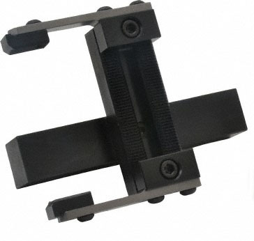

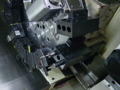

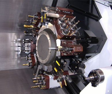

Another approach is to put multiple tools in each turret position.  This essentially combines gang tooling with a turret.  These combination approaches can put a lot of tools into a relatively small space:
Cramming a lot of tools into a turret…
Even just doubling tools at one or more stations may make the difference for you in getting enough Tooling Stations for your job…
