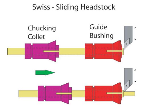

Swiss Lathes
In some ways, that almost means that the "competition" between Gang and Turret Lathes is a bit misleading.  Perhaps a better "competition" would be gang lathes versus Swiss machines.  The Swiss Machines use a guide bushing and turn from the end towards the headstock so that the work is always well supported with very little overhang to deflect:
Swiss-style guide bushing with chucking collet setup.
In exchange for more cost, complexity, and the requirement of barstock that is more expensive because it has to be compatible with the Swiss bushing setup, a Swiss machine can turn parts that would be too long and spindly to do with a Gang Lathe.
