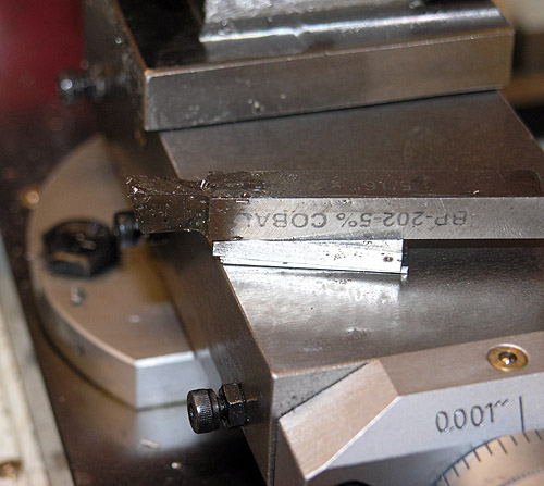

A cutoff tool ground from HSS…
I ground one parting tool from HSS-Cobalt, which is shown above. It is about 1/8″ wide, which is pretty wide. A thinner parting tool would have been better. You have to remove more material to make a parting tool than most any of the other blade types. This was on a 1/4″ blank and it probably took me a good 15 to 20 minutes of grinding to get it right. Notice there is a lot of positive back rake on the tool as well as plenty of side relief.
Keep in mind that parting off is a fairly demanding operation on any lathe. Rigidity is extremely important. I find that locking my carriage is an essential step to take in order to maximize rigidity. Another important step is to make sure the cutting tip of your parting tool is right on the center line of the piece you are parting. Make sure your tool is exactly perpendicular to the axis of rotation as well. Another thought on parting is to try to do your parting as close to the chuck jaws as possible. This is another way to maximize the rigidity and make things go smoother. I have heard some authorities suggest you can’t part more than 1/2″ from the chuck jaws, but I’ve had no trouble parting 1″ or 2″ out at all.

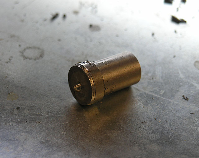

Parting off always leaves a little nub. Minimize it by proper adjustment of tool height!

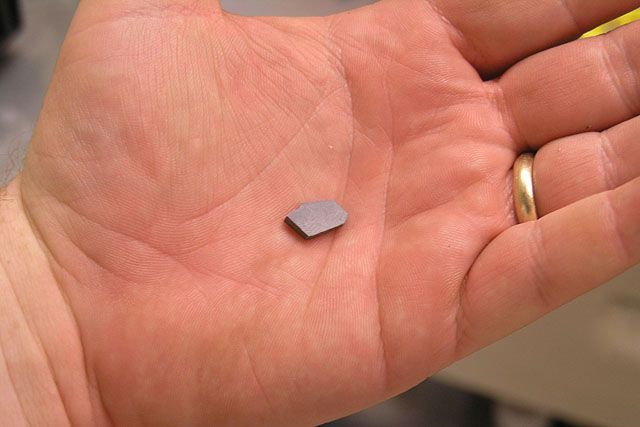

parting tool inserts
The GTN-3 Carbide Parting Tool Inserts are odd looking little gizmos…

– GTN-3 Carbide Inserts. I ordered 10 so I would have spares on hand.

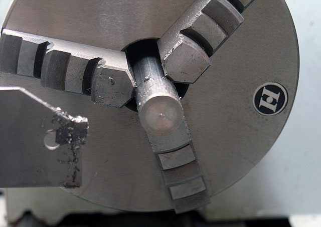

Tune Up Your Parting Blade
While I love the little parting blades mentioned above, I find they benefit from a little “tuning up.” Here’s how I do the tune up:
First, use the radius on the edge of your grinding wheel to put a little positive rake in the blade. This greatly reduces chatter on a lot of materials. Easy does it, don’t take too much off!
Next, take on of those inexpensive pocket diamond hones and use it to make the tool really sharp. I QCTP holder with the tool on its side on a flat surface, and stand the hone up on it’s side. A couple of swipes as shown are all it takes to make the blade really sharp!

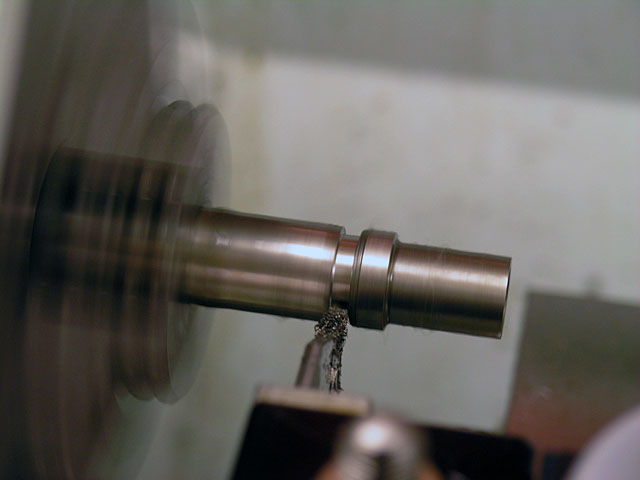

Turning with a parting blade makes it easy to get nice square shoulders if you need your smallest OD between two larger OD’s. Here, we are about to plunge the blade and we’ll be turning to the left shoulder that’s visible. Don’t try too much depth of cut. A sure sign of trouble is a build up of material on the part at the cutting point. Eventually something will break if that’s happening–take a shallower cut! For this little brass part 0.010 to 0.015 on the dial (0.005 to 0.0075 actual DOC) worked well and gave a decent surface finish…
Here we are starting a pass. You can see the positive rake radius in these two pictures…

How to Minimize the Nib / Nipple When Parting
There are several options:
First, setting proper tool height will minimize the nib.
Second, if the tip of the parting tool is ground at an angle, it will minimize the nib further.  Often enough to avoid having to face it off in a second op.
