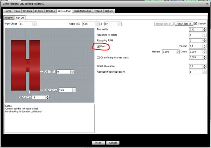

If you don’t want to bother learning and remembering how to use G75 for peck parting, or if your machine doesn’t have G75, it’s can still be very easy to set up for peck parting. The easiest way I know is to use a Conversational CNC capability like G-Wizard Editor’s to do the programming for you. Here is what the screen looks like in G-Wizard Editor:
It’s easy to set up peck parting in a Conversational CNC program like G-Wizard Editor…
I’ve circled the peck option in red. There’s a “Peck Z” parameter block to the right that gives you full control. Peck Z determines how far to cut in Z before pecking. Retract is how much to retract–just a little will break the chip. And Dwell is how long to wait while retracted to give the chips a chance to be carried away. Very simple and straightforward.
The Conversational CNC function programs a complete peck cycle. There’s even an option for a finish allowance and a slowdown at the end so the part will fall of nice and easy and not be flung into the enclosure wall, possibly dinging up your part.
