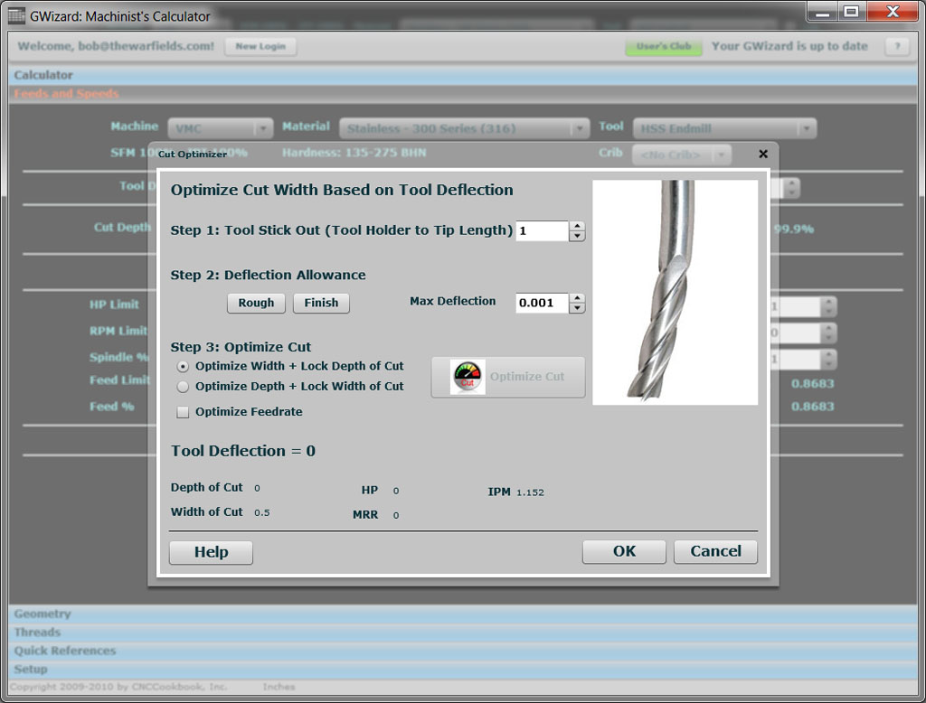

Imagine that your spindle is pumping horsepower into the cutting tool, and in the process of making chips, that horsepower creates forces that act on the cutting tool and the workpiece. With enough force, the cutting tool deflects. Remember, chatter is a resonance phenomenon resulting in machining vibration. Imagine applying force to one tine of a tuning fork, thus deflecting it. If you release that force, the tine vibrates at its resonant frequency. Same thing with your tool. When the flute on the cutter hits air, the force on that “tine” is released.
Now let’s say you minimized the deflection on the tine. Below some critical value, you’d hardly hear it vibrate at all. That’s the point of controlling tool deflection. The big tooling manufacturer’s tell us that tool chatter can start to cause problems when tool deflection exceeds 0.001″. That’s not to say you won’t have a few problems with deflection short of that, but the more you exceed 0.001″, the more tool chatter becomes a certainty.
Using our G-Wizard software’s Cut Optimizer, you can optimize your cut width or depth of cut to reduce cutting forces and keep deflection below that critical 0.001″ value.
G-Wizard’s Cut Optimizer reduces cutting forces to minimize tool deflection, which will cut tool chatter way down…
If you’re curious, sign up for our free 30-day trial right now and give G-Wizard a try.

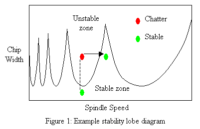

It turns out that we can make a pictorial representation of the likelihood of chatter for a certain combination of CNC machine, tooling, spindle rpm, and so forth. This representation is called a “Stability Lobe Diagram”. Here is a schematic representation of a Stability Lobe Diagram showing regions where chatter in machining occurs:
Think of the chip width as a measure of how hard we can push the CNC machine at a given spindle speed. Note how narrow the stable zones are. This diagram is telling you that the machinist that understands their cnc machine’s stable zones has found the profitable high performance “sweet spots” for machining. The official term for a sweet spot is that it is a “Stable Milling Speed.”
Imagine the poor machinist that fires up their cnc machine at a set of feeds and speeds that correspond to one of the troughs, but is still in the unstable zone. That poor machinist is having to run many times slower than his competitor who has made chatter a science and he probably doesn’t even understand why. You better believe the big successful machining operations have figured this stuff out and built it into their daily productivity. For everyone else, it is the luck of the draw whether your particular combination hits a peak or a valley based on the feeds and speeds you’ve chosen.
Consider that “faster” isn’t always, well, faster. Take that last trough. Suppose our feeds and speeds calculator tells us to run at a spindle speed right in that trough. We’ve bought the ultimate killer solid green unobtanium coated endmills, we stuck them in our bad-mamma-jamma model 2000XL 26-axis machining center, and we turned the loud knobs all the way up to 11. We are gonna make us some big time chips now, right?
Nope.
You’re gonna be in that unhappy chatter trough taking light cuts and cursing all the way. But, if you knew where that peak was just to the left or right of the trough, man you could kick it up about 5 or 6 notches and then you’d be making some chips.

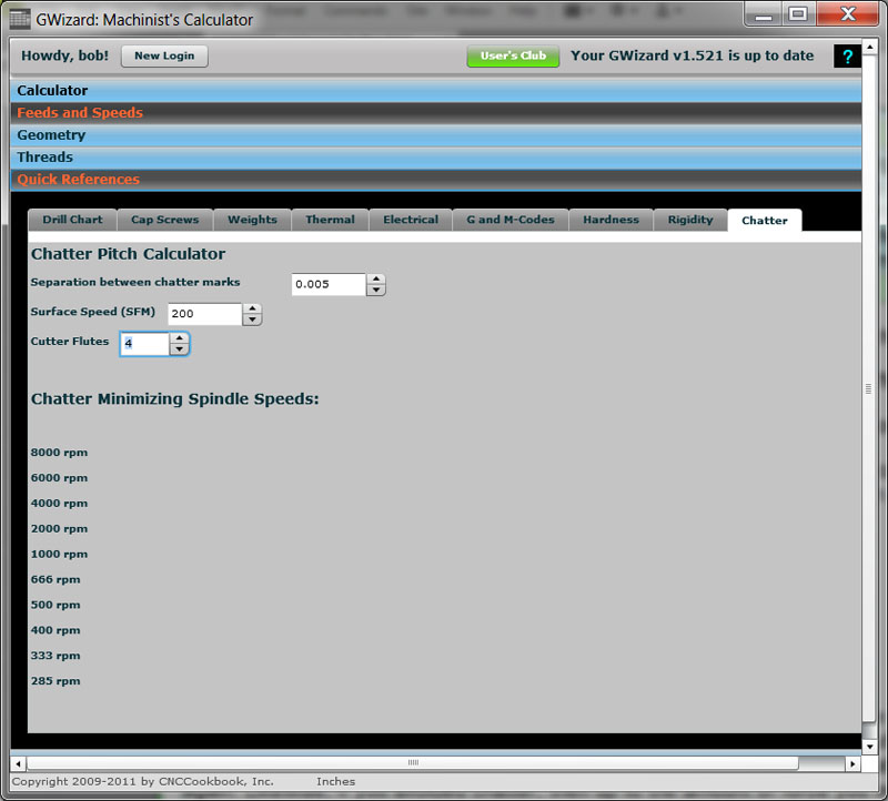

Using G-Wizard’s Chatter Pitch Calculator for Stable Milling Speeds
Let’s put all that Chatter Mapping and Stability Lobe Diagram stuff on hold for a minute. You have a chatter problem right now and you don’t have time to go doing a lot of research. You’re in luck, because our G-Wizard CNC Calculator has a Chatter Calculator that can help out. Let’s go through a typical example of its use:
You just ran a cut on a job and the whole shop was holding their ears from all the squealing. You need to know three things:
1. Your surface speed.
2. The number of flutes on the cutter.
3. The chatter pitch, which is the separation, peak to peak, of the “wave marks” or each chatter mark on the workpiece.
Let’s say you had 200 SFM surface speed, a 4 flute cutter, and 0.005″ separation of each consecutive chatter mark. Here is what G-Wizard’s Chatter Calculator would show:
G-Wizard Chatter Calculator…
Note the table labeled “Chatter Minimizing Spindle Speeds”. Those are the rpms that minimize the chatter frequency that caused the chatter you just experienced. In other words, those numbers represent the spindle rpm that is least likely to excite the chatter in machining. Those speeds will actually interfere with the chatter and break it up to minimize it. They’re the tips of the peaks on the stability lobe diagram. The chatter experts call them Stable Milling Speeds.
Pick the one that is closest to the speed G-Wizard recommends on the feeds and speeds calculator. You’ll have to make a determination if the best one is faster than GW’s recommended rpm–if it isn’t too far above and you have confidence in your tooling, go for it. Remember that the higher rpms can reduce tool life if you get going too fast.
That’s all there is to it!
If you’ve never played with G-Wizard, sign up for our free 30-day trial right now: you’ll be glad you did.

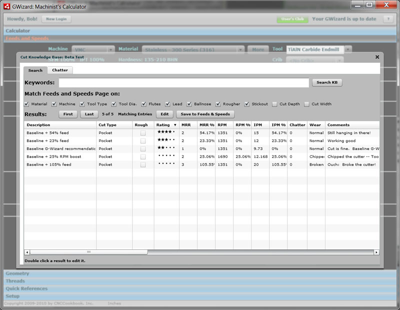

Creating a Chatter Map via Cutting Knowledge Base
Any time you find a combination that chatters, your first reaction is to be unhappy. It interrupts your work and it is a problem to deal with. Try thinking about it another way–when you get a combination that chatters, you have found something valuable. You’ve plotted a point on your stability lobe diagram. If you’re able to run the G-Wizard Chatter Calculator, you even have a list of spindle speeds that will minimize chatter for that combination.
The trick with all that is getting organized and having the information at your fingertips when you need it. If it’s written on the back of a greasy napkin that used to sit in a particular corner of the shop or your desk, chances are you’ll be starting over from scratch and you’ll soon be cursing chatter again. What you need is some kind of organized database for the information. The machining world has such a thing–it’s called a “Knowledge Base” and is part of the discipline of “Knowledge Based Machining.” Some high end CAM packages like Esprit have it and some shops have built their own Knowledge Bases using everything from pencil and paper to simple databases like Microsoft Access.
At CNCCookbook, we’ve built an easy-to-use Cutting KB (KB is short for “Knowledge Base”) into our G-Wizard Feeds and Speeds Calculator. Using it is pretty simple. Dial up the parameters for a cut, and then press the “Search KB” button. Up will pop a list of similar cuts stored in the Knowledge Base. You’ll be able to see if you’ve already been able to do better than the cut you just dialed up, so you can use the better cut instead. You’ll also see whether you’ve just selected a combination that chattered, delivered a poor surface finish, or was bad for tool life in the past. The Cut KB stores your shop’s Best Practices that are based on how you operate so that the information will be right for you.
Here’s what the Cut KB search screen looks like:
G-Wizard Cut KB Search Results: Right down to a rating system by stars…
Suppose there is nothing in the Cut KB, or you’re trying to push the envelope?
No worries. Go back to your parameters in G-Wizard and either punch them up a bit or use them as is. After you make the cut on the CNC machine, remember to go back to G-Wizard and record the result. Just bring up the cutting parameters you used and press “Add to Cut KB”. Now the data is recorded for the next time. And remember, it is a good thing when you can add chatter data, broken tool entries, and anything else that helps you find the edge of the envelope.
For more on the Cut KB, check the following links:

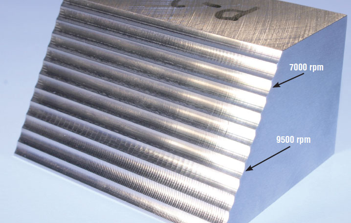

Systematically Measuring the Edge of the Envelope

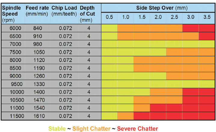

One of the best articles I’ve seen on this subject was a piece called, “Chatter Control for the Rest of Us,” by Peter Zelinski. It’s been reprinted in a lot of places and you can even buy it on Amazon, but it started in Modern Machine Shop. Just Google for that title to track it down.
This piece was created by Siemens/UGS, and describes a very simple methodology for mapping out the sort of information you’d want to put into the Cut KB so you know the Stable Milling Speeds for your best combinations. The idea is to create a test for your CNC machine + tooling combo that produces a test piece like this one:
Stable Milling Speed Test for Chatter…
It’s readily apparent by inspection that some passes have a lot more chatter than others. You can clearly see the Chatter Marks on each pass.  From this, you can determine the best speeds. This particular test they called out 7000 rpm and 9500 rpm as Stable Milling Speeds that minimized the chatter marks in machining. The successive passes for the test were laid out like this:
chatter in machining stability lobe diagram
As you can see, they hold chip load and depth of cut constant. The feedrate is based on the rate needed to maintain the desired chip load. Since too much chip load breaks tools quickly, choose one that is at the high end of what you’re generally successful with for the exercise. They then proceed to vary the spindle speed and the cutting width (side stepover). The colors indicate how much chatter they encounterd. You get the idea how to do the experiment. In a few hours you can build a pretty good map of a CNC machine and tooling combination for your shop.

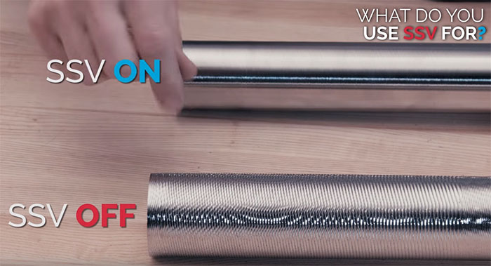

Haas SSV: Dynamically Varying Spindle Speed to Control Chatter
If you still have any doubts that chatter is a resonance phenomenon or that spindle speed changes alone can minimize it, check out Haas SSV.  It’s a feature that dynamically changes the spindle speed in order to kill chatter.  Constantly changing the speed means chatter can’t lock in and amplify its resonant frequency.  The results with and without Haas SSV are striking:
haas ssv turning chatter
SSV can really help control chatter when turning…
In the video below, Haas describes their “SSV” (Spindle Speed Variation) feature to control chatter.  They also give the best discussion I’ve seen of how diameter affects surface speed when turning (smaller diameters have to run faster just to achieve the same surface speed), as well as a discussion of CSS (Constant Surface Speed).  Great set of topics for anyone involved with CNC turning, check it out:
