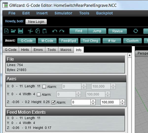

If you simulate some G-code, GW Editor captures a bunch of information about that G-code and puts it on the Info tab.  Here is the Info Tab for the Home Switch Rear Panel engraving sample file, for example:
GWizard software interface screenshot: gray background with 3D graph, toolbar icons, and tabbed menu.
Info Tab for HomeSwitchRearPanelEngrave...
The Info Tab provides a bunch of vital statistics for your G-code program.  Number of lines, number of bytes of code, the total travel for each axis as well as the minimum and maximum values, travel at feedrates, range of Feeds and Speeds, and a whole lot else.  As you can see from the backplot on the right, this is sheet work.  I used a piece of aluminum about 3/16" thick to make this panel.  What that means is I don't want the cutter going too much deeper than that.  As is my usual practice, I designated part zero in the Z-axis to be the top of the workpiece.  So, anything about zero is cutting air and anything below is cutting into the material, or possibly into my machine or fixtures if I'm not careful!
Let's take a closer look at the alarm setup, and let's set an alarm for Z = 0.  That's not actually what we want, but it'll make it easier to see what's going on with the Soft Limits.  Here is what it looks like:
GWizard G-Code Editor screenshot with Alarm settings page.
Soft Limit Alarms are set on the Info Tab...
I've enabled the Soft Limit Alarm for the Z axis with the checkbox, and I am just going to use 0.0 as the minimum and 100,000.0 as the maximum.  You could do more if you wanted to take the time, for example, set the maximum to be the limits of travel or some such on your machine.  I'm also not bothering with X and Y.  There's nothing really to crash into there on this job.  If I was running a 4th axis job, I'd probably want to set those limits as well.

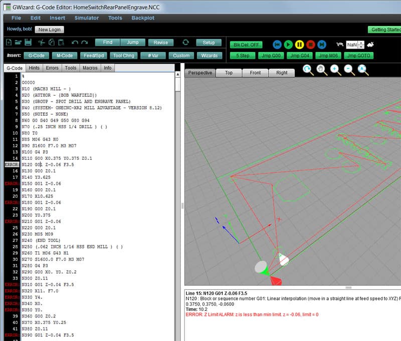

Now here's what happens if we hit a limit:
CNC Cookbook website screenshot showing a soft limit alarm with red "ALARM" label and error message.
Any line that ends with the cutter having broken a soft limit gets a limit error...
Any line that ends with the cutter having broken a soft limit gets a limit error.  You can see the error on the lower right in the hint window.  By only flagging the lines where the cutter ends with a limit error, it is easier to see which lines are starting the bad behavior.  In this case, we set the limit at 0.0, so every line that is cutting some material gets an error.  In practice you'd set it for the actual limit you want to enforce.  It's a question of how close you're willing to let the cutter come to the sensitive parts of your machine and fixtures.  I like to use a figure of 0.1" or 1/8".  That's plenty close enough and is easy to measure with a rule or tape measure.  It doesn't take much time on a job to identify what the proper limits are.  In some cases they don't change.  The top of my vise pretty much stays put.  I just need to figure out how far below part 0 the top of the vise is to set the limit.
