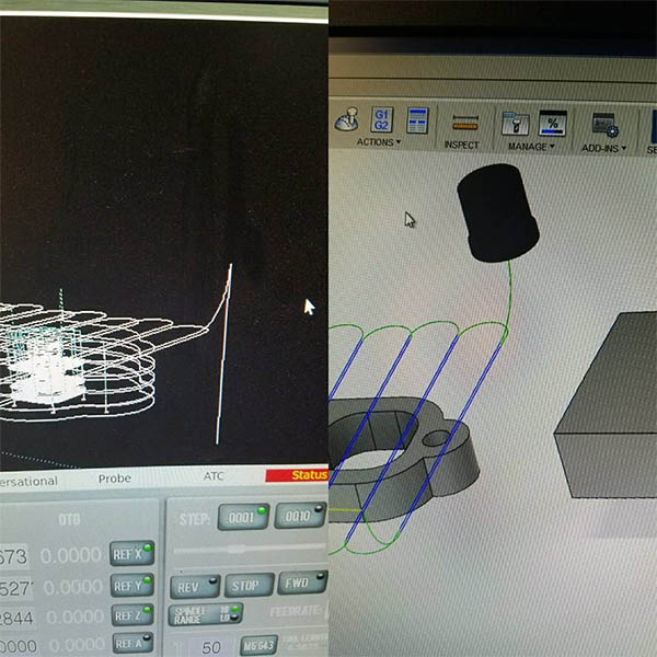

I was recently reading a post on one of the boards and came across a fellow who was having a problem with Fusion 360:
Control view on the left, CAM on the right: see the problem?
The controller view of the toolpath is on the left and the CAM view is on the right. Do you see the problem?
If you run that program, at the end of the toolpath, the cutter is going to arc up and then slam right back down deep into your part and possibly a vise or your machine table. Ouch!
This stuff comes up all the time with most any CAM software that's available-it's not just a Fusion 360 issue. All software has bugs, and the more complex the software, the more likely there are problems lurking. Given that CADCAM is some of the most complex software CNC'ers will ever use, it's no wonder that these glitches can show up.
As this particular fellow said, "I've got parts to get out and then this shows up." This sort of thing always happens when you don't have time to deal with these CAM glitches by trial and error.
By the way, isn't it interesting that the CAM simulation doesn't show the problem? This is the thing about many CAM simulators. CNC'ers think, "I don't need simulation, my CAM software has it built in." Unfortunately, for 90% of CAM software, you are not getting a true second opinion on your G-code. That's because most CAM simulators work from the geometry not the G-code. That leaves a world of room for the same bug that trips up the G-code generation to trip up your program and not be visible in the CAM's simulator. If nothing else, an error of some kind in your post will be totally bypassed.
If you don't get a true second opinion, using a simulator that goes purely from the G-code output by your CAM, you're vulnerable to these problems. In a production shop, if you wait to see the problem when the G-code is actually on your CNC machine, you have tied up that machine needlessly when it could have been doing something else while you fix the problem.
So how do you fix these problems?
Well, for many CNC'ers, they try redrawing or re-CAMming the part in a couple of different ways. Maybe the problem goes away or maybe it doesn't, but it sure is painful to do this by trial and error. Perhaps you get on the boards like this CNC'er did and ask for help. In this case, he drew a simplified but similar part and ran the same kind of toolpath and there was no problem. He concludes there's something about the drawing, but what?
A number of the more experienced CNC'ers on the thread pointed out that he should just edit the G-code and move on with his work. It's actually the quickest easiest way to deal with this kind of problem if you check your CADCAM work and nothing is obviously amiss. Especially when it is just one errant move.

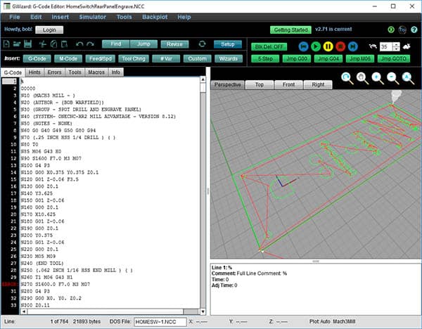

Here's a screen shot of G-Wizard after loading a simple G-code program I used some time ago to make a little panel for the connectors on a CNC Control I built:
Panel engraving G-code...
This particular program was generated by CAM software called OneCNC. I use several CAM programs, BTW.
Most CAM G-code follows a simple structure:
- There's an introductory block of code, often called a "Safe Block", whose purpose is to put the machine into a known state.
- There's a series of code blocks for each feature of the part.
- Each feature block consists of the following:
- Comment, usually tells you the tool
- Tool change + Feeds & Speeds + Spindle & Coolant Start
- Rapids motion to start of feature
- Machine the feature
- Retract to safe height and shut down spindle and coolant
- Rinse and repeat for each feature
- There's some code at the end of the program that shuts everything down.
That intro "Safe Block" looks like this:

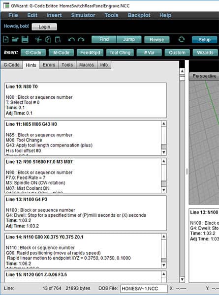

Like I said, G-Wizard decodes that stuff. If we put the cursor on a line, the area below the program plot tells you what it means. That area is called the "Hint" because that's just what it is-hints about what the G-code is doing.
Here's the hint for that crazy complicated line at the bottom:
Line 8: N60 G0 G40 G49 G50 G80 G94
N60 : Block or sequence number
G0: Rapid positioning (move at rapids speed)
G40: Tool cutter compensation off
G49: Tool length compensation cancel
G50: Reset all scale factors to 1.0
G80: Cancel canned cycle
G94: Units per minute feed mode. Units in inches or mm.
Time: 0
Adj Time: 0
See how it takes each element of the line and tells you what it is?
N60 is a block or sequence number. Okay, you were probably starting to think those N numbers were something like that.
G0 is "Rapid positioning", which means "move at rapids speed".
G40 is "Tool cutter compensation off", and so on.
There's probably still a lot there you don't understand, but surely those explanations make more sense than just N60, G0, G40, and the rest?
