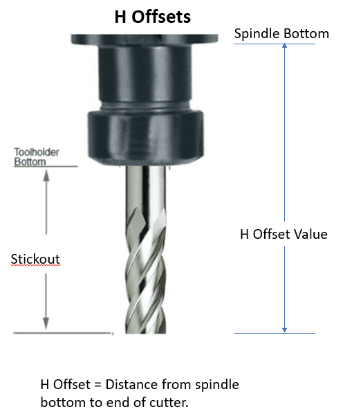

What are the G-codes for tool length compensation?
Machining diagram illustrating H Offsets concept with labeled toolholder components.
Tool Length Compensation involves the G43, G44, and G49 G-codes, plus the H codes. The H codes tell the machine which tool length offsets to use.
G43 tells the machine to begin applying length compensation by adding the current length offset (selected by the H code) to all Z axis positions. It assumes a positive tool length.
G44 is the alternative to G43. It tells the machine to apply tool length compensation by subtracting the current length offset from all positions. This alternative is rarely seen in practice.
Note that H0 is a special H code. It specifies a length offset value of zero.
Finally, G49 will cancel tool length compensation.
