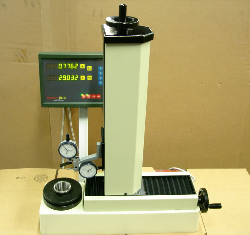

Setting Up Tool Data from a Tool Presetter and G10 G-Codes
Suppose you’ve got a Tool Presetter. Here’s a typical unit:
A Tool Presetter…
You put the tool in your toolholder, drop the tool holder into the presetter, and measure the tool height and diameter using the presetter. A really nice presetter will then let you push a button and it will output a simple G-Code program that uses G10’s to transfer the values to your CNC Machine’s tool table so you don’t risk making a data entry error doing it manually.
But, you could also write G10’s yourself in a little code snippet to set or change Tool Offsets if you needed to.
