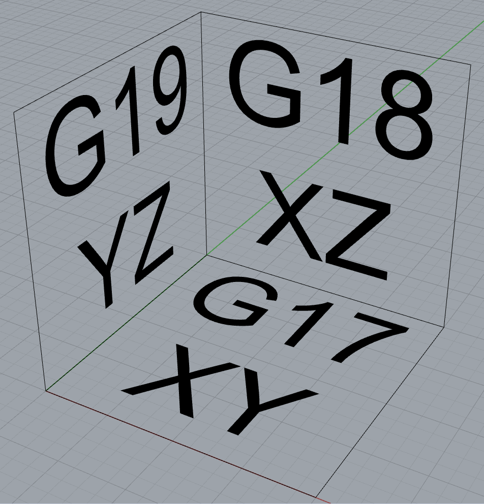

It’s convenient to refer to planes for various purposes. A plane is a flat 2-dimensional space defined by two axes. For example, the default plane on most mills is XY. If you draw an arc without specifying a change in the plane, it will be drawn on the XY plane. There is a plane for each combination of the linear axes XYZ.
The G17, G18, and G19 G-Codes select which plane is active.
- G17: XY
- G18: XZ
- G19: YZ
Here is a visual representation of the planes:
Plane selection is modal, so once you have established a plane all future arcs will be against that plane until a different plane selection g-code is invoked.
