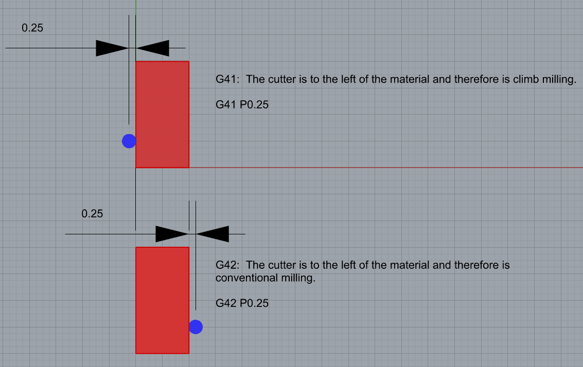

Introduction to G41 and G42 Codes as Tool Radius Compensation Commands
G41 and G42 are G-codes specifically designed for tool radius compensation in CNC machining operations. These codes instruct machines to adjust the programmed path based on offset values associated with specific tools’ radii.
G41 represents left-hand side (LHS) compensation while G42 represents right-hand side (RHS) compensation. When using G41 code, the machine automatically shifts the programmed path to ensure that it lies outside (to the left) of the actual cutting location by an amount equal to the radius value assigned to that particular tool.
Conversely, with G42 code, the machine compensates by moving inside (to the right) of the actual cut location by an amount equal to its assigned radius value. Tool radius compensation codes like G41 and G42 are indispensable in achieving accurate cuts, minimizing programming errors, and simplifying the machining process.
They aid in reducing machine downtime, enabling faster production speeds, ensuring better surface finishes, and extending tool life. Understanding the nuances of these codes is vital for CNC programmers and operators seeking to optimize their machining operations.
Exploring G41: Tool Radius Compensation Left
Detailed explanation of G41 code functionality
G41 is a tool radius compensation command used in CNC machining to achieve accurate cuts by compensating for the tool’s radius. When this code is activated, the control system offsets the tool path to the left of the programmed path by an amount equal to the radius of the cutting tool.
This ensures that the cutter follows a path that corresponds precisely to the intended shape or contour, taking into account any material removed by the cutting edge. The G41 code is typically accompanied by additional parameters such as D (tool diameter) and H (offset value).
The D parameter specifies the diameter of the cutting tool, while H represents an offset value indicating how much material should be removed from the part. Together, these parameters help define and control the compensation process accurately.
How the left-hand side cutter compensation works
When using G41 with left-hand side cutter compensation, every point on the programmed path is offset towards its left. This means that if we imagine a line representing our intended path, we will see that our actual cutting position lies exactly on this line but slightly shifted to its left side. To better understand this concept, consider an example where you want to cut a circular pocket with a diameter of 50mm.
By activating G41 and providing appropriate parameters like D50 (tool diameter) and H0 (offset value), your machine’s controller will offset all points on your programmed circle 25mm to their left. As a result, you will achieve an accurately cut pocket with a 50mm diameter.

Unveiling G42: Tool Radius Compensation Right
In-depth analysis of G42 code features
The G42 code is a vital component of CNC machining that facilitates the right-hand side tool radius compensation. When this code is employed, the CNC machine automatically adjusts its cutting trajectory to account for the tool’s radius on the right side, ensuring precise and accurate cuts.
This compensation helps prevent errors such as excess material remaining after a cut due to an inadequately accounted for tool radius. G42 differs from its counterpart, G41 (Tool Radius Compensation Left), in that it accounts for the right side of the tool.
By specifying G42 in the G-code program, machinists instruct their CNC machines to offset their cutting paths by precisely half of the tool’s diameter towards its right side. This adjustment ensures that the desired part dimensions are achieved by compensating for any inaccuracies introduced by tool geometry.
Understanding the right-hand side cutter compensation method
Tool radius compensation on the right-hand side involves accounting for a milling cutter’s geometry when making cuts along specific paths. Once enabled with G42, the machine will automatically offset all programmed positions by half of the cutter’s diameter towards its right side during cutting operations.
This adjustment ensures that each cut accurately represents intended dimensions and contours without any deviations caused by incorrect positioning relative to the desired cut path. The CNC machine interprets and implements G42 commands efficiently when provided with accurate input parameters.
To enable proper right-hand side compensation, machinists must specify either an R value or an H value after calling G42 in the program. The R value denotes exactly half of the milling cutter’s diameter, while an H value represents an explicit radial offset distance from a reference point or previous position.

Differences between G41 and G42 Codes
Comparative analysis between left and right-hand side cutter compensation
When it comes to tool radius compensation, G41 and G42 codes play a vital role in CNC machining. While both codes serve the purpose of adjusting the cutter’s path to account for its size, they do so in different directions. The G41 code is used for left-hand side cutter compensation, while the G42 code is employed for right-hand side tool compensation.
This distinction affects the direction in which material is removed during cutting operations. In left-hand side cutter compensation (G41), when the cutter moves along an inside contour, the programmed path is offset to the left by a distance equal to half of the cutter’s diameter.
This adjustment ensures that the desired part dimensions are achieved while compensating for the cutter’s size. On the other hand, right-hand side cutter compensation (G42) shifts the programmed path to the right by half of the cutter’s diameter when cutting along an outside contour.

How do you use G41 and G42 in CNC Mill?
If the tool needs to be on the left of the programmed path as it moves away, use G41. If it needs to be on the right, use G42.
What is G41 code in G codes?
G41 is left compensation, and is a form of cutter compensation. Cutter compensation allows you to program the centerline of the tool rather than the edge of the tool.
What is the difference between G41 and G42 G code?
The difference is G41 performs left cutter compensation and G42 performs right cutter compensation. See this diagram for more:
