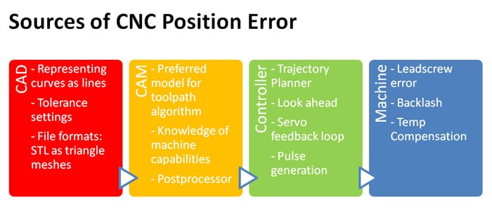

The short answer is that this is caused because there are many approximations and assumptions made every step of the way from your conception, to CAD drawing, to CAM program, to G-Code, to Trajectory Planning in the Controller, to the Servos or Steppers driving the axis, to the leadscrew and other components driving the table, and so on.  There are various techniques that are used to minimize these errors, but it is useful to be aware of their sources, so let’s look at a few of them.  This diagram includes a few examples of each:
Sources of CNC Position Error…
From Conception to CAD File:  CAD Errors
In your mind’s eye, you see a very pure shape.  Circles, cylinders, smoothly flowing lines, all with infinite precision.  The CAD program has to render these notions with more limited means.  Perhaps it can only represent lines, and hence arcs and circles become a series of short line segments that approximate the arc.  Perhaps it can represent splines, but the curve you have in mind is only approximated by the spline.
Some file formats make fairly extreme assumptions.  Perhaps your carefully constructed 3D model, which had smooth flowing curves and other geometries, is being represented by the file format as a mesh of triangles which can only approximate the original model.
In these cases, the CAD program is approximating what you’ve asked for, and there will be errors and assumptions made in that process.  You have a little bit of control over it.  You can choose to use a better CAD program.  There are settings in most of the CAD programs that govern the degree of error their approximation is supposed to allow.
From CAM to G-Code:  CAM Errors
The next step in the journey from conception to making chips is to load your CAD model into your CAM program.  Even if they’re integrated, there may not be a lot of difference in the end result.  The CAM program wants to think about your model in a certain way to do its job.  That certain way may or may not be highly compatible with what the CAD model can actually offer.  If nothing else, the CAM program is applying cutter geometry to the model.  There is no cutter geometry that corresponds to a mesh of triangles, so if that’s what the model offers, the CAM program is going to approximate.
Perhaps the toolpath algorithm itself is doing some sort of approximation of your geometry.  Was it easier for the software engineer that wrote the toolpath code to think of your arcs as a bunch of short line segments?  If so, he will have converted your arc geometry to line segments to facilitate his task.  If he used enough line segments, the approximation will be accurate enough for your purposes.  But, of course, there are tradeoffs.  Fewer segments means faster algorithms.  If you don’t check your default tolerances in the software, you may find the compromise between speed and accuracy chosen is not a good one for the job you have at hand.
Perhaps it was easier to ignore some commands that are available on your machine and controller and go with a simpler post processor.  Many post processors have the option to view arcs as lots of line segments.  Many will simulate canned cycles rather than having to be fully aware of the many varieties available on the many controllers out there (not to mention what optional parameters may be set on each controller).

From G-Code to Commanded Motion:  Controller Errors
We’re almost to the end of the journey as we present g-code to the controller whose job it is to convert that g-code into axis motions to cut our part.  Unfortunately, we’re also entering the realm where we may have the least control over what’s happening and very little understanding of what the controller is doing.
We do know there are important considerations going on down inside the controller, though.  We know, for example, that many manufacturers offer HSM options that make the controller more accurate for High Speed Machining.  We know controllers will perform better if we give them arcs instead of thousands of tiny straight line segments because there is software available that will do arc fitting and machinists report that it helps.  We know there are controllers like the Miceli and others that claim they can double the speed at which your machine processes a g-code program using the same servos and other components.

Mechanical Errors:  The Final Frontier
It’s been a long journey.  I’m reminded of those crazy films in school that show the entire journey of a bite of food through the body or some such.  We are finally near the end.  The trajectory planner on the controller is commanding our stepper or servo to make a move.  Let’s track through the different kinds of errors that accrue here.
First up–servo following error and lost steps.  These are both the same thing in the end of the day:  something happens that causes the motor not to be able to move the axis where it should be.  Could be the force required for the motor to move exceeded its capacity at the particular rpm it was running at.  For whatever reason, a move was commanded and it didn’t happen.  With a stepper-based system, that motion is lost.  The cutter will be off by the amount of the lost steps until such time as we re-home the machine (a good argument to do so frequently in my mind!).  With a servo-based system, the servo will try to get itself back on track.  It will try to speed up when the resistance is reduced to catch up to where it should be, for example.  If it can do that before the following error (total distance it is behind) becomes too great, all will be well, though our cut can be off by up to the amount of the allowable following error.  Presumably we have set that small enough we don’t worry too much.
If we get more than the following error on a servo system, the machine faults and the job is stopped.  This is a good thing because we know we had a problem.  On a stepper based system, it just keeps going.  Given enough lost steps, things can get ugly.  For example, if we lose steps each time we raise the spindle, the spindle will drop lower and lower each pass, which means a deeper cut, which can lead to more lost steps, and you can see how the vicious cycle unfolds.
As an aside, folks that like to say lost steps should never happen in a properly designed and operated machine are just kidding themselves.  It sounds great, but in practice, the forces required to move the machine are too unpredictable.  Every temperature change means the gibs are fitting a little differently which will affect the axis friction.  Use or non-use of a one shot oiler matters a lot.  “Sticktion” means short moves (there’s those darned little line segments versus longer arcs again!) have radically higher friction than longer moves.  I’ve seen on my servo based system how often servo faults come along even when I detune the machine a long ways from “optimal”.  The only difference is the stepper guys never see a fault, they just wonder why their parts aren’t as accurate as they expected sometimes.
There are many other sources of error in the mechanicals.  We may have backlash or other lost motion in our leadscrews.  The leadscrew will have errors in its thread.  The length of the leadscrew (and the other machine components) will change as the temperature changes.  There is a long list of these things.  The more sophisticated the machine, the more it will do to try to overcome these limitations.  For example, the machine may have a set of glass scales mounted to each axis that give it continuous feedback on how far the axis is actually moving.  The factory or service technicians may use a laser to precisely measure how far your leadscrew moves at every position of travel. This creates a leadscrew map that your controller can use to compensate for inaccuracies in the leadscrew.  The machine may have temperature sensors located at various places to help it compensate.
