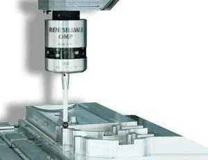

I want to start with the Reference Artifacts because I found RAMTIC looking to see how to use in-process probing to compensate for temperature effects. Here is the amazing thing: given an acceptible amount of repeatability, a machine can use a probe to increase its accuracy. This is done using "reference artifacts". A reference artifact is something you've made up to measure that mimics your part's critical dimension in the ways that matter for accuracy. The artifact has to be calibrated, so you know it is of the proper tolerance. And it has to be made with the same features, properties, and materials as the part. The artifact is then used to take relative measurements versus the part's features with the probe.
Let's say you decide to calibrate after each toolchange, after each part, or perhaps on some periodic interval such as hourly. Using in-process probing routines in your part program, you measure the key features of the reference artifact and compare them to your part. You can then have macros in your G-code apply offsets and scaling factors to adjust the program based on the known dimensions of the artifact. How does that work?
- The artifact is the same material as your part, so its thermal expansion properties are similar. This compensates for the temperature of your shop and any temperature change your coolant is bringing to the workpiece and artifact.
- The difference in the artifact's apparent probed dimensions and known reference dimensions also account for thermal expansion of your machine.
There are a number of other ways reference artifacts can dramatically increase accuracy. For more details see, "Break the Accuracy Barrier", another MMSOnline article about probing.
I love the reference in the article to "funny tapes." These were CNC programs that were hand-tuned to the peculiarities of particular machines and jobs to compensate for errors. Reference Artifacts are a much simpler and easier to manage approach to the problem. For more on thermal expansion, check out our free thermal expansion calculator.

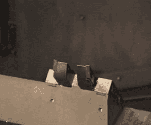

Turning on a Machining Center and The Pallet Loading System
There's a great video on MMSOnline that shows the RAMTIC system being used for turning on a VMC (yep, you can use your milling machine as a lathe). The parts are mounted on toolholders, they come in via a rail system to the VMC, the spindle descends and loads one up, and it is turned using standard indexable lathe tooling. The pallet of toolholders and the lathe tools look like they're mounted on some kind of dovetail railing that loads into a 4th axis. Perhaps the tooling and the workpieces are on separate dovetails indexed in that 4th axis-it's hard to tell from the video.

I will speculate that even probing reference artifacts that are standards but are not exactly the same dimensions as your key job features may be valuable. Perhaps a separate artifact is not even called for. There may be value, for example, in probing the vise sitting on your table. But what about, for example, a set of vise jaws made of your workpiece material (steel for steel jobs, aluminum for aluminum jobs, etc.). Mount the jaws, measure the key dimensions in X, Y, and Z with a micrometer, and enter those into your G-code program. A set of probing macros can then probe the jaws at points you designate and adjust for thermal effects on the job. That and a toolsetter on the machine might just make a big difference.
