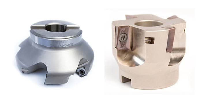

First, what are we talking about when we say 45 or 90 degrees?  The answer is fairly obvious from the photo above comparing two Glacern cutters.  Take a look at the angle of the cutting edge on the inserts.
Yes!  The angle is the angle of that cutting edge-45 degrees for the cutter on the left and 90 degrees for the one on the right.  That angle is also called the lead angle of the cutter.

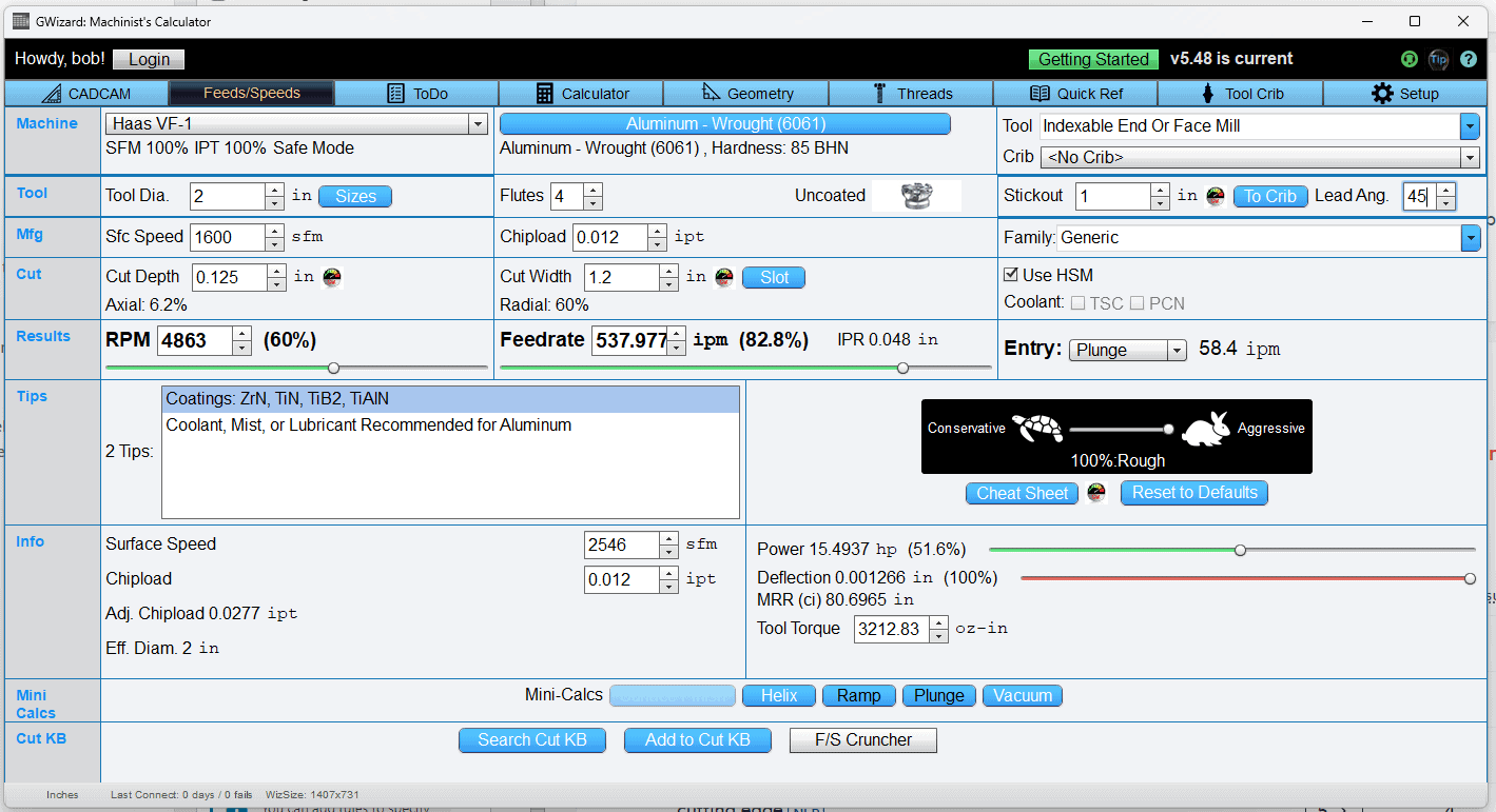

Here's a typical cut set up for 90 degree Face Mills / Shell Mills:
GWizard: Machinist's Calculator tool screenshot.
G-Wizard set up for a 90 degree face mill...
I selected my machine, workpiece material, and indexable tool type.  I'm modeling a smallish 2" diameter face mill with 4 inserts, and I have set the Lead Angle to be 90 degrees.  My Cut Depth is 1/8".
I did do a couple of jazzy things.  First, I'm doing a 60 percent width pass.  This will give a better finish and go easier on the inserts in tough materials than a full width pass.  Second, I have specified this as an HSM cut.  That's HSM for "High Speed Machining."
I can do that since I will use a toolpath that arcs gently into the cut and I will arc the end of each pass to avoid a sharp corner and also to avoid completely leaving the cut.  Those are CAM toolpath tricks that can really help you out on tool life, surface finish, and in this case, they let you opt for a big increase in feeds and speeds too.  If your CAM won't do those things the Conversational CNC Face Milling Wizard in G-Wizard Editor will do them very easily.
Now, we can check out the 45 degree face mill / shell mill just by changing the lead angle to 45.  Let's assume every thing else stays the same, here are the results:
Machine shop software interface.
G-Wizard for a similar 45 degree face mill...
Wow!  Check out that Material Removal Rate:
Now we see why the 45 degree models are so popular-that's more than 40% more material removed.  That's definitely going to pay for the new face mill pretty quickly if you're using it for very many parts.
Note that it's all down to the increased cutting speed (feed rate) possible with the 45 degree lead angle.

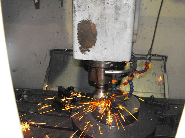

Here's a 45 degree lead facemill slogging right through a weld-they are a little tougher than 90 degree face mills!
