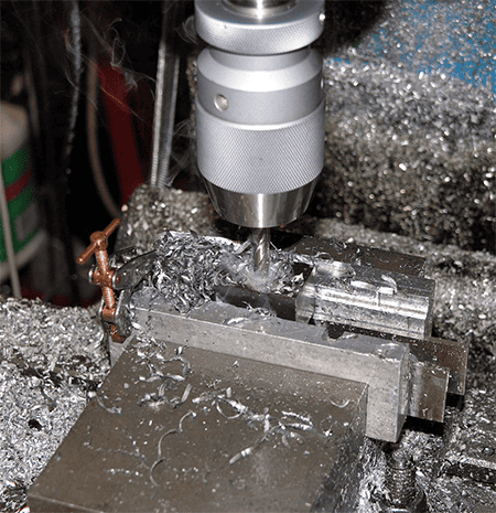

Metalworking drill bit or milling cutter attached to machine, with metal shavings nearby.
In metalworking, metal swarf refers to the leftover metallic chips from machining. The term "swarf" has an interesting history. In Middle English, "geswearf" means "iron filings" or "rust." In Old Norse, "svarf" means "metallic dust." In Proto-Germanic, it means "shavings" or "that which is rubbed off," as well as "to mop, wipe, or rub off."
