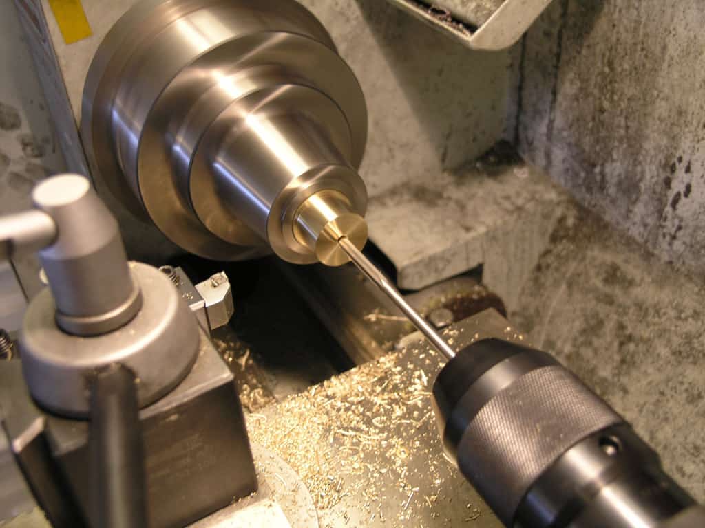

Drilling Tools
Tailstock mounted drill chuck is being used to ream this bore…
Drilling tools on a lathe reverse the standard drilling process by spinning the workpiece instead of the drill bit. This unique setup allows for precise hole creation in the rotating metal.
