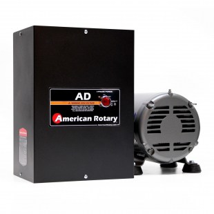

My preparation for my lathe started before I even received it.  I had gotten the exact measurements for it, and cleared all the space I needed for it to have a home.  I also did all of my pre-wiring.  The Automate brand machines all require 3 phase power, so that meant that I was going to be getting a Rotary Phase Converter.  Automate gives you a nice price on a rotary phase converter from American Rotary.
I have never used a Rotary Phase Converter before, so don’t really have a lot to compare to base an opinion on it, but I can tell you that the company is great to deal with.  While not even a customer yet, they put me through to their tech support who helped walk me through understanding the process of wiring it.  The instructions they provide are very decent as well, but I was just “making sure” I understood it all.  Once I actually received my delivery, hooking up the power was fairly simple and straight forward.
One thing I did order from them directly was a 3 phase circuit breaker that was designed to mount right in the control box for the Rotary.  It was about $100, but to have that extra level of protection is well worth it.  It’s also nice, because you can use that breaker to kill all power to the lathe should you need to work inside the electronics cabinet.
By default, the 2 of the 3 legs of power (the 2 lines provided by your electrical service) are piped directly into the machine it’s connected to, and the rotary only generates the 3rd leg of power.  So be warned, even if you have the rotary off, you still have 2 legs of power that are still live going into the lathe.

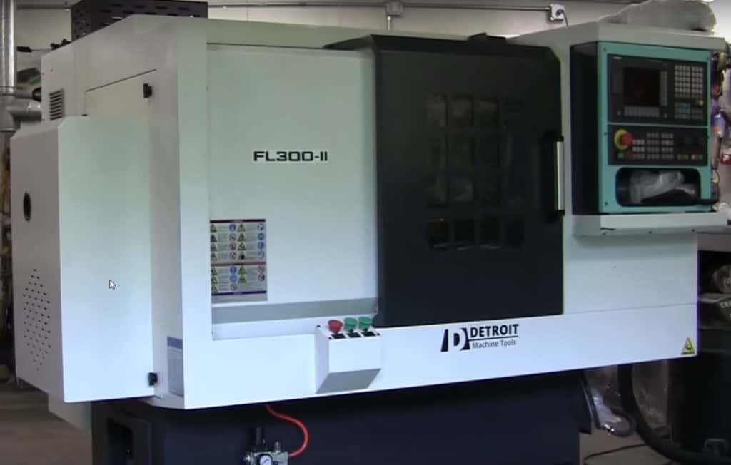

They ship the unit with some locking brackets bolted into place so that the ZX table doesn’t move during shipment.  Just a few bolts, and those were removed.
Front view of the lathe table showing the yellow lock down brackets.

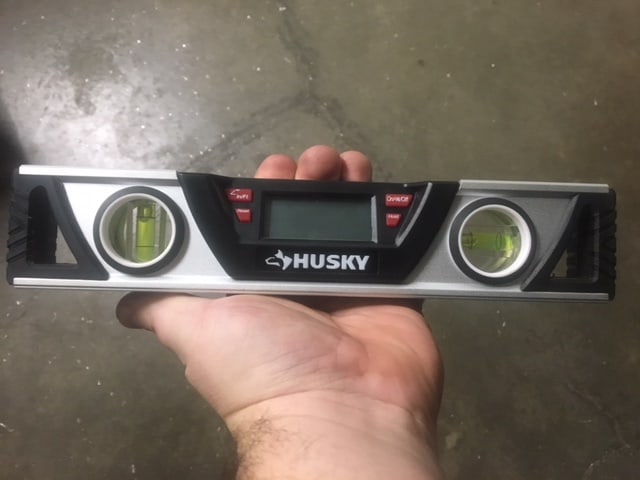

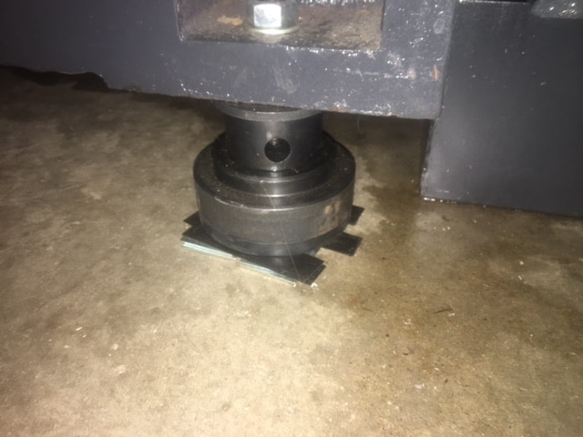

The next thing I did was get the machine moved into place.  It was a lot of slow movement and minor adjustments in position.  The new pallet jack made it very easy.  Once the lathe was moved into place, I figured it was time to deal with leveling the machine.  Now, I don’t have a fancy level like some riggers use, but I found this little gem to be a really nice tool and got me to a “level” I was comfortable with.  (Pardon the Pun)
The level goes in 1/10th’s of a degree. I used the pallet jack to lift the lathe, and then I put various shims under the feet until I was dead on level in X and Z.  I actually used some of the metal bands as shims along with some thicker stock that I had laying around.  Maybe it’s wrong, but it works, and after 4 months, my lathe is still level on both axes.  I know that those are leveling feet, but I was simply not able to get them to adjust as much as needed, or even work as intended.

At that the machine booted up, and I spent the next 30 minutes digging through the manual as I had no clue what to do!  I wound up calling Automate as I couldn’t find the startup procedure in the manual.  The FL300-II has a Siemens 808d control which I had never used before.  Once I talked to the tech at automate, the startup process for the control is pretty simple:
  1. Press RESET
  2. Press Reference button
  3. Press Z+ button which references the Z axis
  4. Press X+ button which references the X axis
  5. Press JOG
  6. Press the ToolChange button to index the turret
Simple once you know it, but frustrating when you first power up the machine and can’t find the startup proceedure.
