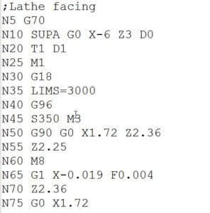

Next step is figuring out how you are going to create a program for your new lathe. And by this, I mean are you going to do 1 of at least 3 different things:
- Hand code your gcode?
- Use conversational programming to write your programs?
- Use a CAM program to generate your gcode programs?
Whichever method you decide to use, make sure you understand the gcode that your system generates. Reading thru the coding section of your manual will never hurt you in the least. If you’ve never taken the time to learn g-code, try CNCCookbook’s Free G-Code Tutorial–it can help you a lot!
Me personally, I use a combination of option #3 then option #1 as I like to do all my programming with CAM, then after I’ve tested that program, I optimize the gcode by hand. I can’t really talk on using conversational, as that’s something I have done very little of, so I’m not even going to profess any knowledge of it to pass on to you.

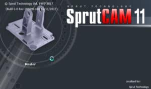

I personally use SprutCam, but there is a plethora of other CAM programs out there to choose from. The most important thing about CAM is the ability to find, build or have built a PostProcessor for your lathe. The Automate FL300-II that I use has a Siemens 808D Basic control on it which is a fairly popular control, especially in Europe. It’s also becoming a lot more prevalent here in the USA.
You want that customized Post Processor because while gcode is meant to be standard, it is anything but. Pretty much every control maker out there has customized gcode in some fashion, and the post processor needs to be able to post into the format your particular control understands.

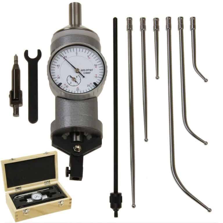

Drills are a little trickier, but I like using a Coaxial Centering Indicator. I mount the centering indicator in the chuck of the lathe, then I sweep the center of the holes where a collet would mount to hold a drill bit. I switch the X to 0.0001″ on the jog pendant, turn on the spindle very slow, like 100 rpms, and just jog X back and forth until the needle on the centering indicator doesn’t move anymore. When I measure the offset of the tool, I just select 0 for the measurement of X. Now the drill bits are right on center.
