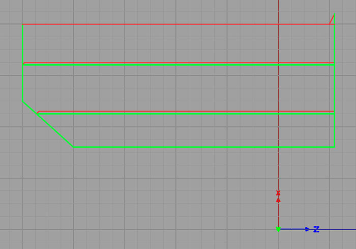

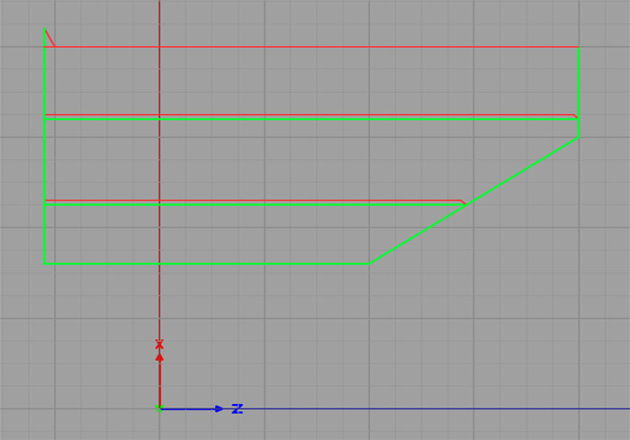

Now here is a simulated G71 command to rough turn that profile:
G71 Simulation
The simulated G71 makes 2 roughing passes and then cuts the profile…
And here is the code that was simulated:
% Top to bottom, right to left ( One line G71 ) G0 X4 Z1.0 (Start Position before commanding the cycle) G71 P1 Q4 D1.0 F2 U0.2 W0.1 N1 G0 X1.6 N2 G1 Z-4.0 N3 X2.5 Z-5.0 N4 G1 X4

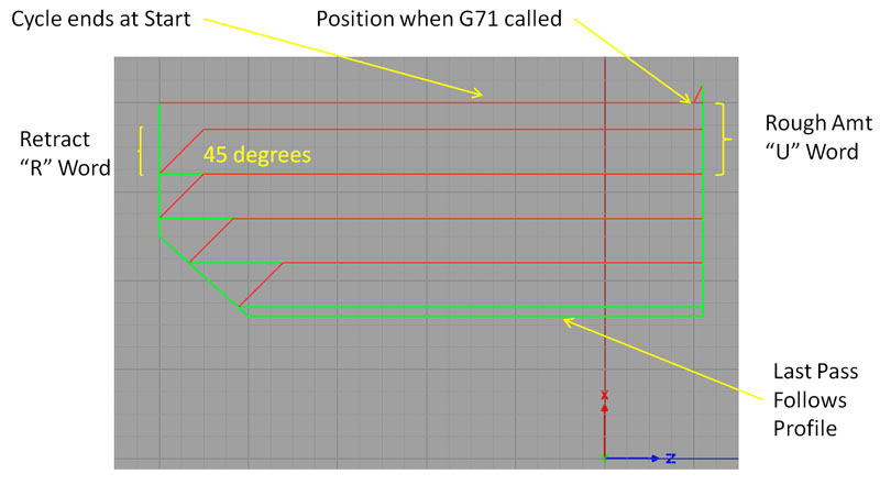

Anatomy of a Type I G71 Rough Turning Cycle
Anatomy of a G71 Rough Turning Cycle
The diagram shows how all the pieces fit together. From the starting point where the machine was before the G71 was called, it moves up and over by the finish allowance. It then starts to feed down by “U” each pass. The pass traverses until it gets to the profile, then it retracts on a 45 degree angle by the amount specified either by the “R” word (2 line G71) or a setting such as Setting 73. When it gets all the way back in Z, it begins to feed again. If the first line of the profile was a G00, the feed is a G00 until it gets to the depth of the last pass, and then it switches to G01 to finish going to depth.
It proceeds in this way making roughing passes until it is within less than the rough depth of the profile. Note that this is the profile shifted up and to the right by the finish amounts. When it is less than a rough depth away, it simply follows the profile all the way up, and then the final move from the end of that cut goes back to where we started from.
That’s all there is to it!

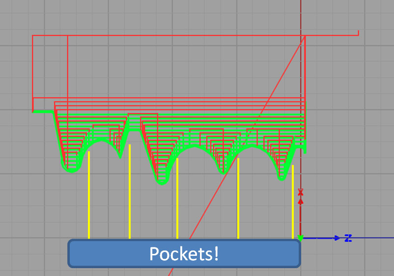

Type I Requires Monotonic Profiles: No Pockets
This page describes G71 “Type I”, but there is also a “Type II” which we’ll go over on our next page. There are some important differences between the two as you would expect. The biggest one is that Type I allows no “pockets”. Profiles that have no pockets are called “Monotonic”, a term you may have seen either in your controller documentation or perhaps as an alarm on your code if you’ve been playing with G71.
What’s a “Pocket” on a lathe?
Look at your profile, once past the first line that positions to the profile start. If you can follow the profile and never have it go deeper in the cut than that starting point, you have a monotonic profile that has no pockets. Put another way, and the reason it is called what it is, the profile is “monotonically increasing” (or decreasing depending on cut direction). It never changes direction in terms of the X axis.
Note that your profile needs to be monotonic in Z too. You can’t double back and create an undercut. G71 is still very useful as Type I (the only thing the first G71 capable controllers offered), but Type II is quite a bit more powerful. Here is a profile for a candlestick that would require a Type II G71 because it isn’t monotonic:
G71 Pockets Require Type II
Each downstroke marked in yellow creates a “pocket” that Type I G71 can’t do.

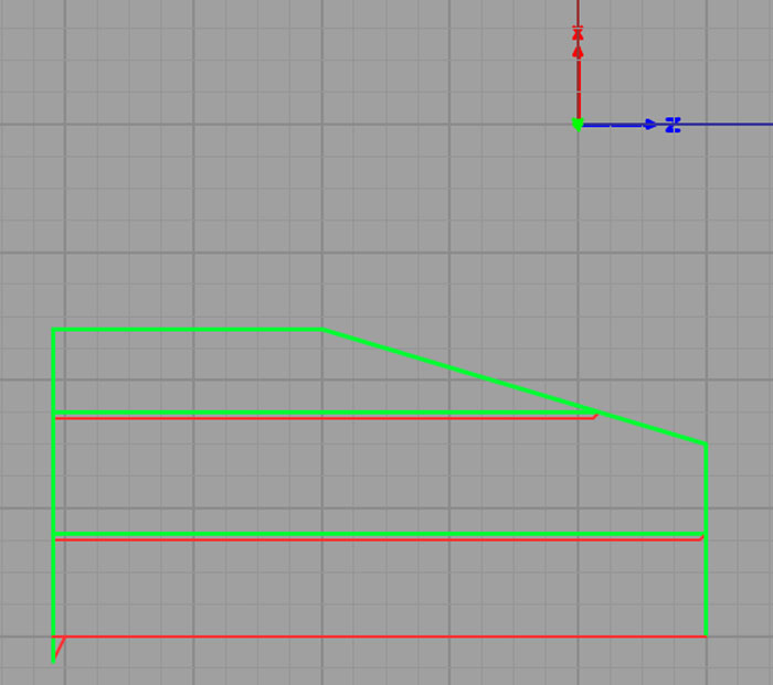

Top to Bottom, Left to Right: U+, W-
G71 U+, W-
One Line G71:
% Top to bottom, left to right G0 X4 Z-1.0 (Start Position before commanding the cycle) G71 P1 Q4 D1.0 F2 U0.2 W-0.1 N1 G0 X1.6 N2 G1 Z2.0 N3 X3 Z4 N4 G1 X4
Two Line G71:
% Top to bottom, left to right G0 X4 Z-1.0 (Start Position before commanding the cycle) G71 U1.0 R0.5 G71 P1 Q4 F2 U0.2 W-0.1 N1 G0 X1.6 N2 G1 Z2.0 N3 X3 Z4 N4 G1 X4

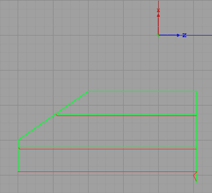

Right to Left, Bottom to Top: U-, W+
G71 U-, W+
One line:
% Bottom to top, right to left G0 X-4 Z1.0 (Start Position before commanding the cycle) G71 P1 Q4 D 1.0 F2 U-0.2 W0.1 N1 G0 X-1.6 N2 G1 Z-2.0 N3 X-3 Z-4 N4 G1 X-3.9
Two line:
% Bottom to top, right to left G0 X-4 Z1.0 (Start Position before commanding the cycle) G71 U1.0 R0.5 G71 P1 Q4 F2 U-0.2 W0.1 N1 G0 X-1.6 N2 G1 Z-2.0 N3 X-3 Z-4 N4 G1 X-3.9

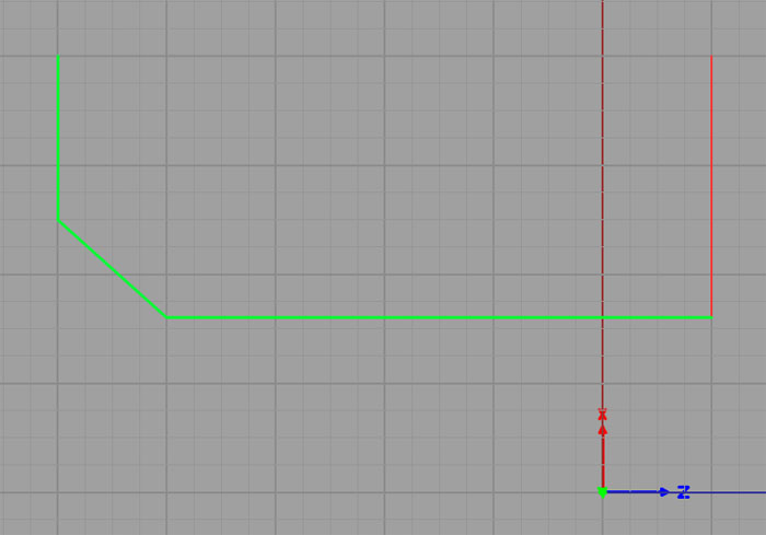

Left to Right, Bottom to Top: U-, W-
G71 U-, W-
One line:
% Bottom to top, left to right G0 X-4 Z-4.0 (Start Position before commanding the cycle) G71 P1 Q4 D1.0 F2 U-0.2 W-0.1 N1 G0 X-1.6 N2 G1 Z-2 N3 Z1 X-2.5 N4 X-4
Two line:
% Bottom to top, left to right G0 X-4 Z-4.0 (Start Position before commanding the cycle) G71 U1.0 R0.5 G71 P1 Q4 F2 U-0.2 W-0.1 N1 G0 X-1.6 N2 G1 Z-2 N3 Z1 X-2.5 N4 X-4
