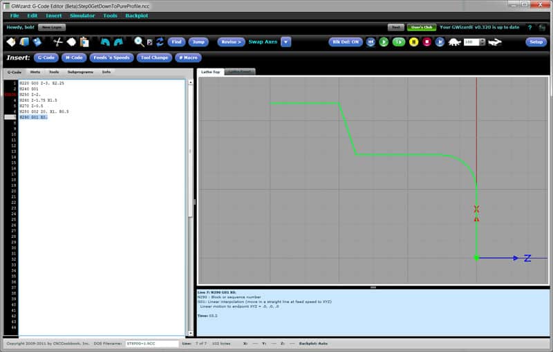

Step 5: Swap X to Z and Z to X
Here goes our last trick to finish the profile: we need to swap all the X’s to be Z’s and all the Z’s to be X’s. To do this, you’ll either need to be really careful, or you need an editor with a command that can make that swap in one shot. If you do it in two passes, say with search and replace, you’ll replace X’s with Z’s, but then you can’t tell which Z’s to change to X’s since some were legit Z’s and some used to be X’s. G-Wizard Editor has a “Swap Axes” command that makes this sort of thing easy:
Swap Axes makes short work of changing the X’s to Z’s and the Z’s to X’s without getting confused…
Here’s the result:
Our familiar profile made the journey from Mill CAM to suitability for a lathe cycle!
That’s all there is to it. Here’s the g-code:

What About Diameter Mode?
One final thought. A lot of lathes will be set up for g-code that runs in diameter mode, where increments on the X axis are measured as diameter changes not radius changes. Your mill knows nothing of this kind of thinking, so the code coming out of it is radius mode code. You will have gotten this far and then you’ll want your profile g-code to be Diameter mode. No worries, GWE has a Revision command that can make that change for you too:
Lathe diameter mode is simple: multiply all the X’s by 2…
As you can see, it ain’t rocket science–we use the Adjust Addresses Revision to multiply all the X’s by 2.
