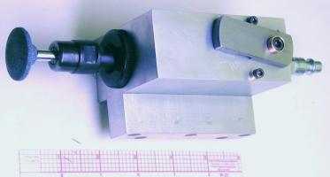

This is a very slick example using an air grinder and QCTP adapter…

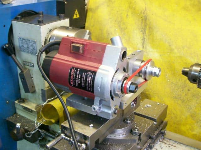

Router-based TP Grinder: A Bit Heavier Duty!
Router-based TP Grinder Again…

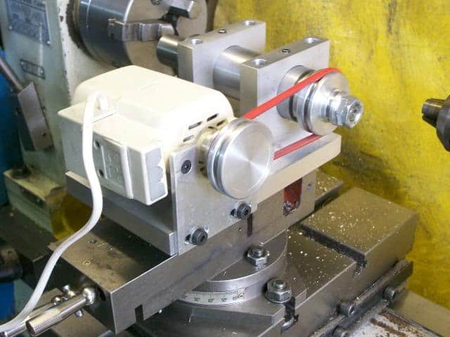

Sewing Machine Motor TP Grinder…

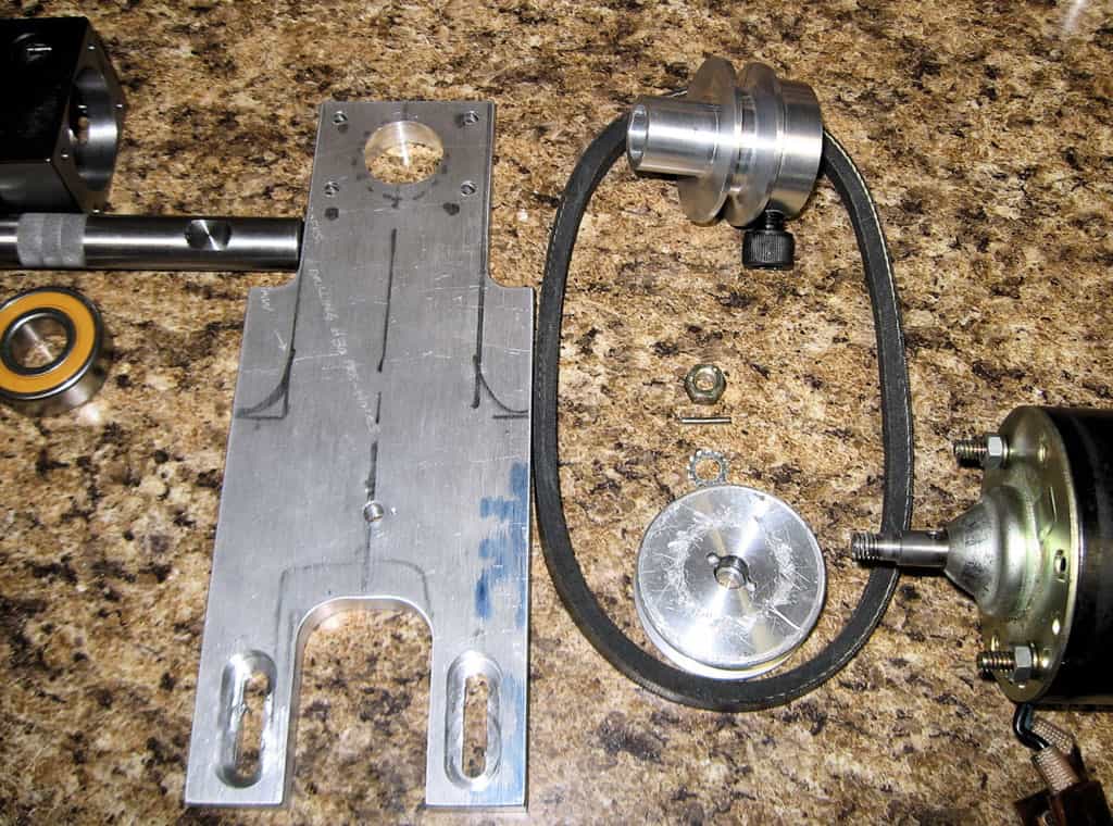

Spindle parts. Note the knurling on the shaft–original cut too small. Knurling raised it to fit the bearing better!
Drive components.
Electric motor is an RC Plane starter. It proved marginal according to the builder…

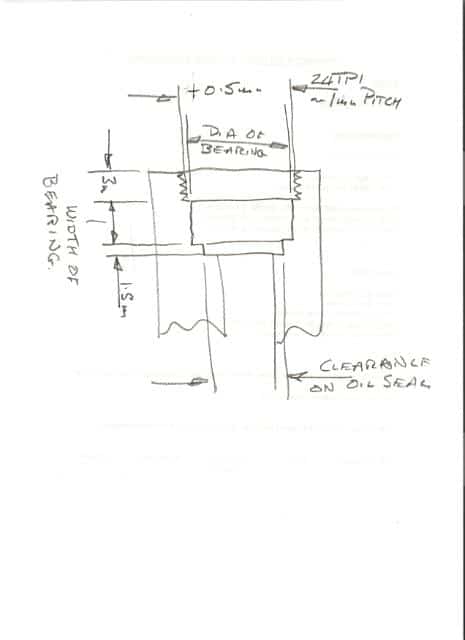

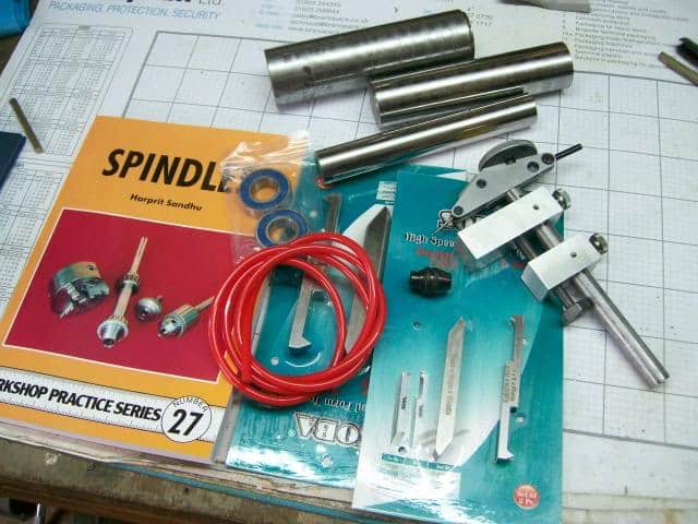

Nice Cartridge Spindle Project from Mad Modder

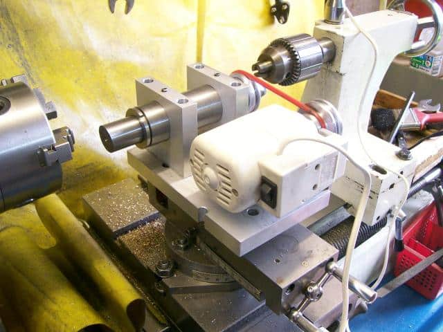

And the TP Grinder that goes with that spindle is here.

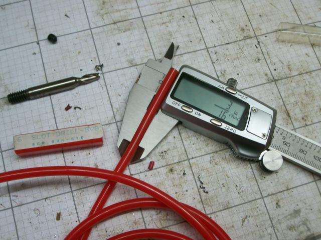

3/16″ Redthane Belting…

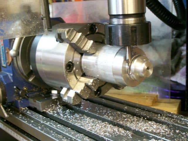

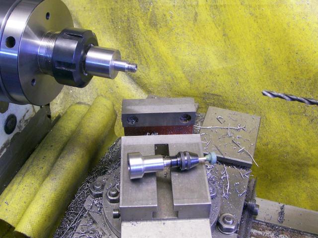

Pulley made with a 3/16″ endmill and a 4th axis/indexer…

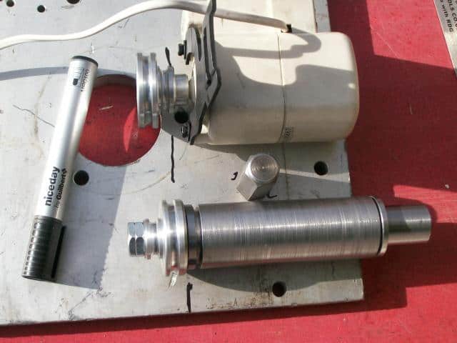

Cartridge spindle and sewing machine motor…

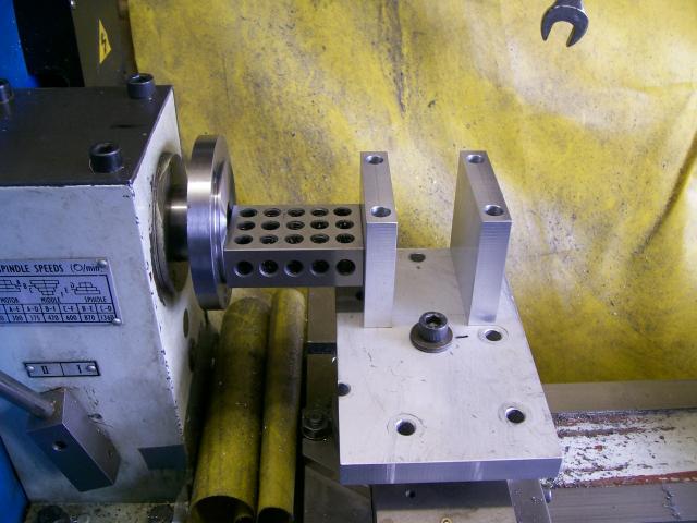

Squaring up to the backplate…

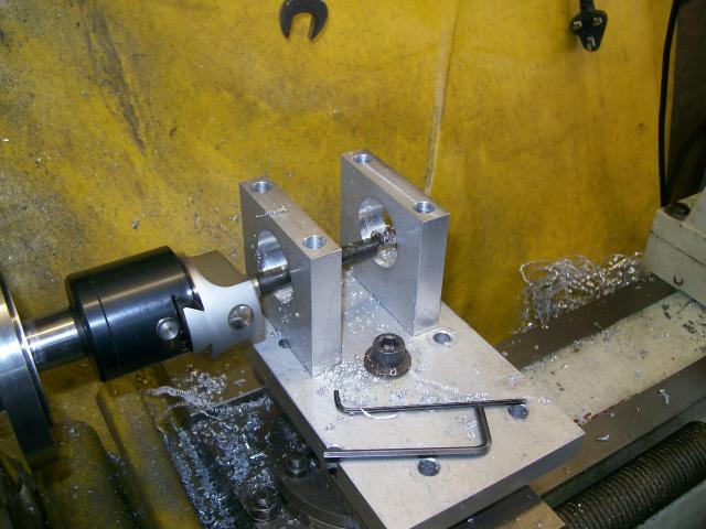

Pilot…

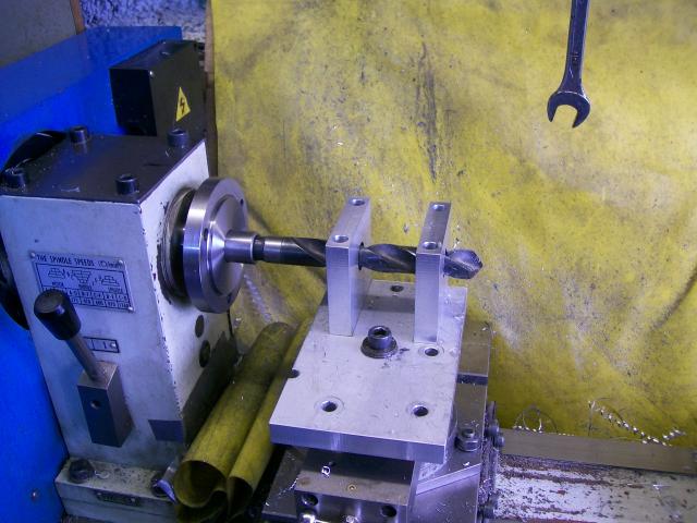

Line boring the spindle holder plates. Nice way to do it on a lathe!
Upgraded to a more powerful router motor!

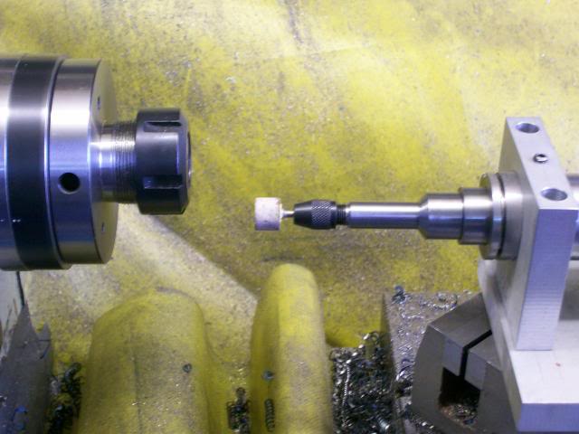

Adapter to mount Dremel wheels…
Now remade to use a pin chuck–much more accurate than the Dremel chuck!
