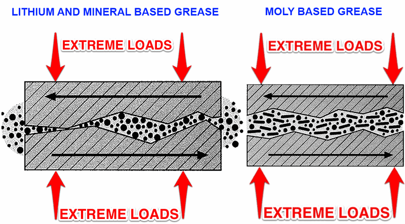

What lubrication should be used?
No matter how smooth metal surfaces may appear, they all have microscopic peaks and valleys. These can allow areas of the surface to break through the lubricating film; creating metal-on metal contact. Not ideal when you consider that wedge-style chucks can have as much as eight tons of friction being applied to the wedge, master jaws and body.
In order to avoid this metal-on-metal contact, it is advisable to use a denum-disulfide-based (moly) lubricant with 20 – 25% moly. This type of lubricant is superior to the lithium and mineral-based greases which are commonly found on the market. Moly serves to provide a barrier between the surfaces, protecting them even under heavy loads. So don’t let anyone tell you that it is okay to use any old grease – if you want to keep your chuck working properly and extend its lifespan, use the proper lubricant.
