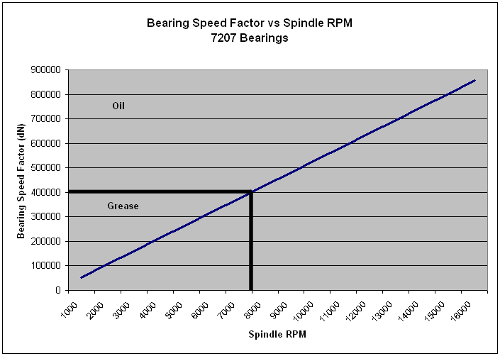

You want Kluber Isoflex NBU 15. It ain’t cheap–about $30 with shipping for a 50G tube–so what makes its so magical? This diagram will serve to illustrate:
Bearing Speed Factor for 7207 AC Bearings Showing Grease vs Oil Lubrication Regimes
Those “dN” numbers are called “bearing speed factors.” They basically tell us how well the lubrication is working on the bearing, and hence how many rpm it can turn. That diagram shows the normal regime for grease versus a need to go to an oil mist system. Most recent VMC’s are using oil mist, BTW. Anyway, the magic of Kluber Isoflex NBU 15 is that it has a BSF of 850,000 dN rather than the normal 400,000 dN found with most greases.
That 7207 is the bearing size my IH mill takes for its spindle. With ordinary grease, the absolute redline would be 8K rpm and realistically I should probably hold it to 6,000 to 6,500 or so. It’s no wonder this is the speed range for Bridgeport mills and the like too. However, with the magic Kluber grease, much higher speeds become practical. 8,000 or even 10000 is doable. Since dynamically balanced tooling is recommended at 10,000 or up, I doubt I’ll be running there, but 8,000 rpm would be sweet. A whole raft of the earlier CNC mills, like the Tree Journeyman series, as well as more recent VMC’s took 8,000 rpm as their target speed and its a good one for aluminum work.
