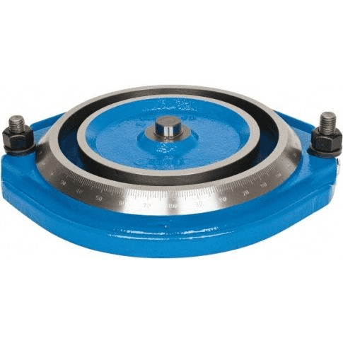

What about the Swivel Base?
Some machinist vises, particularly older ones, come with a swivel base:
Circular measuring device with central post and calibrated edge.
The idea is the swivel base makes it easier to set the vise jaws to a particular angle.
In practice, you seldom see a machinist use the swivel base and they've become an extra-cost option on most new machinist's vises.

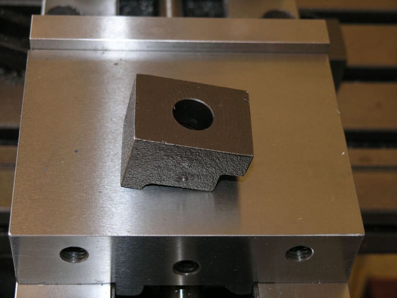

Mount a Machinist Vise to Your Milling Machine's Table
Machinist Vises are typically clamped down to the mill table.

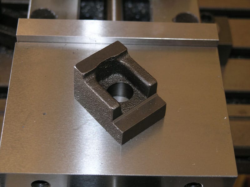

I had been using step clamps that came with my table clamping kit up until I got my Glacern 6" Premium Vise:
Metallic object with dark surface and small hole or indentation.
Old Style...
The new vise came with It came with a nice clamping kit that I like a lot better:
Metal part with central hole and parallel grooves.
New Hotness...
The new clamps are simpler and more compact. For example, when I run two vises with my Jaws of Doom between them, it gets hard to swing a wrench in there. It also helps that I switched to a couple of Socket Head Cap Screws to use for these clamps.

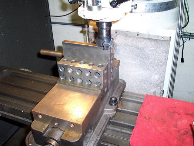

Metalworking machine tool, plate squaring device with rectangular base and holes/slots.
Increasing rigidity is always important. For this operation, two 2-4-6 blocks are used as a vise jaw extension to help support the plate on end better…

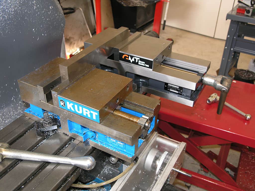

Using Multiple Vises, Jaws that Span Vises, and Grinding Matching Vises

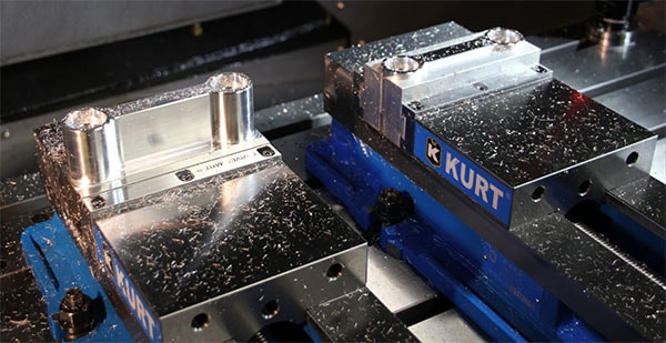

There’s an old saying that if you want to make full use of your machine you need to use every square inch on the table. Most machine tables can accommodate multiple vises, and it is very common to install multiple vises on a mill table.
Our photo above of side by side vises shows one such setup. It’s not uncommon to see four or even six machinist vises on a larger milling machine. The more the merrier so long as travels will accommodate it because the more machinist vises you have, the more parts you can machine before the machining has to stop so the operator can load new workpieces.
When you have multiple vises on a machine, it is convenient if they match in all the key dimensions to within a decent tolerance. That way if you are duplicating a setup and get the vises in a different order, all will be well. Most vise manufacturers will match machinist vises for you or it’s a fairly simple operation with a surface grinder to match a pair of vises.

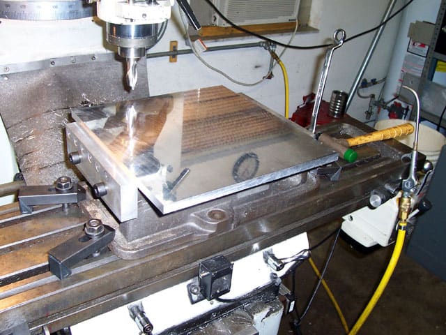

I made that set of “Jaws of Doom” for a project that required machining a thin aluminum panel for some electronics and they worked out great.

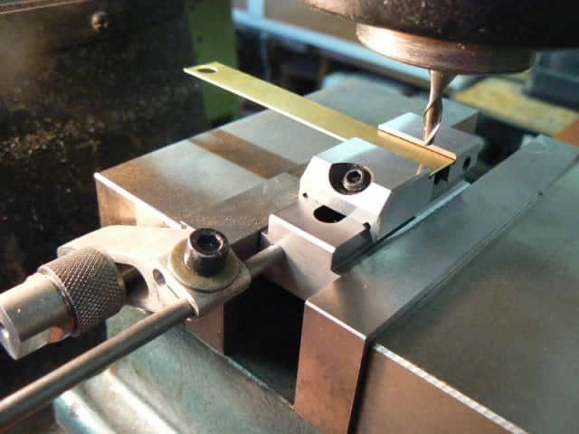

Metalworking vise with sine bar attached to milling machine.
Use a sine vise to hold a part at 90 degrees from where the milling vise jaws run…
BTW, sine vises are also called Toolmaker’s Vises or Grinding Vises.

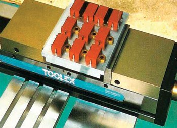

You can also create small plate fixtures that are designed to sit in a machinist vise, creating what is often called a “vise pallet” since the individual plate fixtures can be swapped out of the vises much like pallets.  This vise pallet uses a bunch of Mitee Bite Toe Clamps to achieve a very high part density:
Metal tool with "TOOL" label and rectangular shape, featuring multiple small holes on a flat top surface in a workshop background.
Vise Pallets are just small plate fixtures designed to be held in the jaws of a milling vise…
In general, solutions like Vise Pallets are created to enable vises to be left on the machine in shops where the flexibility and simplicity of vise workholding is ideal for most of their jobs.

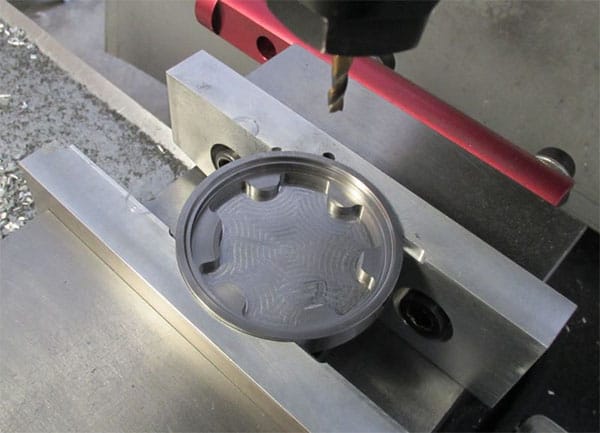

Soft Jaws on milling vises are a very popular form of workholding. The idea is to create aluminum vise jaws (since aluminum is softer than ferrous materials that’s where the name comes from) that are customized for particular jobs. Sometimes a more durable material is advantageous, in which case we have Hard Jaws.
Here are some examples:
A large round soft jaw mold being machined on a CNC machine.
Use soft jaws to locate and hold a larger round part. A “V” is often seen, but it won’t support the part as well as the soft jaws.

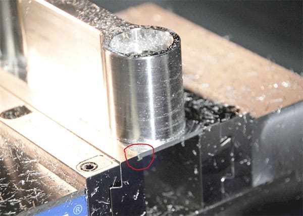

As mentioned above, we don’t want to grip the whole height of the part in the jaws. A particularly thin grip can be had with dovetail jaws. The little red circle points to the dovetail which locks the workpiece in from slipping upward under heavy machining. These are Carvesmart quick change jaws.

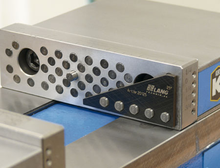

Silver metal device with holes and an angled black attachment.
Lang Innovations makes these neat jaws that make it easy to set the workpiece in the vise at a precise angle when needed. The pins can be individually pushed in to create angles and other holding patterns too…
These are but a few examples. When using Custom Jaws, your imagination is the only limit. Well almost, table size will play a role as will the number and type of vises you have available.

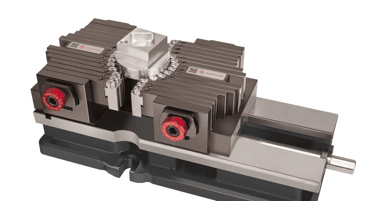

The Ultimate Universal Soft Jaws: Adaptix
Mechanical device featuring two long rectangular components connected by a silver metal piece.
The Adaptix Soft Jaw system has movable fingers that make it a universal soft jaw.  They will grip almost anything simply by setting the fingers to hold whatever shape is needed.

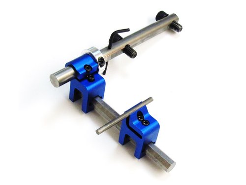

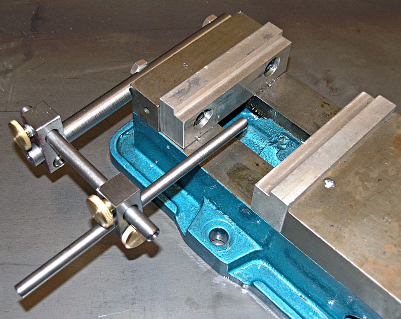

Use a Vise Stop for Repeatable Positioning

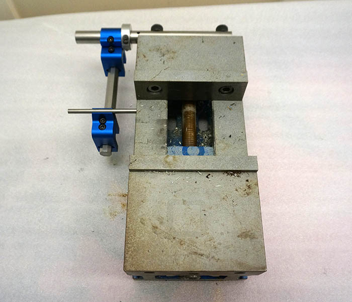

Here's a Kurt Vise Stop I made in an afternoon for my milling vise:
Metal vise with adjustable jaws and blue and silver components.You can tell at a glance that once you set a part in the jaws and slide it up against the vise stop, you've got a repeatable position.  Every part will be located in exactly the same place.
This can be a real time saver when making multiple parts.

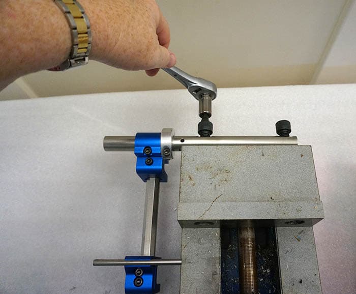

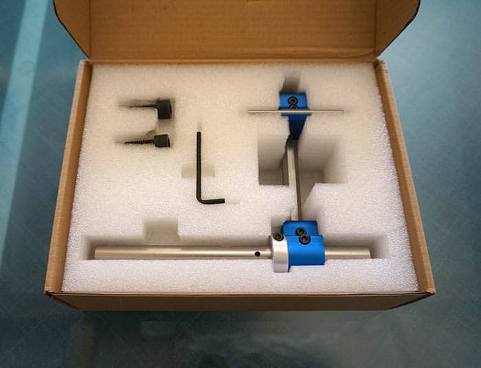

Installation is Easy
Cardboard box with tool set and blue/white vise/clamp inside.
Open the Box…
Hand holding a silver wrench in a vise with blue grips, set against an out-of-focus workshop backdrop.
Bolt it on to the vise’s rear jaw mounting holes…
Metalworking vise with blue clamp.
Rock your work stop.  It’s a bit shiny for my groady old Kurt 6″ vise, LOL!

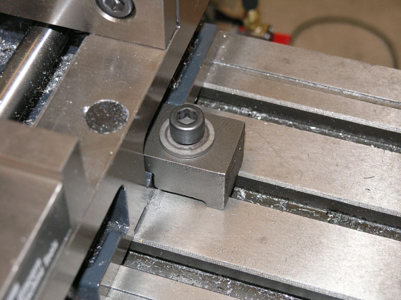

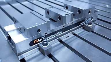

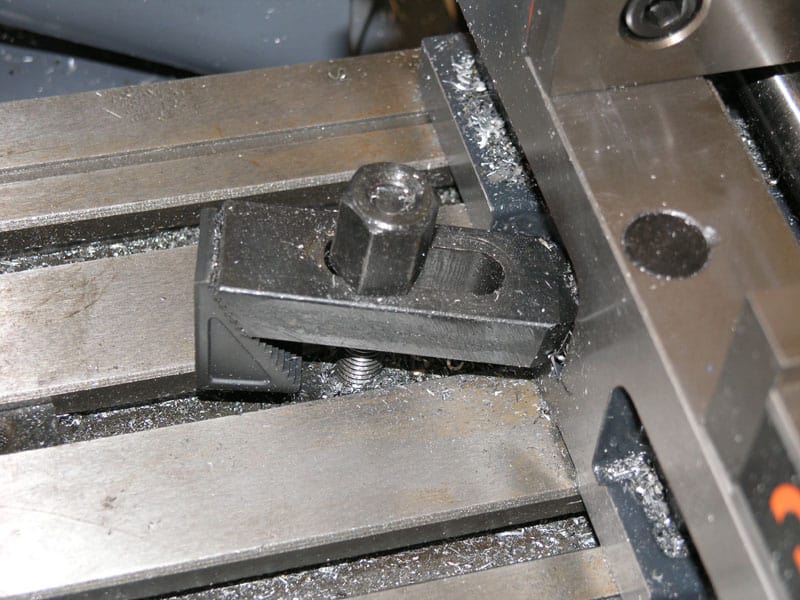

Better Vise Mounting Clamps
I had been using the normal clamps that came with my table clamping kit up until I got my new Glacern 6" Premium Vise. It came with a nice clamping kit that I like a lot better:
Dark gray metalworking vise attached to an industrial metal working table.
Old Style...
Metal machine component with silver metal piece and screw/bolt centered among surrounding metal parts.
New Hotness...
Square metal object with a central hole on top of a metal surface.
Machining tool with central hole.
I need to make up a couple of sets from some steel to use with my other vises. Incidentally, the Glacern vise has been superb!

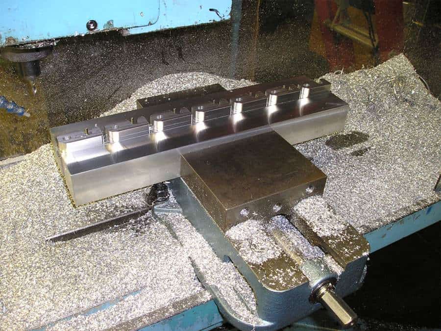

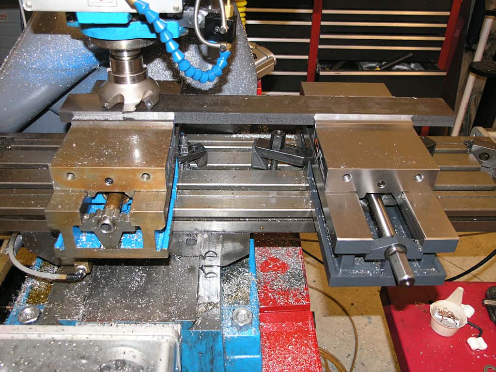

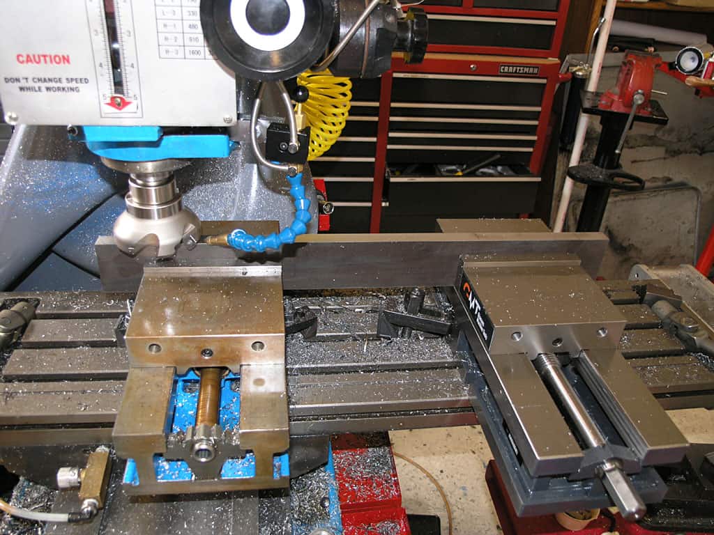

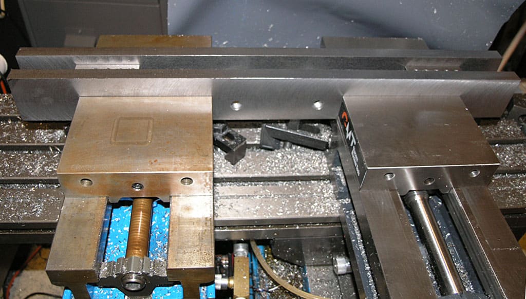

Vise Jaws of "Doom"
I got started on this project after trying to do some engraving of a plate for a CNC enclosure. I was engraving 1/4" aluminum plate and the ends were just not being supported well enough by my 6" vise. Since I happened to have a second vise, I decided to make a set of Vise Jaws of "Doom" that could span both vises and provide ample support. A brief hunt on eBay yielded some very nice 4130 steel that I decided to make the jaws out of. I figure they'll be around for quite a while, so may as well do them up real nice.
To answer an obvious question, "How do they work in practice?" I was worried that the two vises would fight each other, but in fact, you can feel very close when they are in alignment and it's very easy to spin both handles at a close enough rate.
Large metal vise on workbench in a machine shop.
The finished Jaws of "Doom" are 24" long and span 2 6" vises to make one "Super-Vise"...
Milling machine in operation with cutting tool and various equipment.
I squared up my block of 4130 right up front...
Milling machine in workshop or factory setting with blue and red base.
The face mill is a Glacern 45 degree 3" with inserts intended for steel. It cut very nicely!

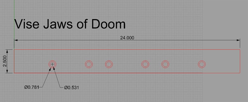

Here is the plan I drew in Rhino3D:
Technical drawing of Vise Jaws of Doom with red details on a gray grid.
The mounting holes are 3.875" apart. I have 3 sets of holes so I can either stick the jaws across 2 vises with the end sets, or put them on one vise with the middle set...

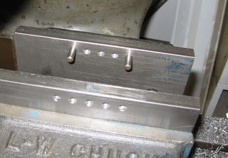

After cogitating on the idea of putting dowel pins in vise jaws (of which more below on how a fellow did that for another purpose), I did a Rhino drawing to figure out the placement of pins needed to provide a set of angle stops in 5 degree increments from 5 to 45 degrees:
Technical illustration of red vise jaws with circular holes and black lines on a grey background.
This would be a dead simple thing to do with CNC, but I went ahead and listed DRO coordinates for those who want to play with it on a manual mill. A rotary table would let you do the work very easily as well. The idea is to drill and ream holes for 1/8" precision dowel pins. As you can see these holes are divided between a 2" and a 2.5" radius so they don't land too close together. One could either make a little bar with two pins to use as a stop to align the workpiece at the desired angle, or just use two dowel pins in the appropriate holes. I would bore the opposing jaw with holes slightly oversized so the dowel pin ends go in when tightening the vise on thinner workpieces.
I got the idea to use dowel pins from Jim Sehr whom I mention below for this set of jaws:
Metal workpiece with rectangular shape and three evenly spaced holes along its top edge, on a metal surface.

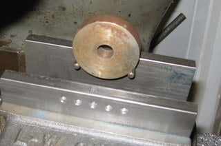

Nifty Soft Jaw Tricks
Soft jaws for your Kurt vise are fantastically useful gizmos and easy to make. But there are a few clever things I saw recently while prowling the web:
Silver metal part with small lip/tab.
Use slots instead of holes and the soft jaws are quick release...

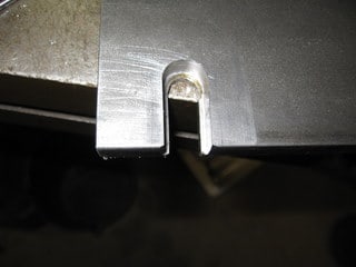

A series of holes for precision dowel pins and you get:
Metal workpiece held in place by soft jaw pin.
An easy way to hold round parts for drilling. Normally I would make do with a V-block in the vise...

Mill a Strip of Parts in a Vise
So you want to make a bunch of small parts at once in one setup, and using one vise. Make a strip of parts in a set of big soft jaws:
Large metal part with cylindrical protrusions on workbench in industrial setting.
The parts keep a strip underneath. To finish, flip the whole thing, drop it into softjaws of appropriate “negative image” of the parts, and mill of the back.
An alternative would be to make a tooling plate that goes in the vise and acts as a pallet. Use Mitee-Bite clamps or the equivalent to hold the parts. Make at least two plates so you can load one while the machine is working on the other.
If you start getting some chatter, the backing is probably too thin, or your jaws are holding it well enough. You call also try some big “Jaws of Doom” like I made up for 2 vises (see above).
